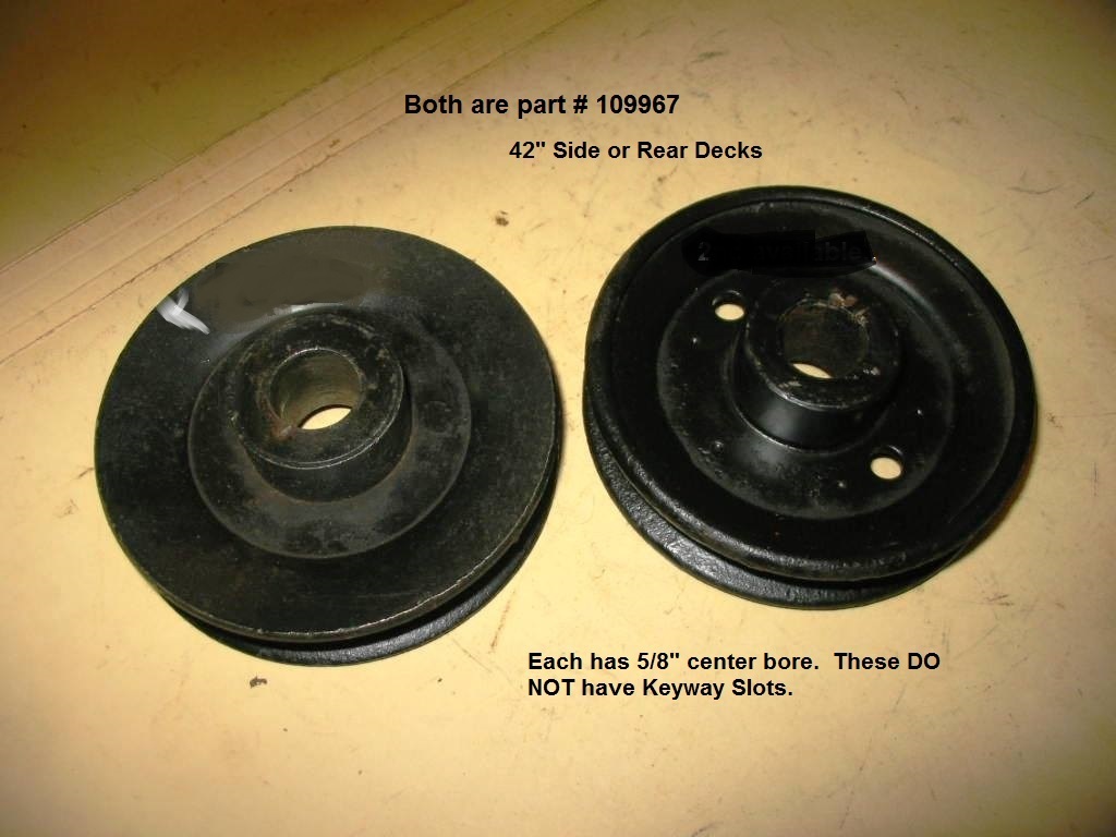

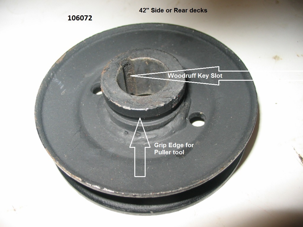

daveoman1966 3,884 #3 Posted February 23, 2017 (edited) If your TOP PULLEY (109967) does NOT have a WOODRUFF key to hold it on the shaft....remove the grease zerk on, top and then back off the nut 3 or 4 turns. Then using a brass drift pin, WHACK on the spindle shaft to drive it DOWN thru the housing. The other 42" pulley (106072) that DOES have a WOODRUFF keyway to secure the pulley to the shaft. For this type. remove the grease zerk and the top nut completely. Usually the pulley will wiggle loose but, if it doesn't, use an automotive POWER STEERING PUMP PULLEY removal tool to grip the lip at the top edge of the pulley. you can rent this tool...FOR FREE....at Zutozone. I ahve both types of replacement pulley and complete housing.... if needed. email me to: daveoman@windstream.net Edited February 24, 2017 by daveoman1966 2 Share this post Link to post Share on other sites
oldlineman 1,809 #4 Posted February 23, 2017 (edited) Thats how I do them, trick is to leave the nut on but loose and use a brass hammer or drift like dave said. Helps if you put a can like a coffee can open side up under the spindle, helps stiffen and back up the deck. You can also use some PB blaster. Edited February 23, 2017 by oldlineman 1 Share this post Link to post Share on other sites
