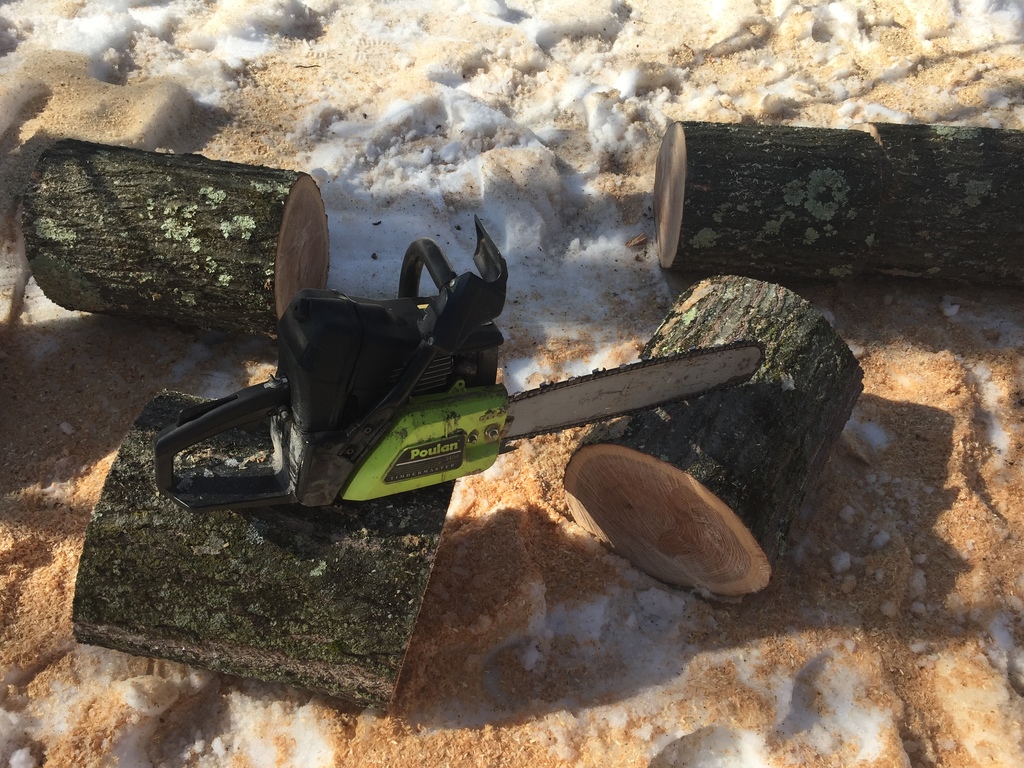

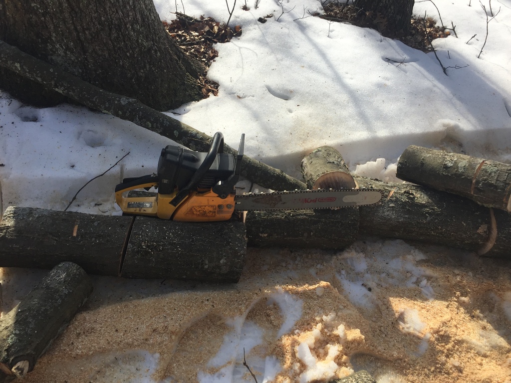

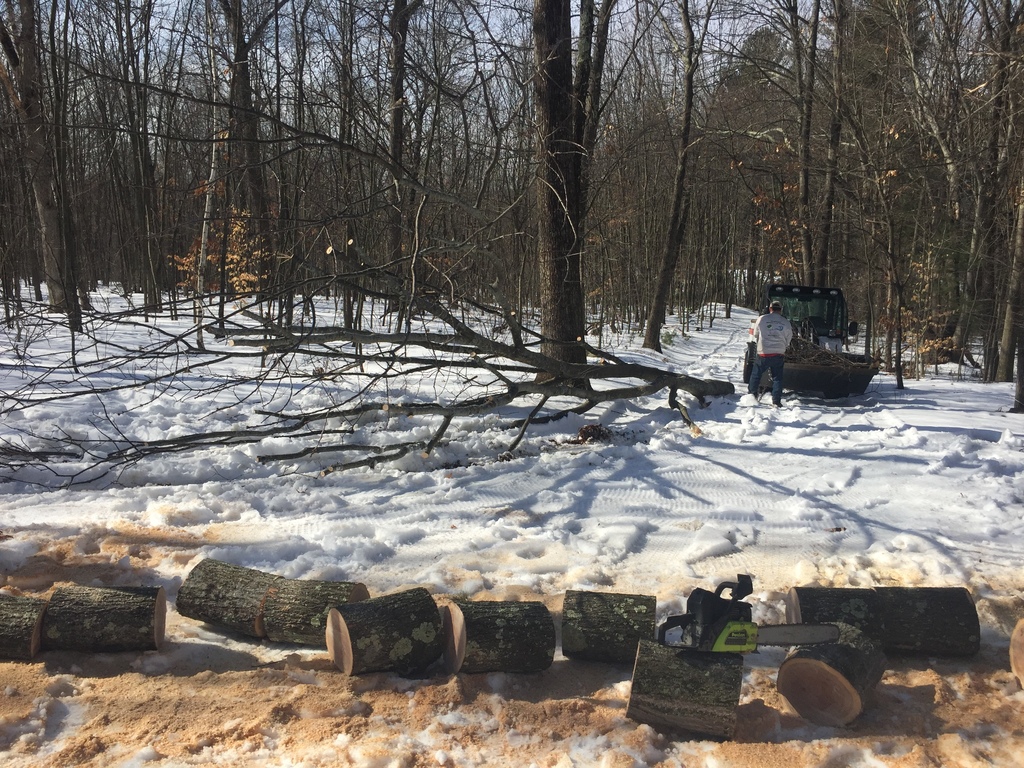

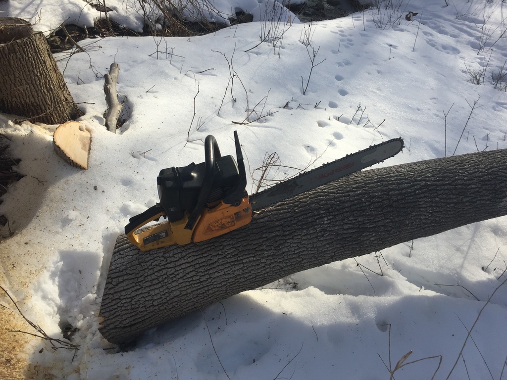

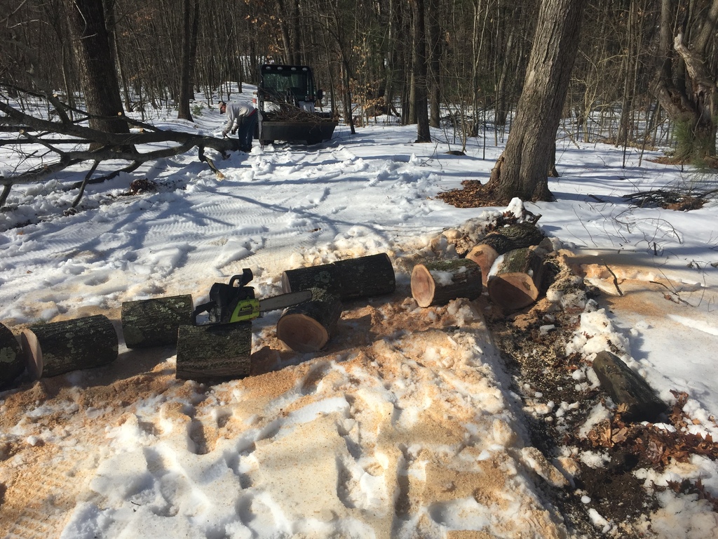

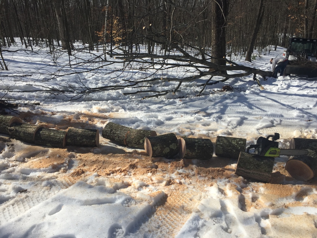

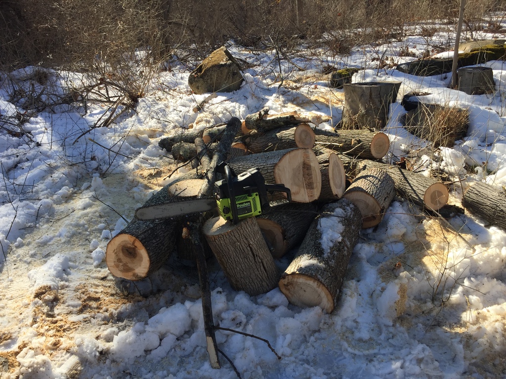

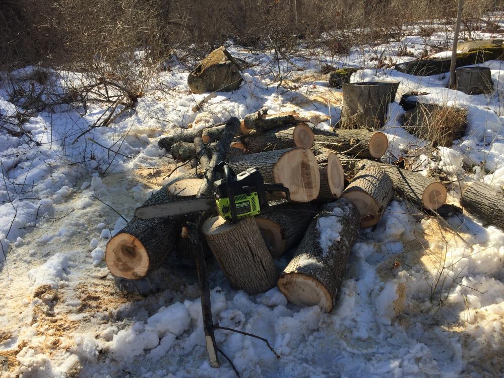

Red144runner 659 #1 Posted February 23, 2017 Before I began my horse hobby I rebuilt chainsaws. Poulans, homelites, mccolluch, Dolmar, jonsereds, pioneer, husqvarna and Stihl. I started with the older USA saws, cause they were cheap to buy and easy to work on. At my peak I had probably 50 saws, I'm at half that now. I've sold 300 or so over 10 years. I also burn wood. Luckily I work grounds at a private highschool on 150 acres of wooded area. So here's what I did today. First I dropped a leaning oak, 40' got hung up and pulled it with our bob cat tool cat. Next was an ash 30', easy drop nice wood ready to burn. Used my 3450 poulan (60cc 16"x3/8") and my super pro 380 same saw as above just yellow that saw has a 20" bar. These saws are pro saws and are a joy to run. Mill be posting more pics of tree work and saw projects 8 Share this post Link to post Share on other sites

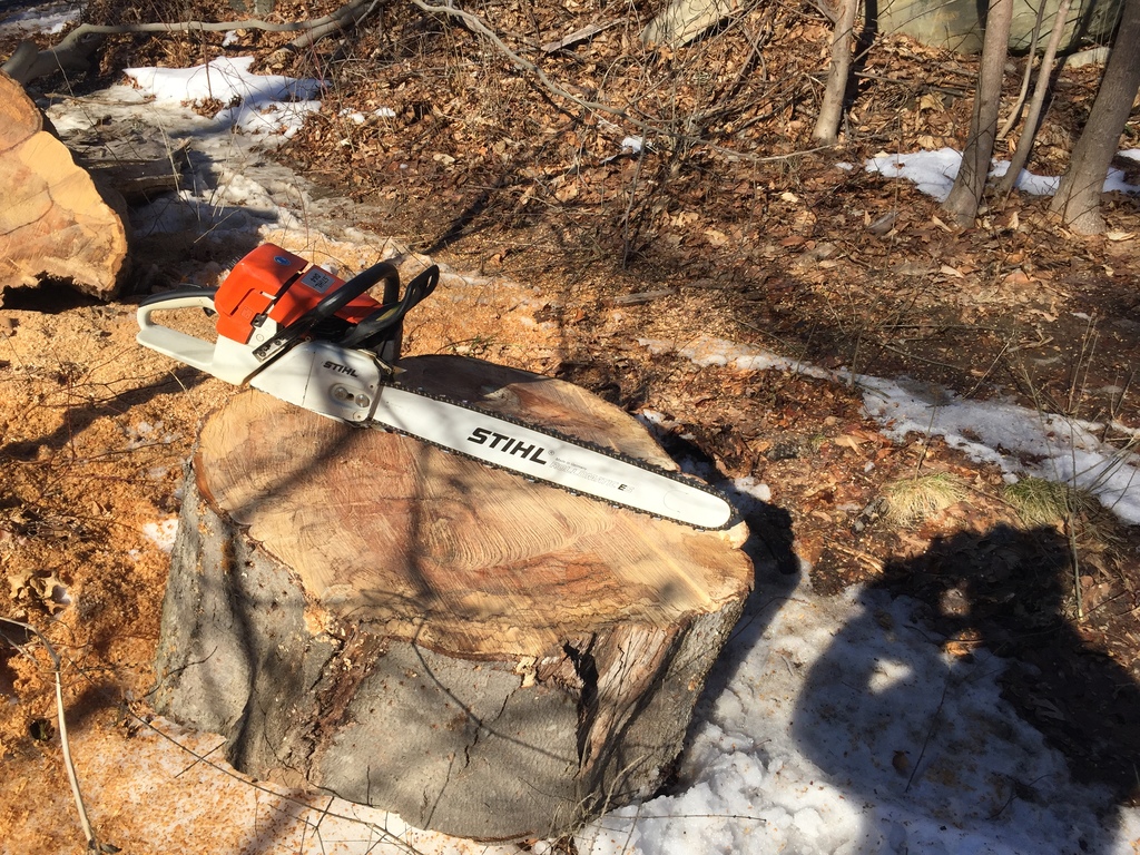

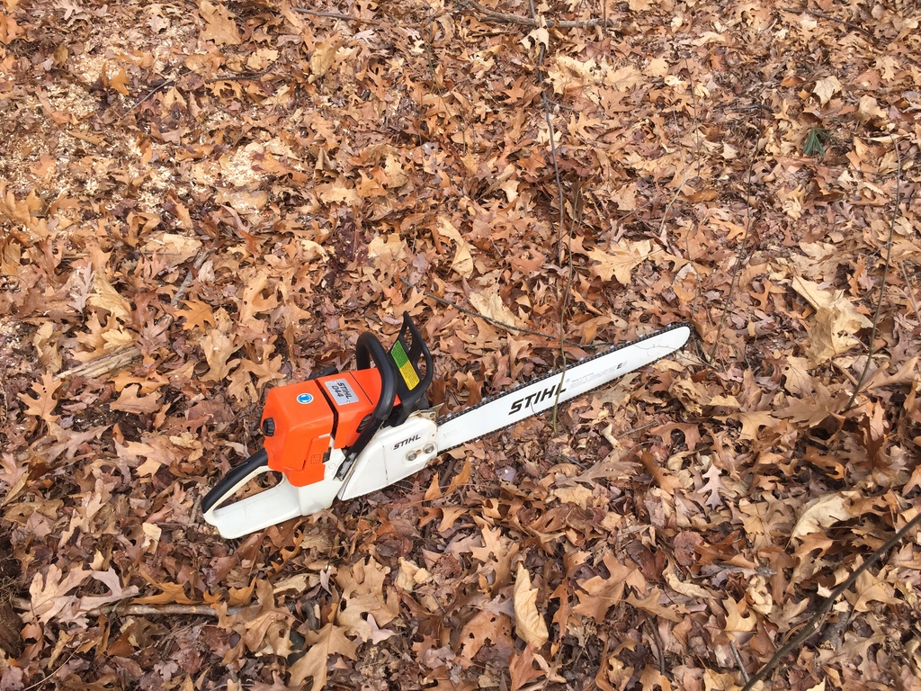

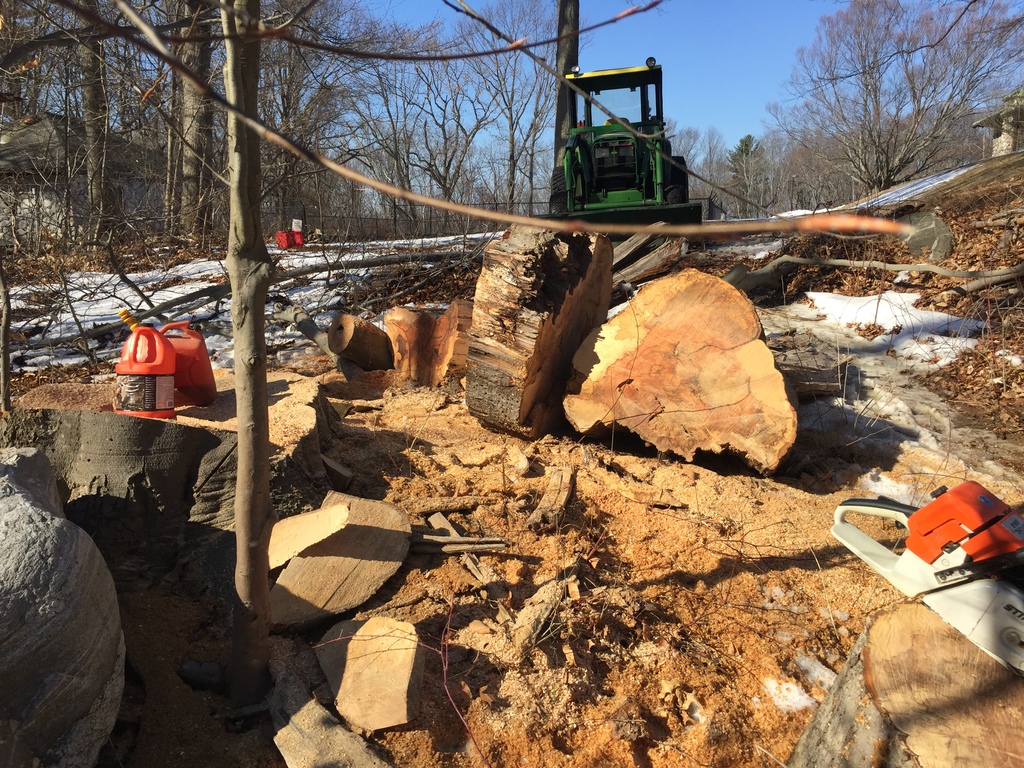

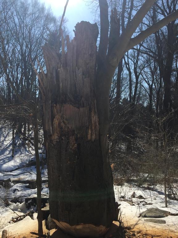

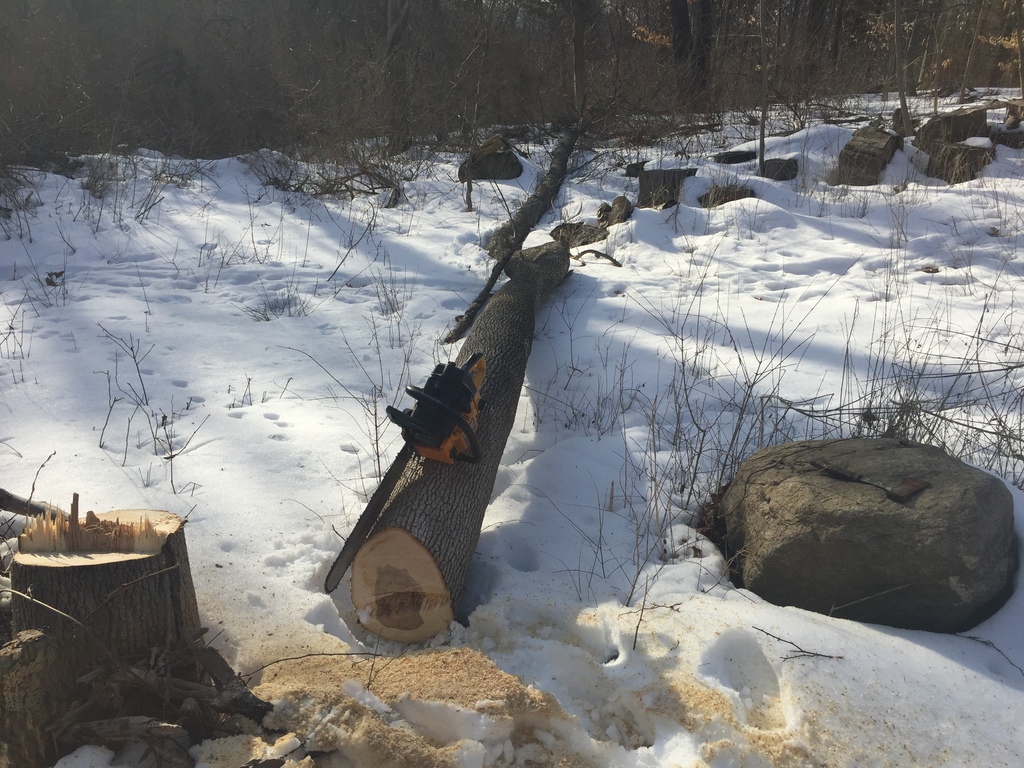

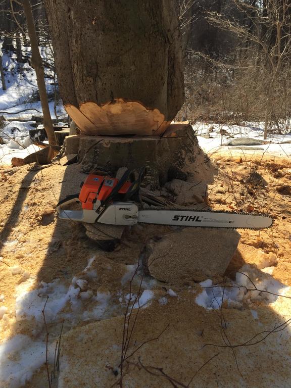

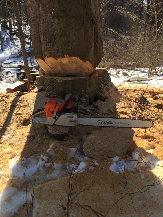

Red144runner 659 #6 Posted February 24, 2017 3 hours ago, obone said: Nice job. I tried something like that before, but cutting it up on the ground was hard. Kept getting the blade stuck. Always wonder what kind of tricks people used and how they cut through pieces larger then there blade. They have a few different tools, a plastic felling wedge is a tool I don't cut without. Look like a splitting wedge, as you cut one you get 1/3rd through drop the wedge in your cut, as the tree compresses the wedge holds the gap preventing the bar from being pinched. A peavey or canthook is used to roll the log so you can cut without the chain hitting dirt. I'll post some pics at some point Here's yesterday's job. Had a huge beech that broke off 10' up. Cut all that last year, yesterday I wanted to finish the job. I had a 25" bar on my Stihl 460 magnum, first run since a rebuild and no oil pressure. Swapped bar on to my 044 and an hour later I had it down. That tree was 3' at the butt so I had to make a three wedge cuts then a back cut, that was tricky due to the boulder resting on the back of the tree. A few tugs with the choker cable and chains hooked up to our tractor and it's down. I cut some of the smaller limbs off with my 3450 Poulan, that saw runs awesome. We might make some table tops from one of the rounds, the grain is so nice 2 Share this post Link to post Share on other sites

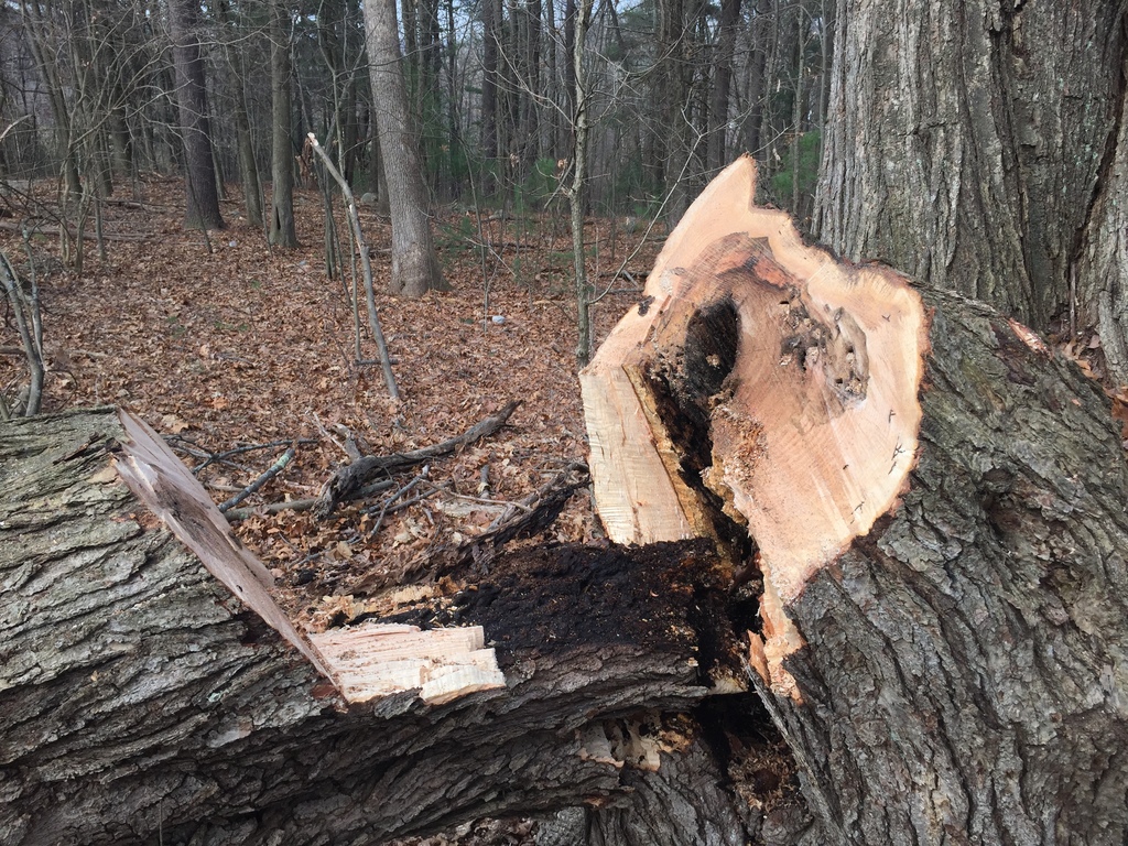

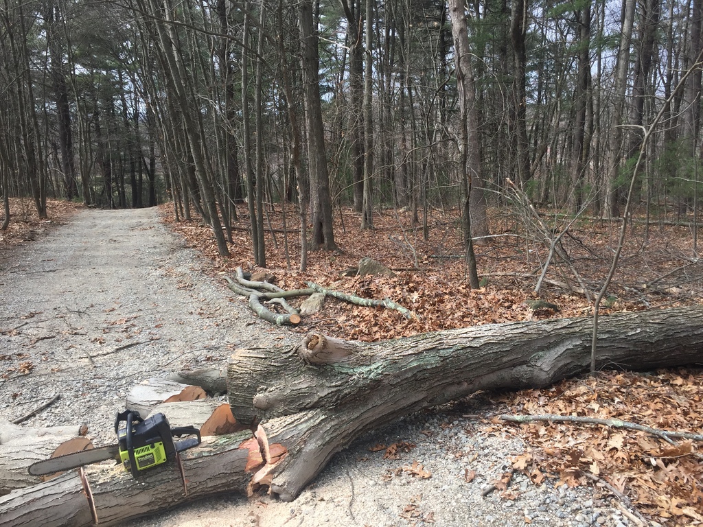

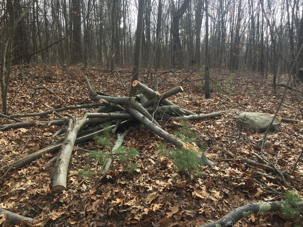

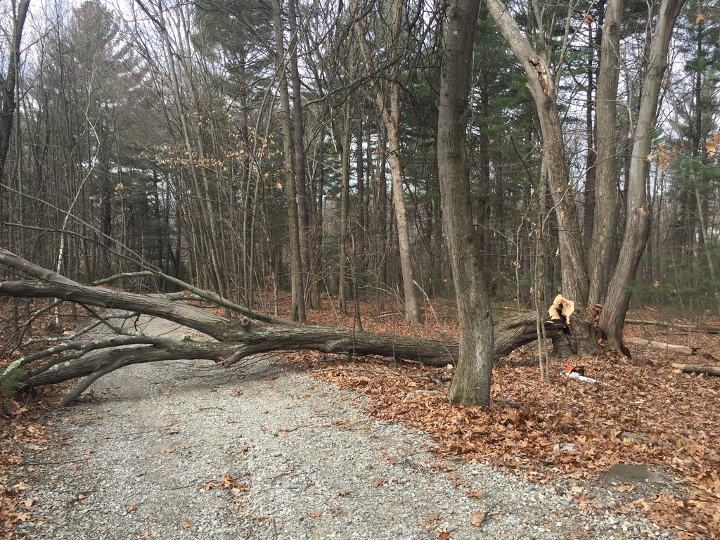

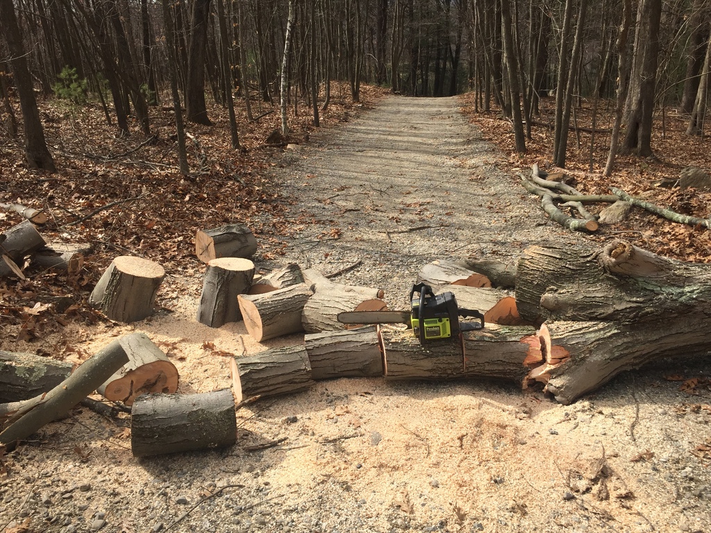

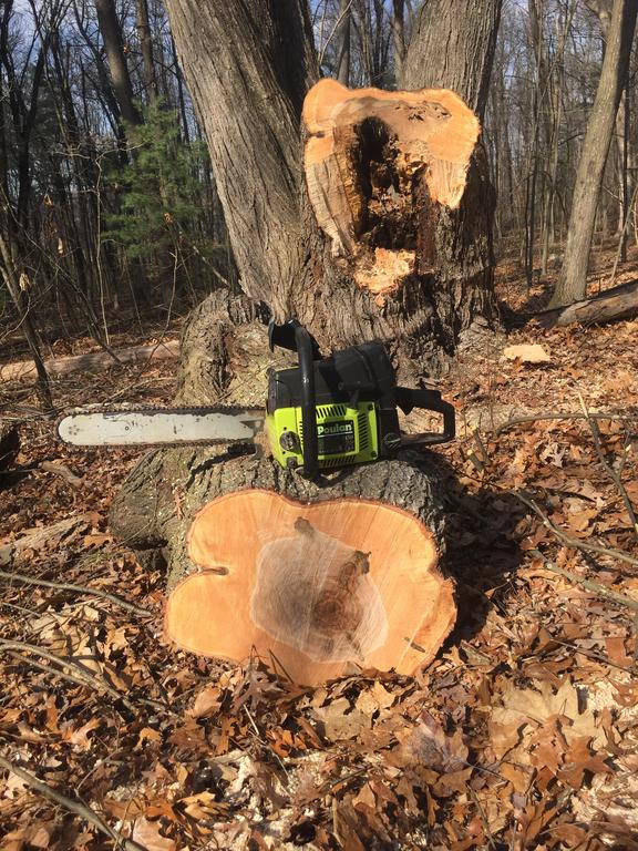

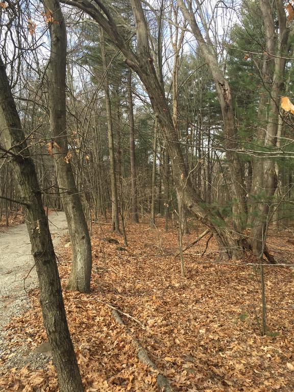

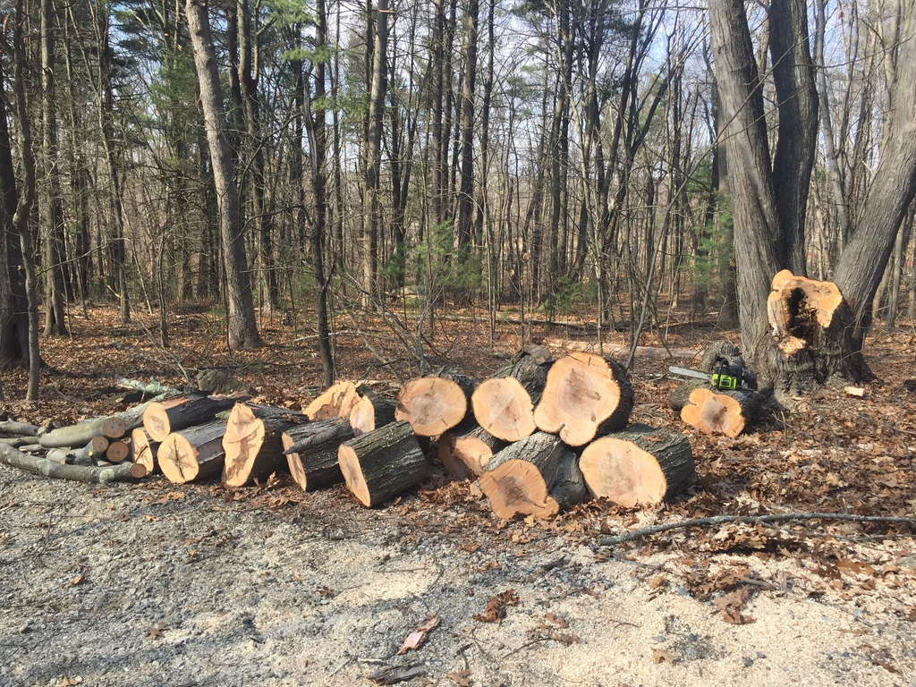

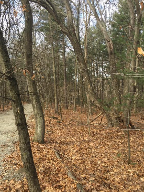

Red144runner 659 #8 Posted March 3, 2017 We had a problem tree over one of our trails. 45' maple 3' at the base, one of four trees growing in a group. This one was leaning hard and rotting at the butt. The lean was so severe I didn't need to notch or even under cut. Put the saw down, cut in 6" and it started to go. A lot of good cordwood from it, I used the 044 to drop it and make 4 cuts in the big part of the trunk, then hit a hidden rock. Finished the big stuff with the 3450 and cut up the limbs and branches. Good time, no injuries or equipment damage. 1 Share this post Link to post Share on other sites
