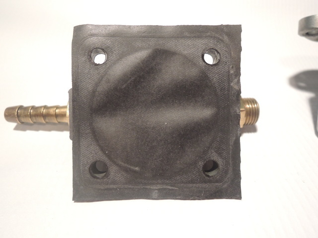

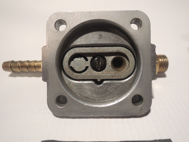

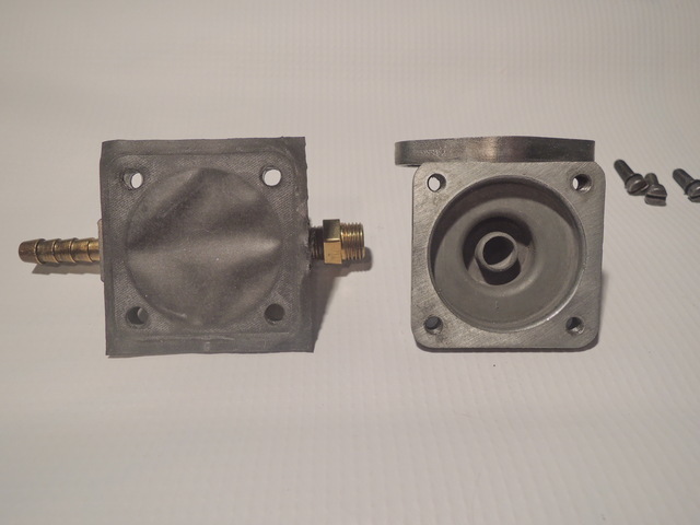

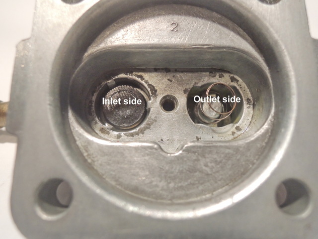

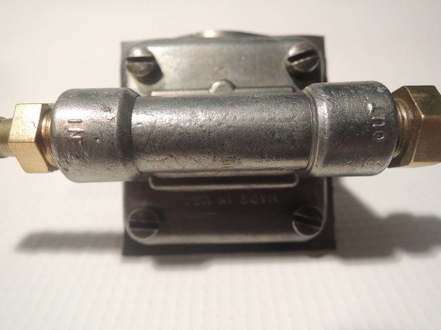

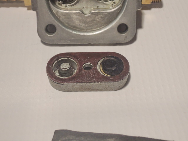

ACman 7,703 #9 Posted February 20, 2017 (edited) No rod on those pumps , they're a vacuum pump . Check out @buffaloman thread http:// Home Wheel Horse Engines 1962 702 fuel pump diagram ?? @rmaynard has some really good photos of his pump . Sorry can't figure out how to make the link work . Edited February 20, 2017 by ACman 5 Share this post Link to post Share on other sites
953 nut 64,401 #10 Posted February 20, 2017 3 hours ago, carlosking450 said: The petrol pump is broken, right? You must have a lever for your actuation, right? Several of the early Kohler 6 and 7 HP engines used a vacuum operated fuel pump, the up and down movement of the piston creates alternating pressure and vacuum which pulses the pump diaphragm. This type of pump must have a good gasket where it bolts to the block to work. If there is no hole in the sides pf the pump that would serve as a pivot point for the arm then you have the vacuum pump and all is well. 4 Share this post Link to post Share on other sites
prondzy 3,889 #11 Posted February 21, 2017 4 hours ago, WHX9 said: You are correct sir, you should take the base pan off to look for it. in case it fell into it. No jim, on a 702 its a vacuum operated pulse pump. You can get a new diaphragm from buckrancher. Later years ran a lever to the camshaft that you are thinking of. 4 Share this post Link to post Share on other sites

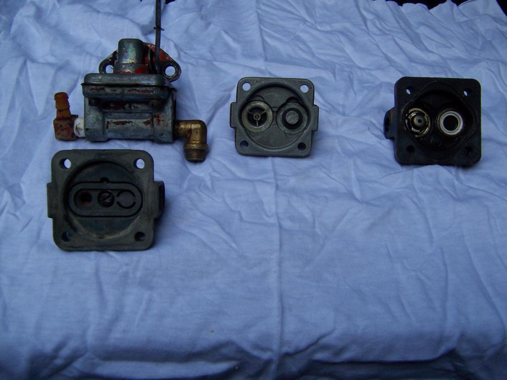

953 nut 64,401 #12 Posted February 21, 2017 Your fuel pump has two check valves (one in and one out) and a diaphragm, no real moving parts. The valve body will should look like the one on the left in the photo. If you remove the screw and remove the valves one at a time and invert (turn over) the rubber washers under the valve then reassemble it you will give it a new lease on life. If your diaphragm is good you can reuse it, if not send a personal message to @buckrancher, he is a member here and produces new ones. 3 Share this post Link to post Share on other sites
ACman 7,703 #13 Posted February 21, 2017 Bob I hope you don't mind but these are some really good detailed photos of this pump. I tried making a link to your post but couldn't figure it out . @rmaynard I'll hide post if you disapprove or have mods remove it . Don't want to break no rules. rmaynard The Brake Lining Guy Joined: November 25, 2009 Supporter 5,802 9,769 posts Member No:2221 Military Member: Coast_Guard Location: New Windsor, Maryland ID: 3 Posted April 27, 2016 (edited) Raining here today, so I have plenty of downtime. Took some pictures for you. Here is the vacuum operated (pulse) pump assembled Notice the IN and OUT markings on the top With the screws removed, the pump splits open revealing the diaphragm. With the diaphragm removed, the one-way valve assembly is seen. One screw is removed and the valve cover is removed. Notice the INLET side (left) has a fine coil spring, and the OUTLET side (right) has a flat disc. There is also a gasket to seal the cover. On the left we see the INLET disc, and on the right we see the OUTLET spring. That is how it supposed to be assembled. I hope this helps. Edited April 27, 2016 by rmaynard 9 people like this 7 Share this post Link to post Share on other sites

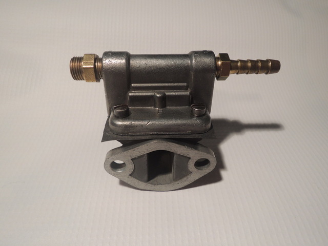

carlosking450 161 #24 Posted June 5, 2017 Hi friends, we continue with the restoration of my wheel horse 702, the engine has changed the two valves and a new plane has been made at the cylinder head. The cylinder head gasket has also been changed. I've also fitted a new carburetor. I had to clean the gas pump and set up the same gasket again. Someone can tell me the type of thread and measurement of the pump inlet and outlet of the pump? The connections that I have are in poor condition The engine has been started and works very well, and only need to disassemble again and paint 2 Share this post Link to post Share on other sites
