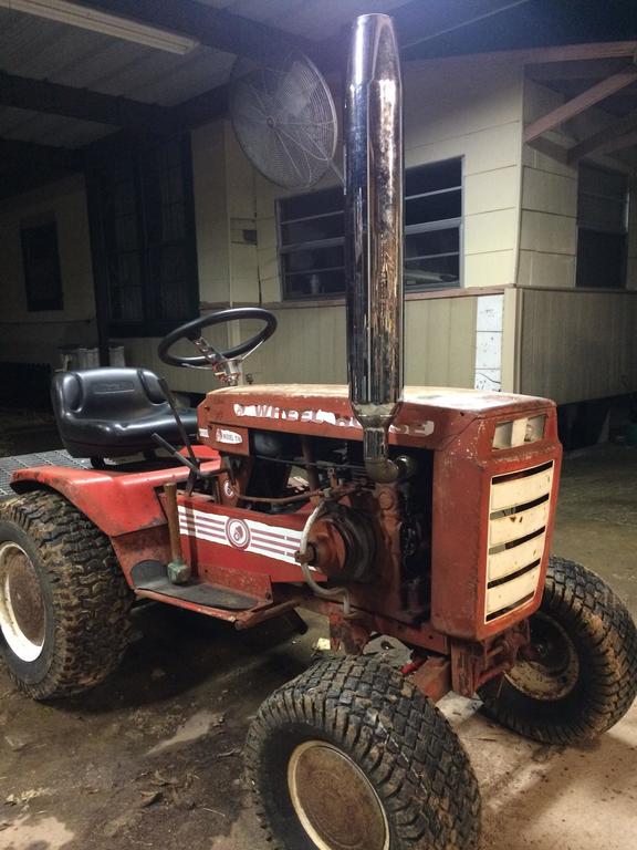

Hacksawhero123 351 #1 Posted February 8, 2017 I was on the C160 pulling my plow after dark yesterday. Under load at wide open throttle, I had about a 4 inch pretty blue flame burning steady at the tip of the stack. The elbow at the bottom was glowing a dull red color. Perhaps is running a bit lean. Anyone ever get the flame on your stack? Mark. 1 Share this post Link to post Share on other sites

WHX?? 56,853 #3 Posted February 8, 2017 My pepper pot on a K241 does the same thing Hero...gonna try riching it out a little after a carb cleaning & see what that does. Share this post Link to post Share on other sites

oldredrider 2,553 #7 Posted February 8, 2017 Hacksaw, your timing might be a bit too advanced. Check the point point setting Share this post Link to post Share on other sites
Ed Kennell 46,240 #8 Posted February 8, 2017 Sounds like you horse wants to be a 2 Share this post Link to post Share on other sites
953 nut 66,663 #9 Posted February 8, 2017 5 hours ago, Hacksawhero123 said: Perhaps is running a bit lean. I would think the blue flame is from unburned fuel igniting when it gets a bit of air. If you want to check the timing try this method; Kohler static_timing.pdf 1 Share this post Link to post Share on other sites
Hacksawhero123 351 #10 Posted February 8, 2017 I'm sure that the timing is a bit advanced. I need to pull the shroud to locate and hi light the timing mark. As tall as the stack is, I was surprised to see a flame at the tip. Mark. 6 Share this post Link to post Share on other sites

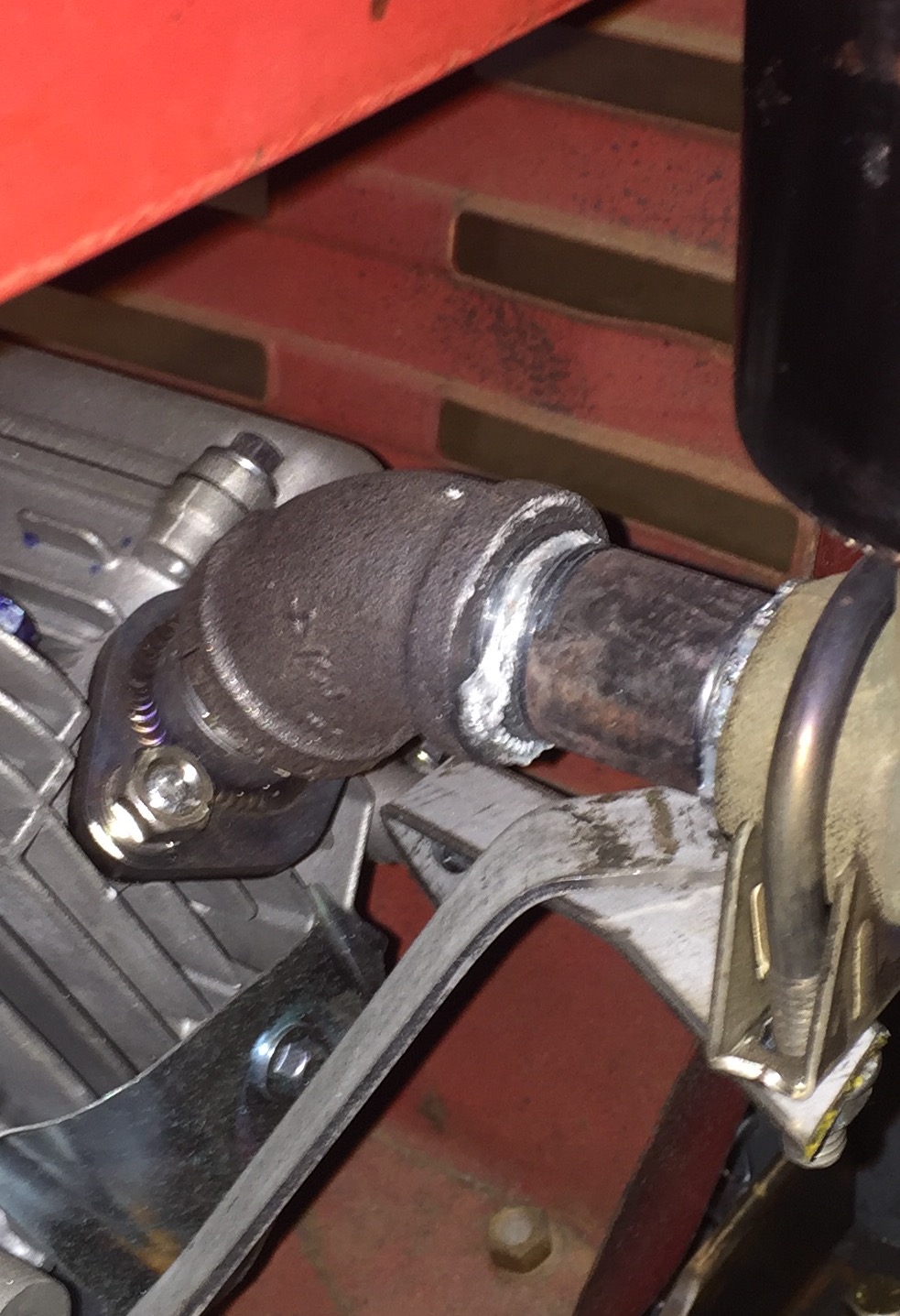

cschannuth 3,821 #13 Posted February 8, 2017 I don't have flames or glowing on the Predator stack but I have melted the lock nut on the fitting closest to the engine. As you can see in the photo it almost looks like Teflon tape on the threads. 1 Share this post Link to post Share on other sites

953 nut 66,663 #16 Posted February 9, 2017 1 hour ago, cschannuth said: melted the lock nut Electrical lock nuts come in steel and aluminum, you may need to go to an electrical sippl house to find the steel ones. 22 minutes ago, WHX9 said: @953 nut gotta chime in on this ....he's got the same stack I think I shared a picture of mine and contributed to @Hacksawhero123 delinquency! 3 Share this post Link to post Share on other sites
Hacksawhero123 351 #17 Posted February 9, 2017 Mine isn't cored out. I wanted it as quiet as I could get it. The muffler is from a 2015 Road King. Best of all, it was free. I'll try to get a video at night soon. Mark. 6 Share this post Link to post Share on other sites

tbarnhart 240 #20 Posted February 10, 2017 Actually, the timing could probably be advanced a bit, but its just fine the way it is. The extreme exhaust heat and flame is from the air/fuel mixture not burning completely in the cylinder and continuing to burn out the exhaust. Advancing the timing will help initiate the burn sooner, but will also cause more kick-back on the starter. Another option we often don't think about is to use lower octane gas. High octane gas burns slower, and more of the potential power goes out the exhaust. We really don't need high octane gas in a 7:1 compression engine anyway, although 90 octane is the only ethanol-free available to me. 2 Share this post Link to post Share on other sites

Hacksawhero123 351 #22 Posted February 12, 2017 Update. It appears that the reason for the "Smokestack Lightnin" was the timing was waaaay advanced. Also explains the purple ends on my chrome stack. Oops. Anywho, I appreciate greatly the input from you fellas that chimed in. I had made up my mind that the carb was leaned out. You guys kept me from heading off the wrong direction. I regret that I didn't get a smokestack lightnin video for ya. Thanks again, Gentlemen. Mark. 4 Share this post Link to post Share on other sites
