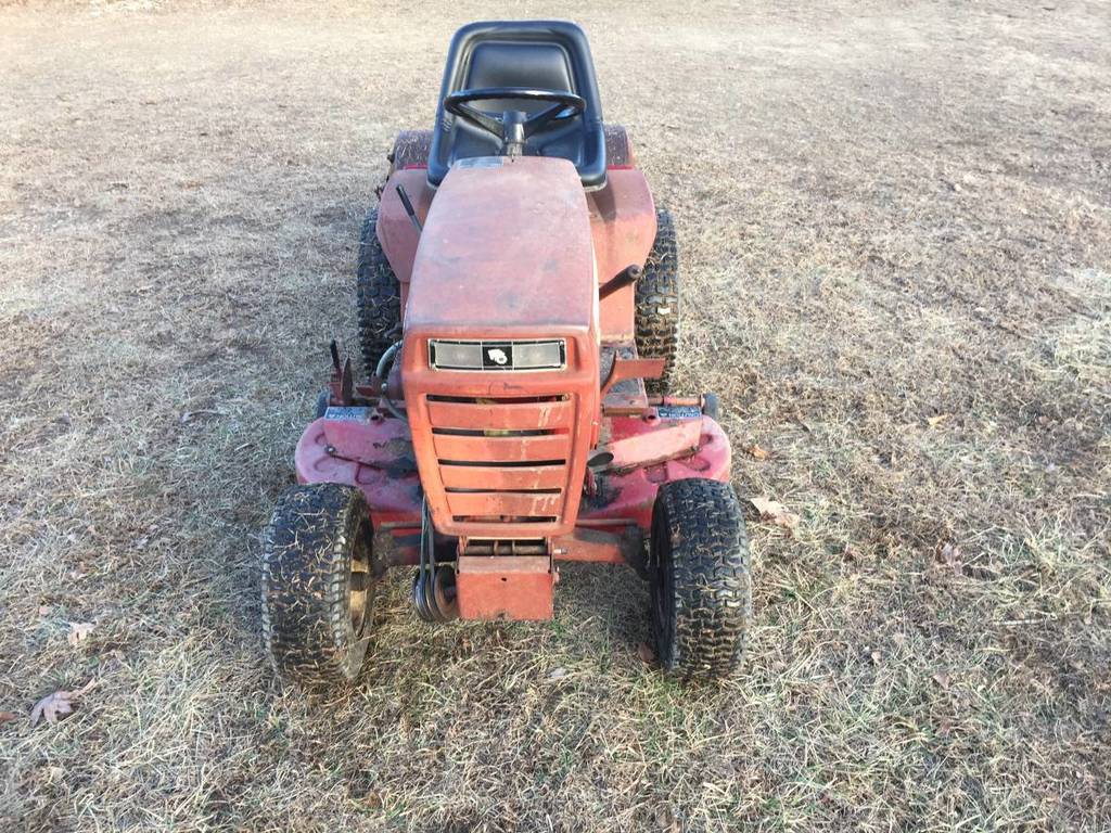

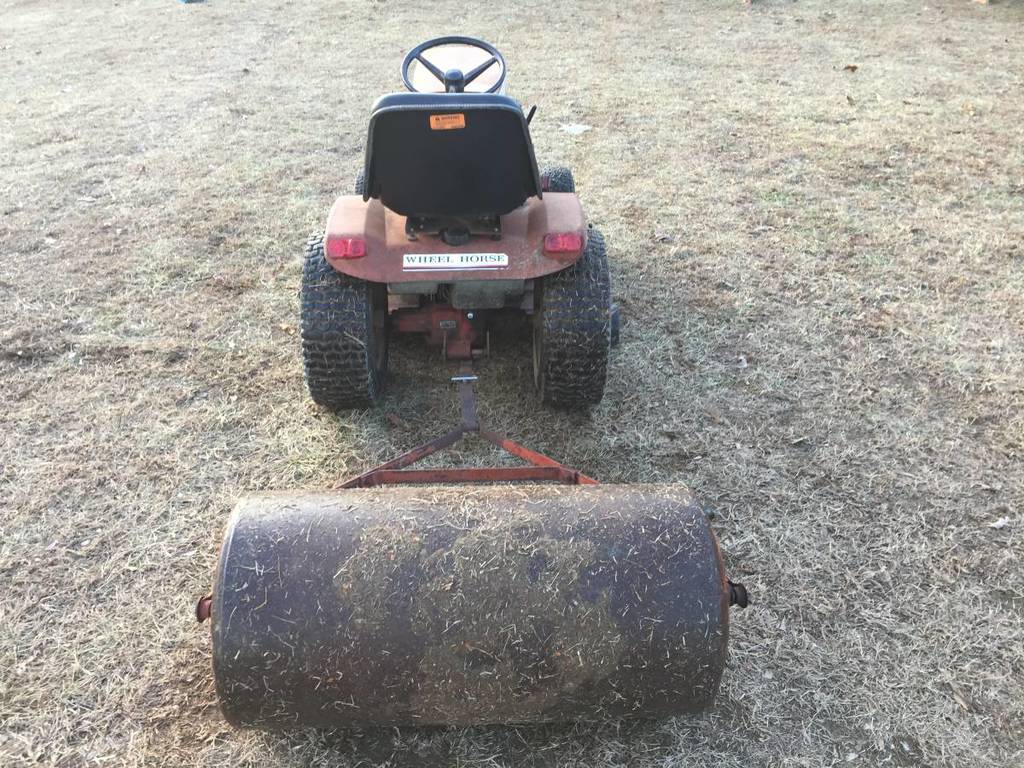

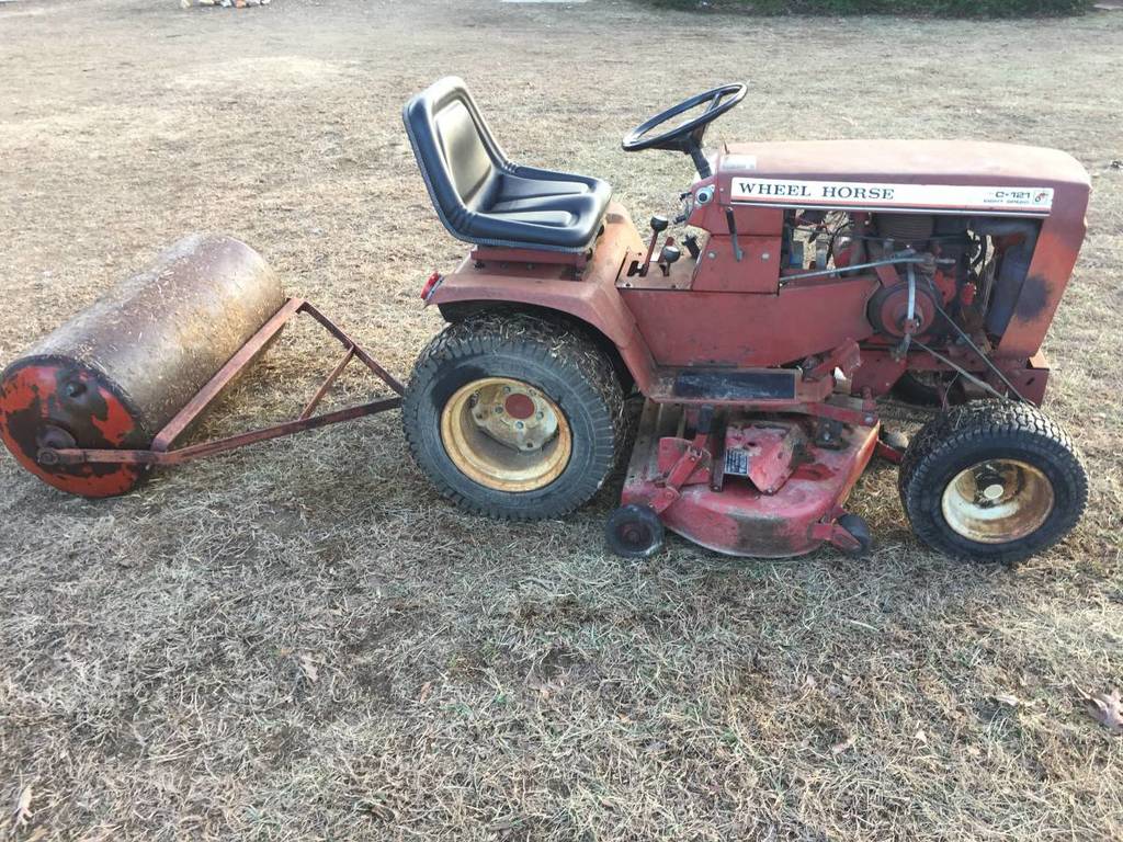

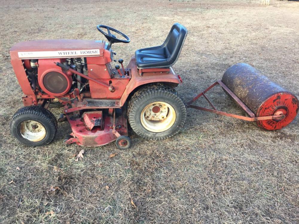

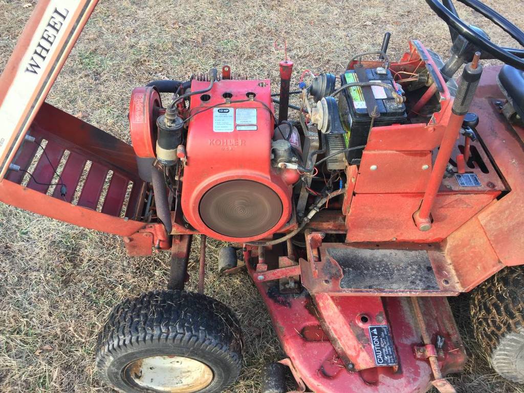

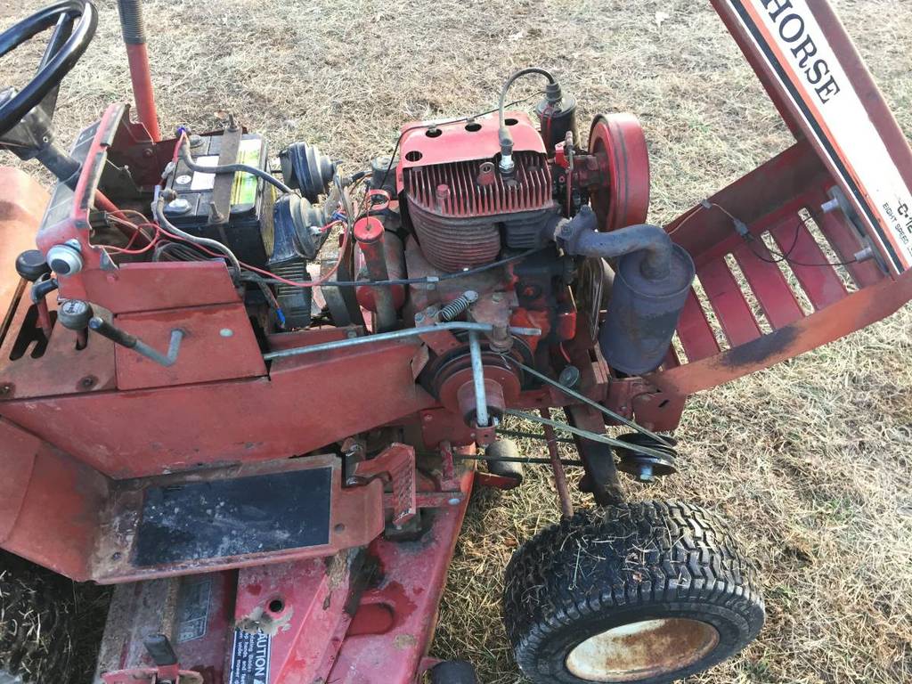

I believe the C-121 in question is an 8 speed.  I didn't see the C-120 so I can't comment on that one.  There is a slight difference in a C-120 and a C-121, basically the placement of the fuel tank.  The C-120 will have the fuel tank above the engine, under the hood, while the C-121 will have it beneath the seat, under the fender deck.  I like the fuel tank underneath the seat myself, but your fuel pump has to be in good working order with the fuel tank there.  But, I do think both the C-120 and C-121 will have fuel pumps.
Pictures of the aforementioned C-121.
I just now noticed it has a couple of horns.....  BTW, the roller is included in the sale.
  • Like 4

bmsgaffer
You get a roller too, cool!
Looks to be pretty solid. I am pretty sure the belt to the mower is wrong though, it looks too small and there seem to be a few too many twists between PTO and mule pulleys.
I personally like the under-seat fuel tanks as well.
Just a note with the C-121 is that it has a shaker-plate mounted engine (just like the black-hoods C-xx5). Some people hate them, I like them. However, they will likely need replacing. You can replace them with solid pieces or go with the rubber mounts from toro ($$$). If you replace the engine you will need one with the shallow oil pan (Usually denoted by an A in the engine number, eg K-341AS).
If she runs strong then you cant go wrong there.
  • Like 2
T-Mo
A C-125 replaced the C-121, and about the only difference with the 8 speeds would be the plastic fender deck and the hood.  These are referred to as the black hood Wheel Horses.  They are also good and I wouldn't be afraid of buying it if the price was good.
  • Like 1
