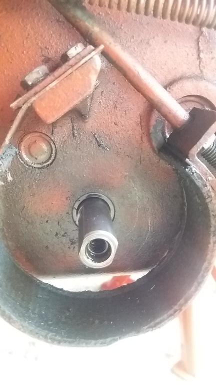

Ok, so I've found out just where the oil is leaving the transmission on my C120 8 speed from around 1974.
Removed the brake "drum" and discovered a thin ring around the axle, is this part of the seal and can this be replaced without tearing the whole transmission?
I found several posts & youtube videos about replacing axle seals, but none about the brake axle seal...
Since this is the lowest axle, the oil-level is to low to determine if axle seals are bad too...
I'm uncertain of what transmission I've got so trying to find the manual for it has been hard, someone who can help?
Yanking the axel I can just about feel a play, is this OK, or should I replace the bearing too?

A slight in and out movement is normal, up & down is not. Up and down (or side to side) would indicate a bad bearing which is not common on the brake shaft. The seal is simple to replace and does not require opening up the case. A seal should be available at your local Toro dealer or Napa auto parts store.
There are many threads here on RedSqure that will help you understand how to do it. I recommend a seal from your local Napa auto parts store SKF 7410 or CR7410. I find them to be better made than the Toro part 100441.
Here is the link to the seal/bearing cross reference page.  Use #3 in the list for your transmission which is probably a 5091 or 103907.

Horse Digger
Ok, Toro dealer is avalible, Napa is not, since I live in Sweden.
However SKF is "Svenska Kullager Fabriken" meaning Swedish Ball bearing Factory...
I think bying a "SKF 7410" should be doable...
Maybe, when the transmission is filled up, the play is unnoticeable?
