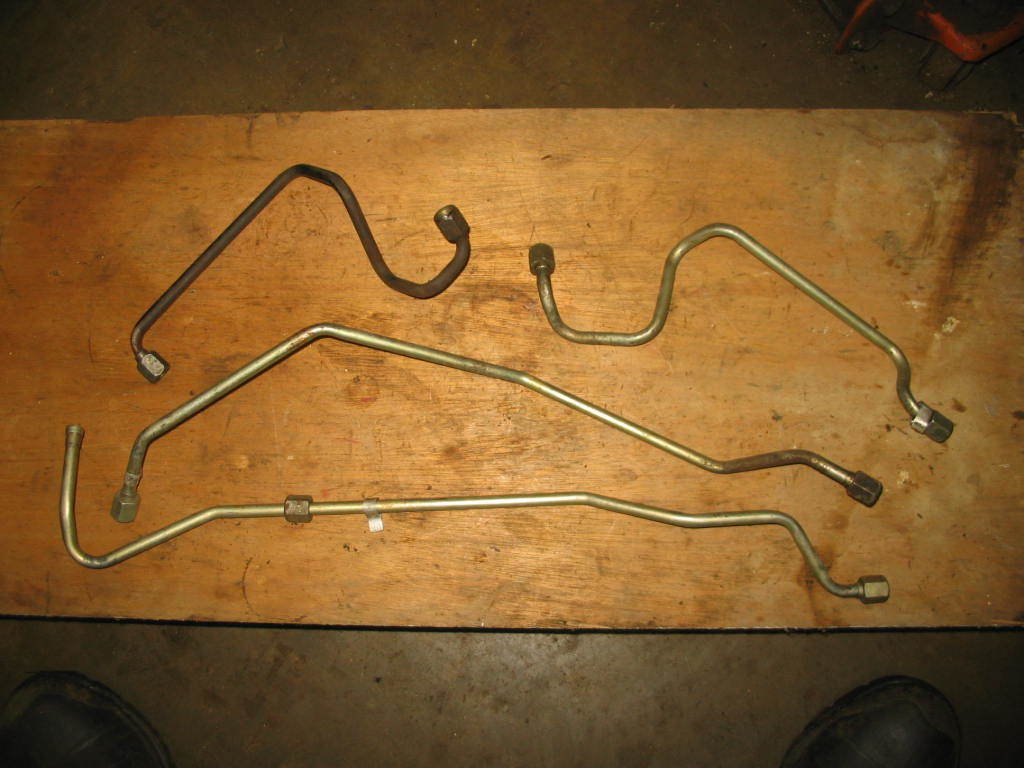

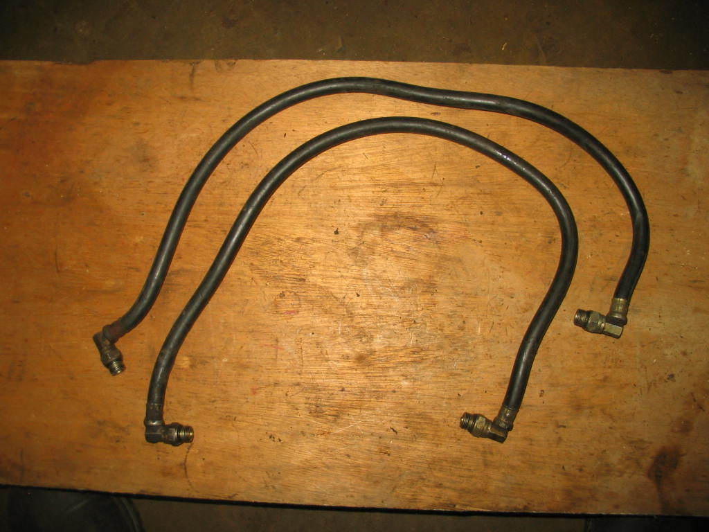

daveoman1966
I ahve all the hyd lines from a 520H.... both the steel lines and the rubber ones
For further info, send me an OFF-SITE email...  my address is:
daveoman@windstream.net
