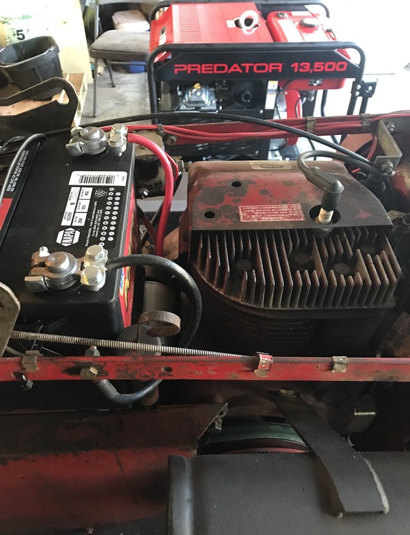

Aldon 4,832 #1 Posted January 22, 2017 (edited) It is glorious to get a 50 degree day here in the Adirondacks in mid January! After a implement run with fast88pu and talking tractors for a bit I managed to get some things done. I loath the lawn and garden batteries and their sub par quality. I spent a few hours researching car batteries and dimensions and decided to give the 26R a try. Well it's sung but perfect fit in the GT14. Yet another reason I prefer this size tractor. Supposedly good for 5 years. 3 times the cost of the last couple L&G's I bought. So it's a bargain on top of the fact that I should not have as many opportunities to go out to start my tractors and have the battery be failing. Irksome. Also assembled my parts washer and 1 ton folding crane jack that a snagged yesterday at HF. Looking forward to spring and more of these nice days. Edited January 22, 2017 by Aldon 13 Share this post Link to post Share on other sites

squonk 47,779 #10 Posted January 22, 2017 (edited) If you had swapped the locations of your cables Aldon you could have used a regular Group 26 and saved some cash. I used to sell more 26 batteries at Napa than you could shake a stick at. If you had a piece of equipment and needed a battery, a 26 came off the shelf if you had room for it. I use the TSC L & G batteries in my stuff. Tender on all of them. I replace a battery every 4 years just because I feel it's time. Haven't had a failure on any of them. I did have to replace my 2 yr. old Everstart Maxx in my Tundra last week. It was replaced under warranty. Took 1 1/2 hrs at the Wally World Auto Center to get er done. Anyone who is retired who reads this and is bored everyday, or feels like your life has no purpose, just go down to your local Wal Mart auto center on a Saturday afternoon and watch the customers. You life will have new meaning after that experience. Edited January 22, 2017 by squonk 6 Share this post Link to post Share on other sites
Aldon 4,832 #11 Posted January 22, 2017 Thanks for the info on the reverse vs non reversed configuration Mike. I could make do with the 26, but I do like the orientation of the 26R as it makes for a cleaner wiring look. I guess I'm into tractor Feng Shui. 6 Share this post Link to post Share on other sites
squonk 47,779 #12 Posted January 22, 2017 The Group 26 used to have the posts in the center. That way it was universal in installation and you only had to stock the 1 number. Then some brilliant person decided they needed to move the post to the edge and then make a reverse polarity battery to compensate for it. Now you stocked 10 regular 26 batteries and 1 reverse. Then you hoped to sell that 26R battery before it got too old and had to send it back. 1 Share this post Link to post Share on other sites

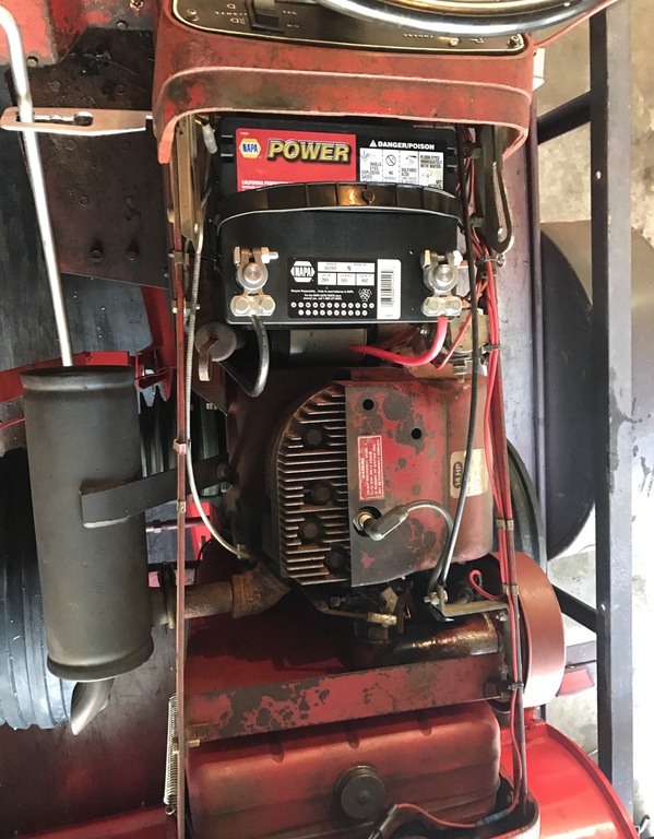

swisstrac 49 #13 Posted January 22, 2017 13 hours ago, Aldon said: It is glorious to get a 50 degree day here in the Adirondacks in mid January! After a implement run with fast88pu and talking tractors for a bit I managed to get some things done. I loath the lawn and garden batteries and their sub par quality. I spent a few hours researching car batteries and dimensions and decided to give the 26R a try. Well it's sung but perfect fit in the GT14. Yet another reason I prefer this size tractor. Supposedly good for 5 years. 3 times the cost of the last couple L&G's I bought. So it's a bargain on top of the fact that I should not have as many opportunities to go out to start my tractors and have the battery be failing. Irksome. Also assembled my parts washer and 1 ton folding crane jack that a snagged yesterday at HF. Looking forward to spring and more of these nice days. I have the same battery on my gt 14 a recon interstate and seems to be doing the job very well/ have used recon interstate for many years on used cars approx 90 percent satisfied/mostly a question of price with that philosophy you have to accept some failure! 2 Share this post Link to post Share on other sites
Aldon 4,832 #14 Posted January 22, 2017 It looks like all you GT14 guys are way ahead of me on Battery choice:-) Share this post Link to post Share on other sites
ztnoo 2,302 #15 Posted January 22, 2017 Mr.T, could you please provide us visually challenged guys the NAPA part number for the battery you snagged? I assume this is a sealed battery from what I can make out of your shots. ??? I've always just bought whatever I could find at the local auto parts store about a mile away. 3 to 4 years is what I typically get for lifespan. It never gets below freezing in my garage (attached to house and occasionally I'll run an electric heater or kerosene heater), and I only occasionally put a charger on the battery during the off season, since my GT 14 is a mower tractor only. My biggest problems with tractor batteries has always been sulfacation. I would assume my choice of lead/acid battery is the primary cause of this. 2 Share this post Link to post Share on other sites
squonk 47,779 #16 Posted January 22, 2017 9 minutes ago, ztnoo said: Mr.T, could you please provide us visually challenged guys the NAPA part number for the battery you snagged? I assume this is a sealed battery from what I can make out of your shots. ??? I've always just bought whatever I could find at the local auto parts store about a mile away. 3 to 4 years is what I typically get for lifespan. It never gets below freezing in my garage (attached to house and occasionally I'll run an electric heater or kerosene heater), and I only occasionally put a charger on the battery during the off season, since my GT 14 is a mower tractor only. My biggest problems with tractor batteries has always been sulfacation. I would assume my choice of lead/acid battery is the primary cause of this. A std. group 26 is a Napa 6526. Reverse polarity is a 6526R 65 month pro-rated warranty 3 Share this post Link to post Share on other sites
Aldon 4,832 #17 Posted January 22, 2017 The one I chose is 6526R the first 2 numbers are the months warranteed and the last 2 are the battery size the R is configuration of terminals as Sqonk highlighted earlier. The one I chose is middle of the line. Napa sells both a lesser and greater length coverage unit. The Legend battery is 75 month I believe. So it would be 7526R. yes, sealed battery. 2 Share this post Link to post Share on other sites
ztnoo 2,302 #18 Posted January 22, 2017 Thanks Mike.......and Aldon. I'm still a little thick skulled on what the "R" designates. Does that mean in this case, the positive post/attachment lug is on the Right side of the battery?.......i.e. if there is no "R" part designation, the positive post is always on the left??? Since I have a GT 14 with the same setup as Aldon's, I need to clarify (beat) this into my head. Steve 2 Share this post Link to post Share on other sites

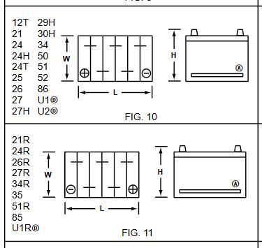

pfrederi 20,999 #19 Posted January 22, 2017 Group 26 will NOT fit into the battery trays on Chargers/Raiders etal. Too wide 26 and 26R terminal placement 3 Share this post Link to post Share on other sites
Aldon 4,832 #20 Posted January 22, 2017 Thanks for the visual graphic @pfrederi it's true pics are worth a thousand words! 2 Share this post Link to post Share on other sites
ztnoo 2,302 #21 Posted January 22, 2017 Thanks Paul. I believe I finally got the "R" concept pounded into my head. Aldon.........that's so true....... 2 Share this post Link to post Share on other sites
clueless 3,436 #22 Posted January 22, 2017 6 hours ago, ztnoo said: Thanks Paul. I believe I finally got the "R" concept pounded into my head. Aldon.........that's so true....... I've always been confused about the battery configuration when it comes to right or left pole, being dyslexic might be the problem. What is considers the front of the battery? I have L&G battery with labels on both sides. When looking at a battery where would the cell refill caps be when you say the front? Share this post Link to post Share on other sites
pfrederi 20,999 #23 Posted January 22, 2017 Front is where the terminals are Share this post Link to post Share on other sites
clueless 3,436 #24 Posted January 23, 2017 6 hours ago, ztnoo said: 34 minutes ago, pfrederi said: Front is where the terminals are Okay the batteries in my 2004 tundra, and both my santa fe, all have the pos terminal on the right, but when replacing them there was never a R designation, still confused. Share this post Link to post Share on other sites
clueless 3,436 #25 Posted January 23, 2017 Just looked at the battery in the tundra, it's a Intestate MT24F, I think the MT stands for mega tron, or mega ton, so my assumption is the F has something to do with the right hand positive post. Share this post Link to post Share on other sites
