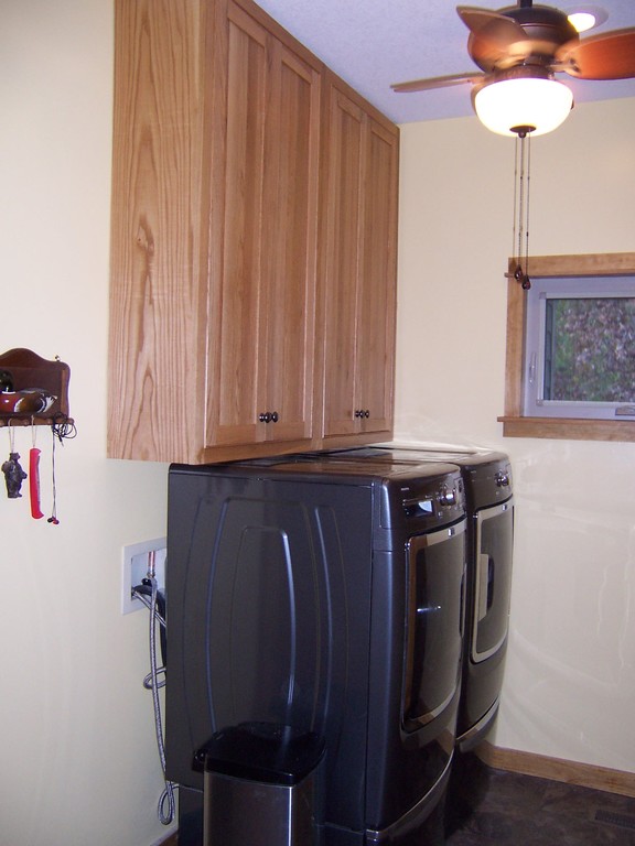

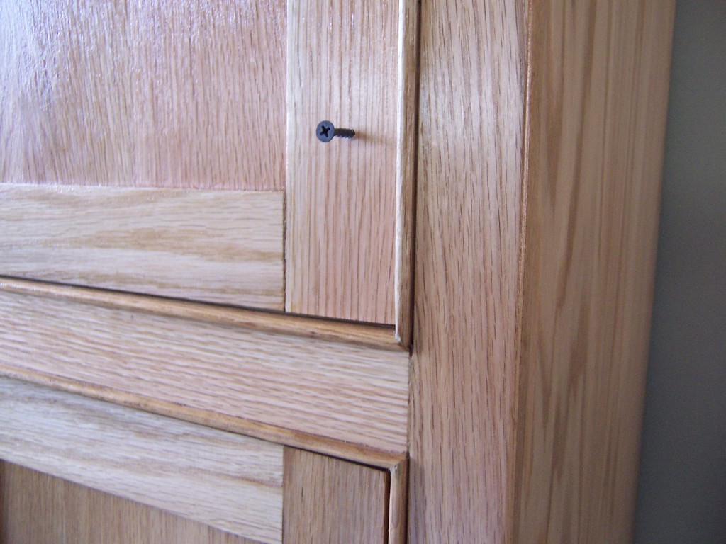

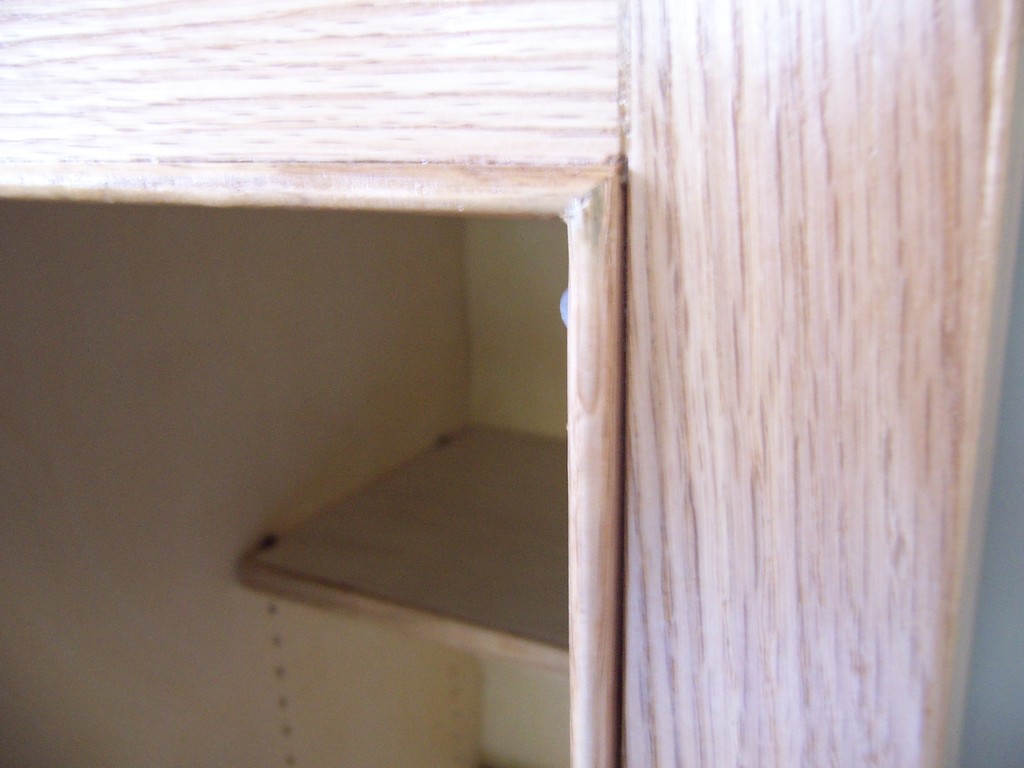

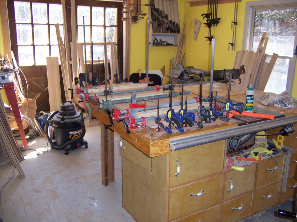

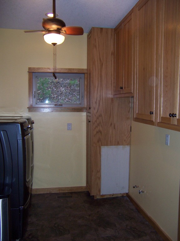

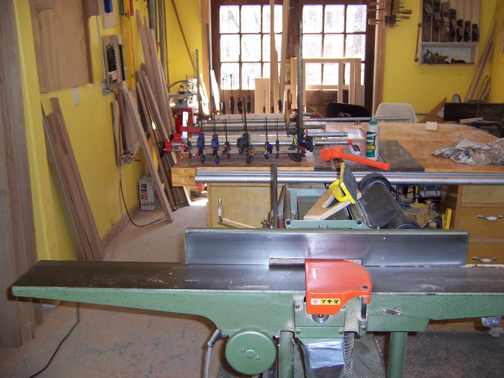

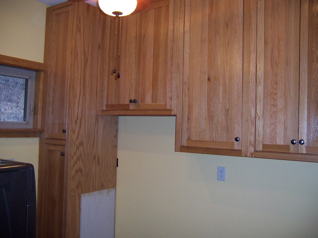

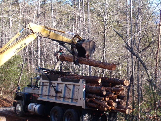

953 nut 63,805 #1 Posted January 20, 2017 When we were finishing up construction of our new home four years ago the only room that wasn't completed was the laundry room. My wife hadn't decided what she wanted in the way of cabines and I was ready to take a break after nearly two years of building. At the time our property was cleared I had all of the oak trees taken to a saw mill, much of the lumber was used at our church for some renovations and the rest has been waiting patiently for me to get off my butt. This is one of seven loads of logs. For the past year I have been making doors, face frames and cabinet boxes as time allowed. When you are gluing up door panels you need lots of clamps! Good quality tools help too. My wife picked out this detail with flush doors wrapped by half round moldings. Making and fitting the moldings is VERY time consuming. This morning a couple of good friends came over and we hung the upper cabinets, the base cabinets are being built now. By spring I should be finished with this little "Honey Do". Then I will find out what she has up her sleeve for me to do next. 20 Share this post Link to post Share on other sites
KC9KAS 4,746 #2 Posted January 20, 2017 Cabinets look very nice! I know what you are saying.....When my wife gets that painful look on her face and says, "I've been thinking......" it usually means work for Ken! 5 Share this post Link to post Share on other sites
elcamino/wheelhorse 9,362 #3 Posted January 20, 2017 @953 nut Can I come live in your wood working shop? I really like your table saw/work bench. What a great idea. If you wake up one morning and find it missing don't think of me. 6 Share this post Link to post Share on other sites

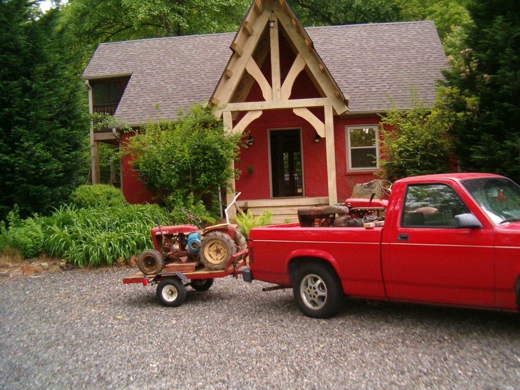

953 nut 63,805 #4 Posted January 20, 2017 16 minutes ago, elcamino/wheelhorse said: come live in your wood working shop? The woodworking shop had been our guest house prior to building our new house. When we bought the property it had two single bedroom houses, we liked the property enough (and the price) that it didn't matter; planned on building a new house anyway. Now the house we lived in for five years is the guest house. Here is a picture of it after a horse rustling trip in 2006. Suburban 400 on the trailer and a pair of RJs in the truck; '57 RJ-35 and a '58 RJ. 9 Share this post Link to post Share on other sites
Kurt-NEPA 756 #5 Posted January 20, 2017 Nice pics of your shop. A woodworker can't have too many clamps! Well done on the cabinets. Share this post Link to post Share on other sites

JAinVA 4,638 #7 Posted January 20, 2017 Really nice work.I am curious if the doors you made have a floating center panel?They look like they are made from solid stock.Nothing like making something of wood from you own land. 3 Share this post Link to post Share on other sites
953 nut 63,805 #8 Posted January 21, 2017 1 minute ago, JAinVA said: Nothing like making something of wood from you own land. You got that right! There is nothing quite as satisfying as creating something out of materials that most people wouldn't have saved. The door panels are solid oak and are free floating, the grooves in the stiles and rails have 1/4" rubber balls in them to prevent rattling but allow for expansion and contraction. 3 Share this post Link to post Share on other sites

JAinVA 4,638 #11 Posted January 21, 2017 (edited) Dick, Sounds like you have it covered.Working with solid wood presents a totally different set of challenges than manufactured panels as you know well.You're work and photos are a good example of the diversity of the talents and skills that the folks here have.Beautiful work and now the missus who was showed the pictures asks when I'm going to redo her kitchen. Edited January 21, 2017 by JAinVA 3 Share this post Link to post Share on other sites

dcrage 631 #18 Posted January 21, 2017 Love the trusses on the front porch of the guest house -- What was this property? A Vanderbilt's cousins weekend retreat?? -- I can see why you purchased the place 2 Share this post Link to post Share on other sites
elcamino/wheelhorse 9,362 #19 Posted January 22, 2017 20 hours ago, JAinVA said: Jim does that thing run? When I saw it ,it was pretty but you didn't start it.Just askin. Yes it runs put a total of 255 miles on it between the 12 month inspections . I keep wanting to sell it but then the head of the household gives me the look and quotes the amount of money that I have spent on it. 2 Share this post Link to post Share on other sites
