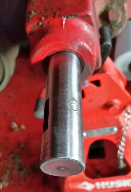

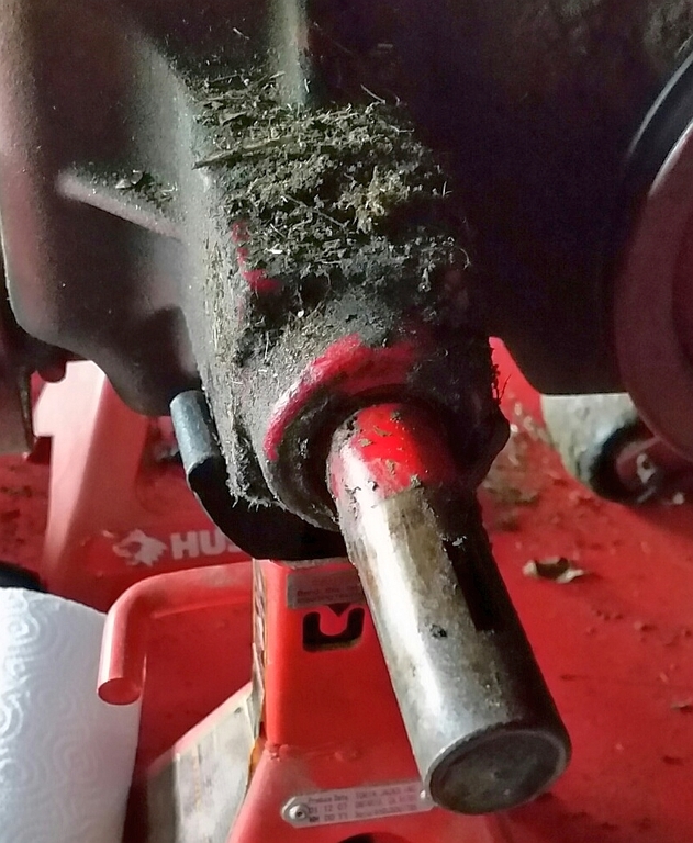

Texas Todd 1,025 #11 Posted January 24, 2017 On 1/21/2017 at 6:49 PM, 953 nut said: If you are blowing the main fuse there is some insulation chafed somewhere. Right you were. Found several issues while having it up in the air. The belt was rubbing against the other fuse blocks wires and had rubbed down to the wire, relocated that one and taped it up. Rodent delecti has been up in there sharpening his teeth as well. Fixed three or four chews and disconnected the clutch disconnect while I was in there. Replaced all the fuel line and since I had it up, decided to replace the leaking axle seals and input shaft seal. I was delighted with the removal of the hubs (I may never get a chance to say that again!). A little effort, but nothing like the pain the C-160 was. The axles cleaned up nice. Will try to put the new seals on tomorrow and then tackle the input shaft seal. 2 Share this post Link to post Share on other sites
Texas Todd 1,025 #12 Posted January 25, 2017 Got all of the seals replaced with the help of the guru himself @stevasaurus Apparently I have an oddball transmission, but the regular seals fit just fine. Sure appreciated your help Steve! It appears the fuel issue was the primer bulb itself. I guess it wasn't getting a good seal. The filter was never staying full with it inline. Removed it and smooth sailing. I bet I don't put a primer bulb in again. Maybe I just got a bad one, I dunno. But the Sleeper is all fixed up. Now onto the C-121, looks like all four seals may be shot on it......as well as the fuel line..... Thanks for everyone's input!!! 4 Share this post Link to post Share on other sites
