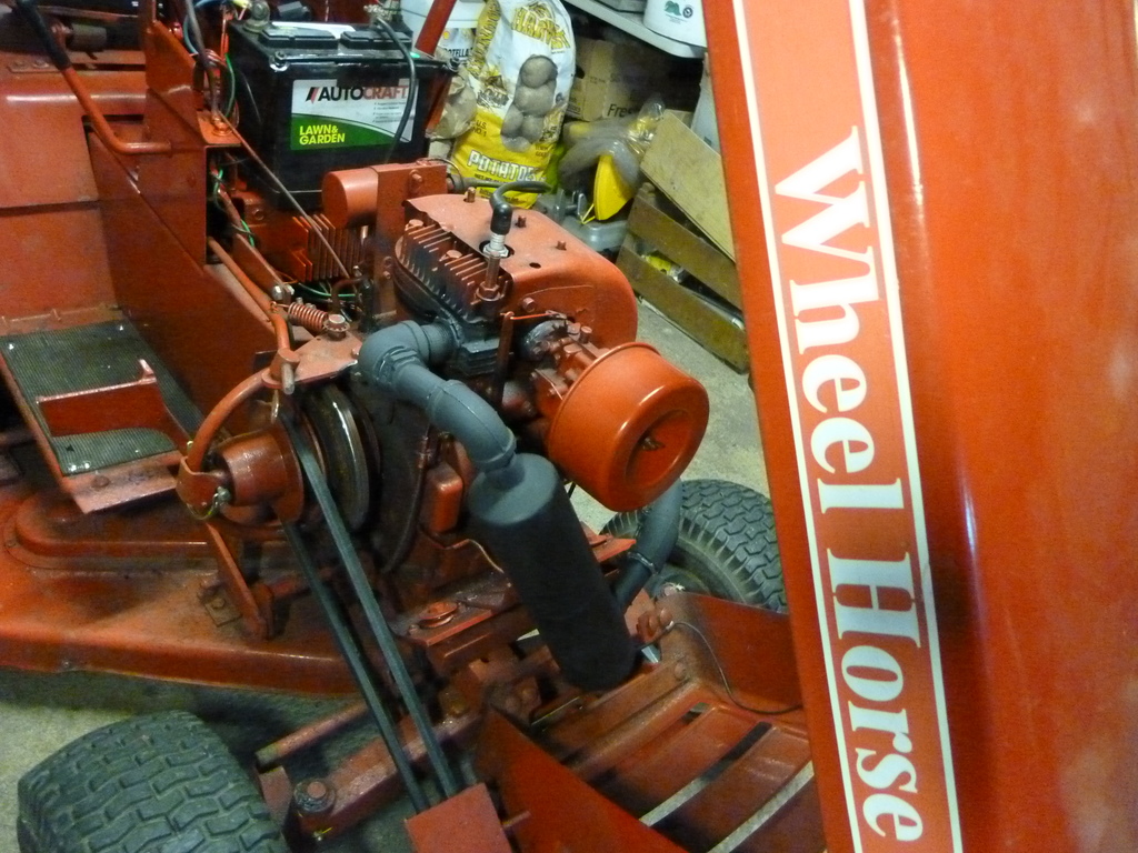

Rob R

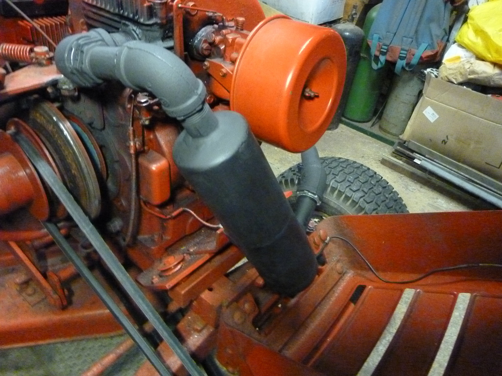

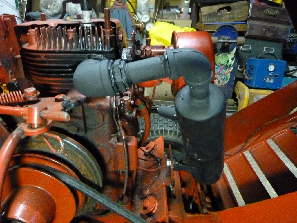

C-81 Muffler Fab'd from a used Propane Tank
DougC
Looks good! You did a nice fabrication there.   :handgestures-thumbupright:
  • Like 2
Wishin4a416
Nice job!! It should last quite a while I would think. Are those Yukon Golds in the background?
  • Like 1
Rob R
Yes Yukon Golds from my Brothers Farm,.... delicious.....!
Edited by rgrottk
Wishin4a416
24 minutes ago, rgrottk said:
Yes Yukon Golds from my Bros,.... delicious.....!
Ah man Yukons were scarce around here this Fall. Didnt get any. Yum Yum...
scotty
That muffler looks amazing! Can hardly tell the difference from a nelson.
  • Like 1
Sparky
Nice fabrication job!
  What is in the propane tank for a baffle?
  Mike....
  • Like 1
rmaynard
  Mike....
Mike,
See the next to the last sentence in his first post. I was going to ask the same question until I re-read it.
Quite a bit of handy work. I just can't say enough about guys like rgrottk who can fabricate.
  • Like 3
DennisThornton
I'm done similar.  I'm expecting it to last along as a new muffler.
  • Like 1
roadapples
Nice job, and you can still get to the points...:handgestures-thumbupright:
  • Like 1
pfrederi
How did you purge the tank before you started cutting on it.  I wold probably blow myself up:P
  • Like 2
Rob R
Understand your concern pfrederi....The tanks have two (2) spring valves (like the one's in a tire tube)..... they are a bit deeper then the one's in a tire tube so I took a piece of steel rod (same size as the hole) took my small cut-off tool cut a fork in the top of the rod inserted it into the tank valves screwed the valves out and then blew-out the tank with my air compressor. Note: you can also depress the valve with a small screw driver and get like 98% of any gas out. Like anything else you do have to take pre-cautions. You could also fill it with water after the valves are out and then drain.
  • Like 4
Aldon
I have done same by filing a large cotter key flat at the ends and using it similarly to a valve stem remover. A nail or small screwdriver through the top of the cotter key for torque.
Edited by Aldon
  • Like 3
ronhatch

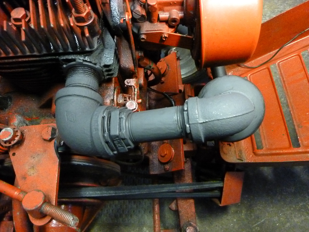

Nice work Rob! I wish there were more post that showcased innovative ideas. I bet that outlast a store bought muffler 2 to 1.  A propane tank would also make a great
looking stack muffler. May I ask; Why did you go from a 1" pipe down to a 3/4"? I would think it may increase back pressure???? Just saying.
  • Like 2
Rob R
This is the first one I did, soo I was hesitant to put a 1" hole in the Tank..... in my mind some back pressure it good... runs and sounds great so far..... don't know what I would do if I ever do a second one.
That's why your "the Man" Aldon... didn't think you mess'd with anything smaller then a GT14?
Edited by rgrottk
  • Like 1
