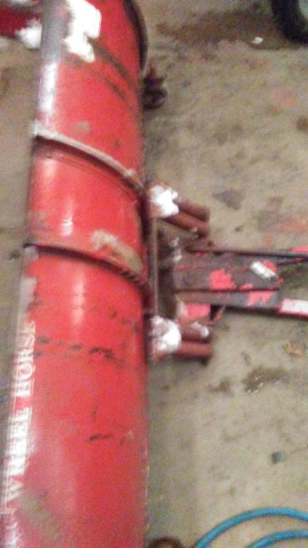

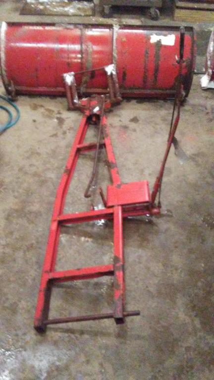

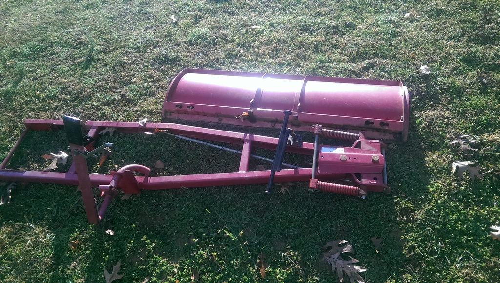

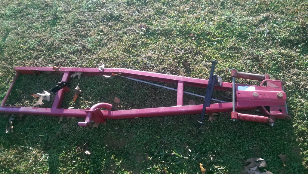

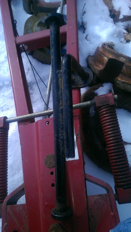

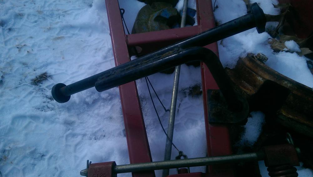

Redisbest 22 #1 Posted January 10, 2017 Found this in junk yard...Price was great.....Plan on putting on 522xi...I think it is a D series....It has dual springs and 56" wide...Serial 167628 model 6-1142.... Hope the photos work...First time trying this on here. 1 Share this post Link to post Share on other sites

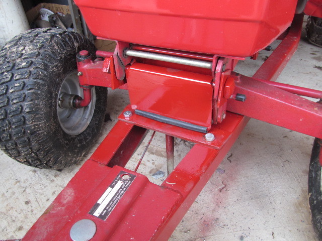

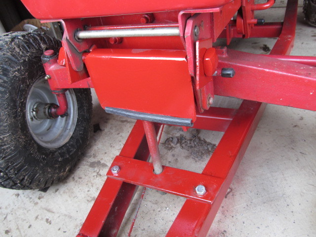

Redisbest 22 #3 Posted January 10, 2017 I also could use a photo of a 5xi plow stabilizer...And crank support for a 2 stage (for 5xi) ...All I have is a small photo depicting a round pin thru a tongue shaped bracket that ingages near angle head assy of plow....Unless the tongue bracket is welded to plow frame and round pin is welded to bracket made for front attach-matic system...Where plow would raise and lower ....riding on the male/ female "stabilizer".... Is this correct ? To help with lateral movement ....Because plow is achored so far back ? 4 minutes ago, gwest_ca said: Garry Thanks Gary.....Man I hate to modify this nice plow....I thought it was for a D series Share this post Link to post Share on other sites

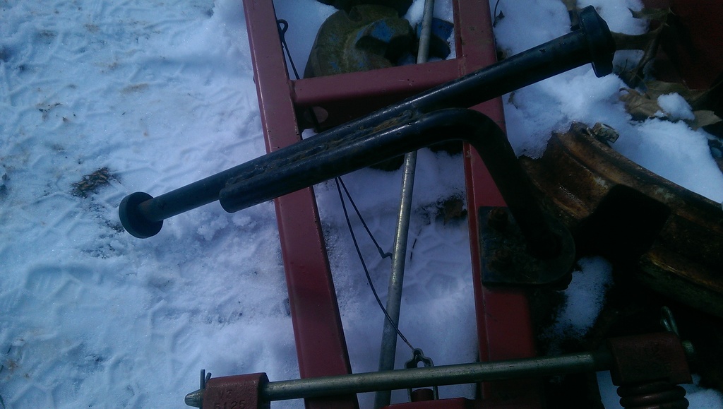

WVHillbilly520H 10,378 #4 Posted January 10, 2017 Sway bar just slides up/down through bracket bolted to plow frame then a hairpin cotter/washer holds it from falling out the bottom plus the angle lever is a completely different beast to, @JERSEYHAWG / Glenn probably could help with the blower chute rotation crank picture,Jeff. 1 Share this post Link to post Share on other sites
Redisbest 22 #5 Posted January 10, 2017 Thanks....Nice photos....Works like I thought.....Wow the xi plows are way different than the plow I found in photos above ! I can make that stablizer part easily... Thanks again for clarifying. Share this post Link to post Share on other sites

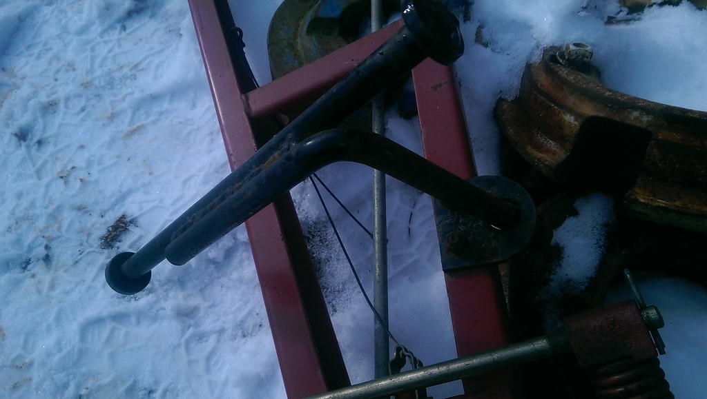

Ed Kennell 46,154 #10 Posted January 10, 2017 My stabilizer.. just an other option. 1 Share this post Link to post Share on other sites

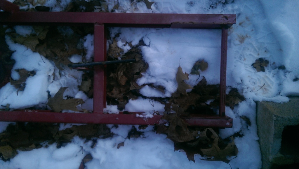

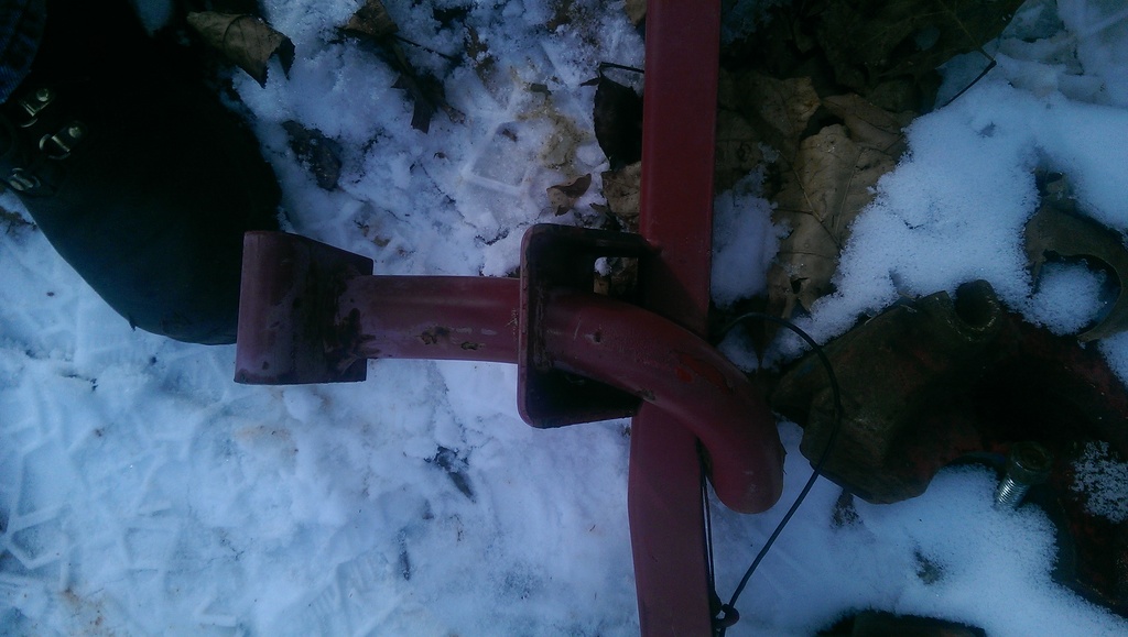

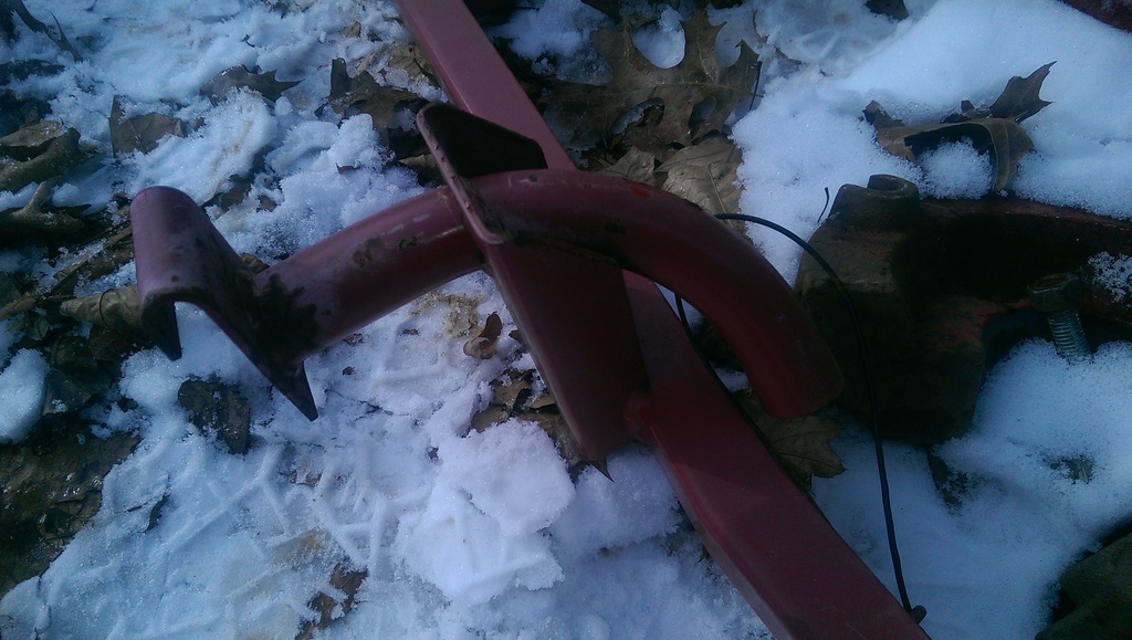

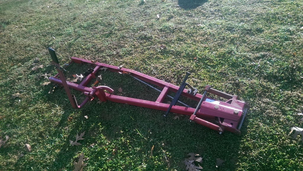

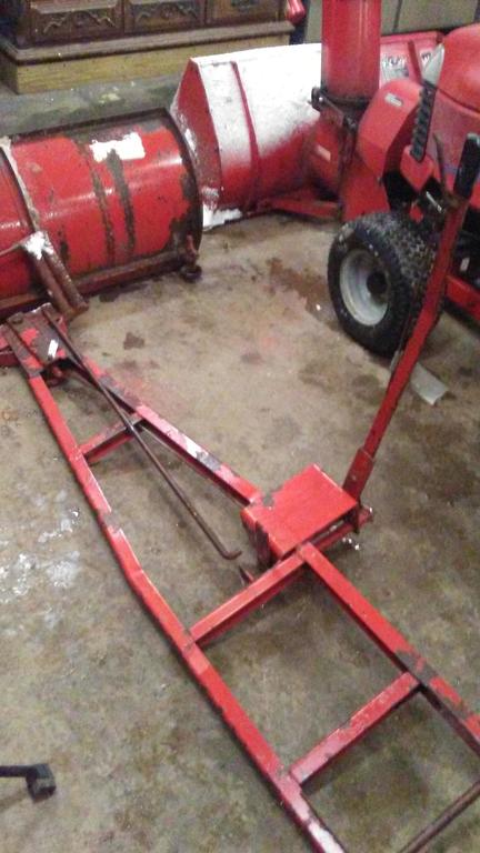

WVHillbilly520H 10,378 #11 Posted January 10, 2017 (edited) Ok the stabilizer bar is 3/4" diameter 13.5" long total 13" between 2, 1/4" thick washers welded to the ends that fits in the attach-a-matic, the rod that holds the blade frame is also 3/4" diameter (welded flush) 3.5" from one washer to flat then 2.5" from opposite end to bend is 7" long to center of bend then 8" long; the tang/bracket bolted to plow frame for sway bar is 14.5" from end of frame to first bolt then 1.5" bolt center bracket is 2.75" wide flat to flat 3" long flat to round edge with 7/8" diameter hole approximately 1" center from round edge ;now on the plow frame from center of rear attach rod to lift crossmember is 16" or 18" to center of lift bar and 29" to center of angle handle mount, 32" to frame taper/bend to center blade angle/pivot bolt is 72", also added a close up of that crazy angle lever mount, Jeff. Edited January 10, 2017 by WVHillbilly520H Share this post Link to post Share on other sites
Redisbest 22 #12 Posted January 12, 2017 Jeff...You exceeded my expectations.....Well done....I can make that old d series blade work now...With some plasma cutting and welding I will be in like Flint.....Thanks a ton... Jeff...In photo 4 the lift bracket is 16 to 18 inches from center of rear attach a matic...Is there 2 holes in bracket ? or one hole (16-18")...If there is one hole what is that dim from attach a matic rear rod to that and how high is hole(s) vertically from top of frame. I could also use dim from rear attach a matic rod to center pivot bolt on front of plow....Thanks again...What are the dimensions of the black lift bracket in photo ? Share this post Link to post Share on other sites

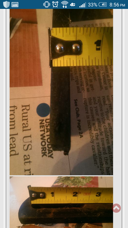

WVHillbilly520H 10,378 #13 Posted January 12, 2017 (edited) 13 minutes ago, Redisbest said: Jeff...You exceeded my expectations.....Well done....I can make that old d series blade work now...With some plasma cutting and welding I will be in like Flint.....Thanks a ton... Jeff...In photo 4 the lift bracket is 16 to 18 inches from center of rear attach a matic...Is there 2 holes in bracket ? or one hole (16-18") 16" TO CROSSMEMBER 18" TO CENTER OF LIFT HOLE...If there is one hole what is that dim from attach a matic rear rod to that and how high is hole(s) vertically from top of frame 1.5"? I'LL DOUBLE CHECK TOMORROW. I could also use dim from rear attach a matic rod to center pivot bolt on front of plow 71"-72" ....Thanks again...What are the dimensions of the black lift bracket in photo ? My answers above all caps, then your last question in pics below,Jeff Edited January 12, 2017 by WVHillbilly520H Share this post Link to post Share on other sites

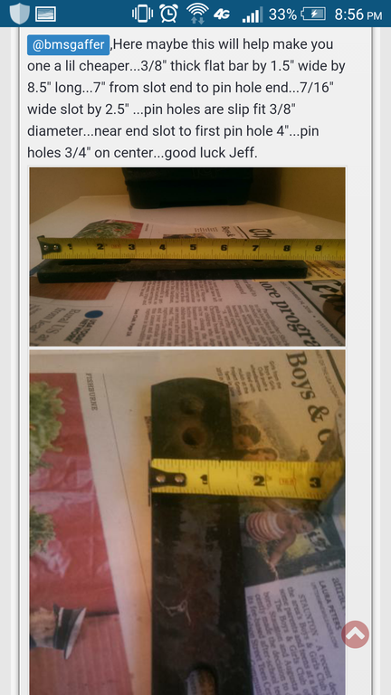

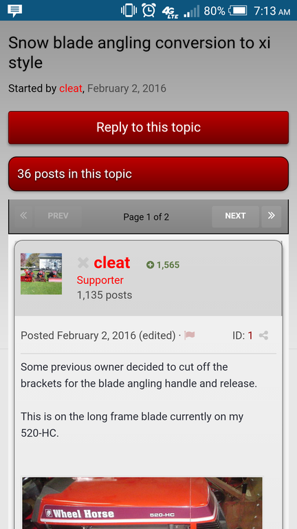

WVHillbilly520H 10,378 #14 Posted January 12, 2017 Also check out this post on making the xi style angle mechanism... Share this post Link to post Share on other sites
bmsgaffer 2,071 #15 Posted January 19, 2017 Here are the links to the info that Jeff posted: Share this post Link to post Share on other sites
