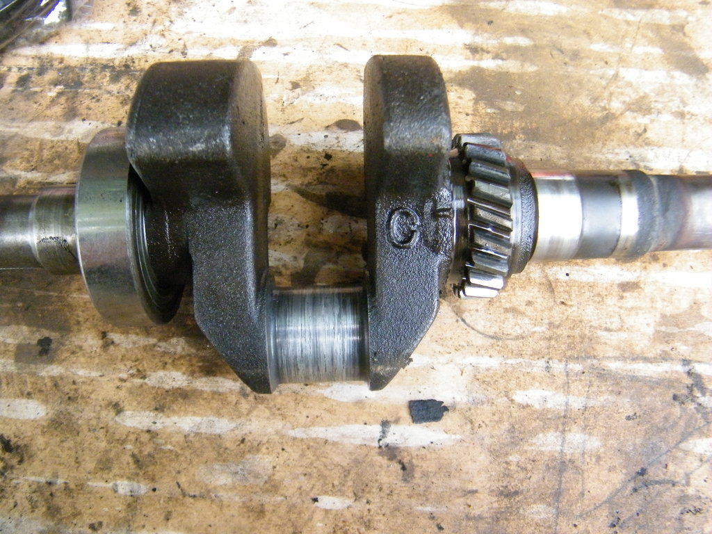

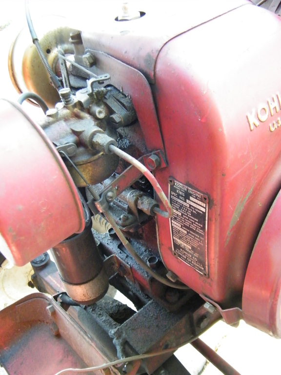

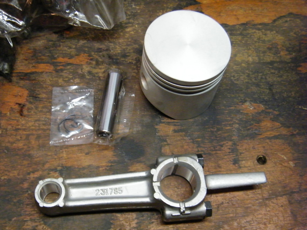

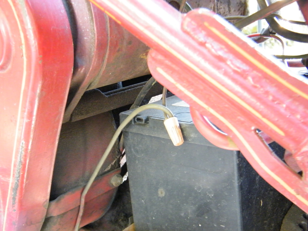

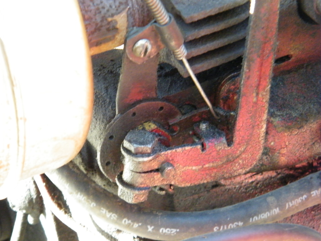

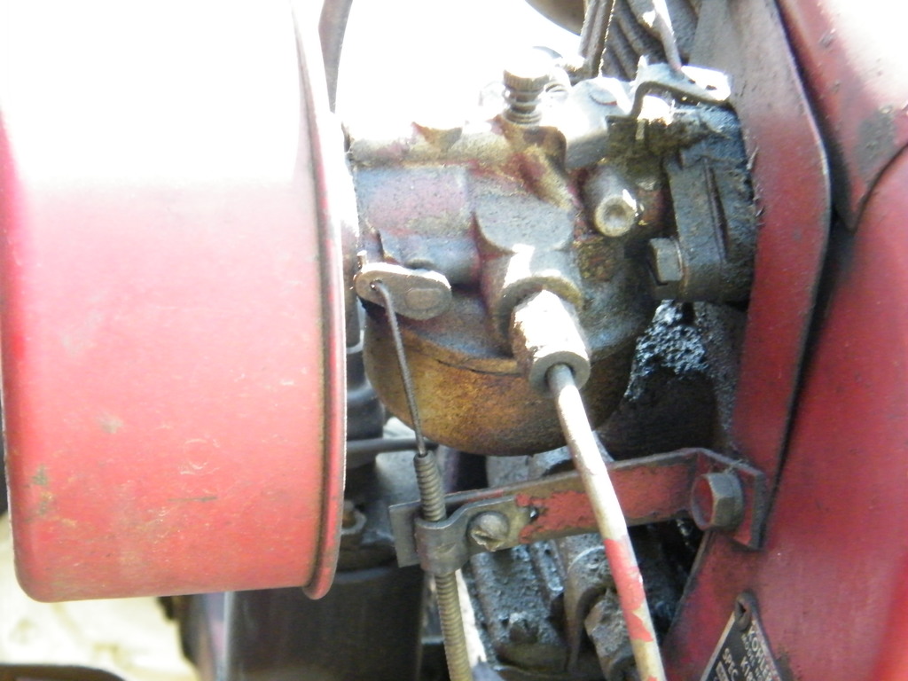

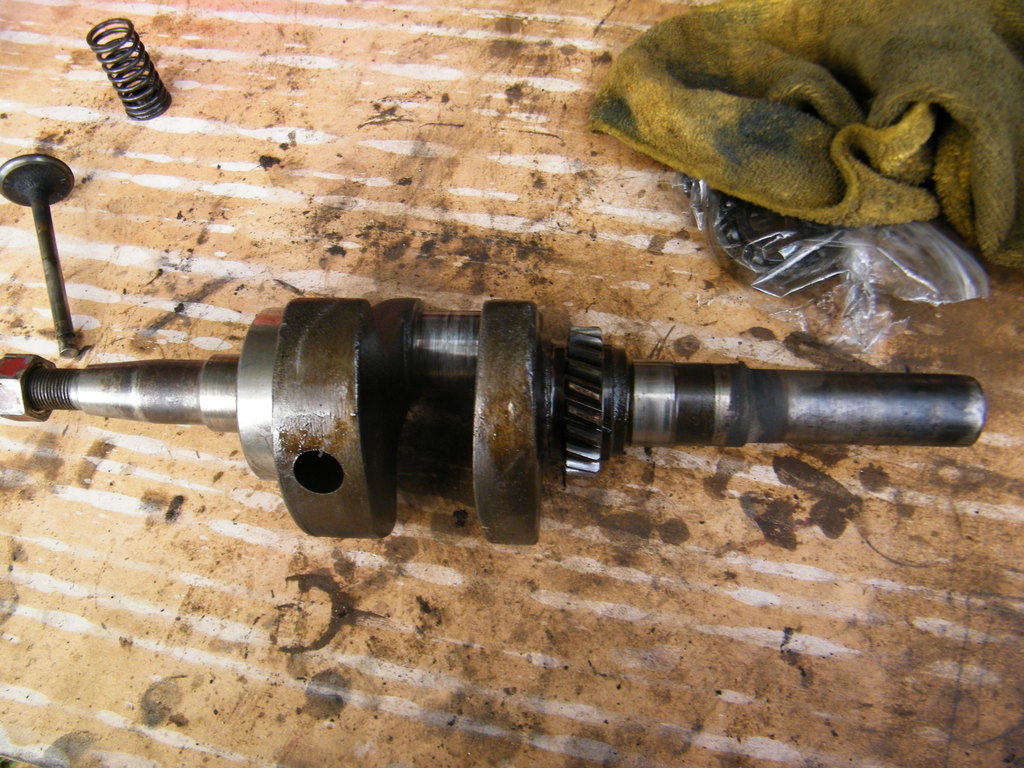

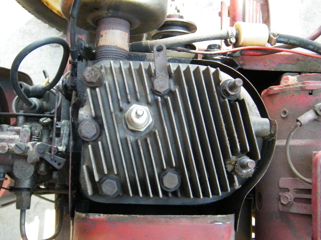

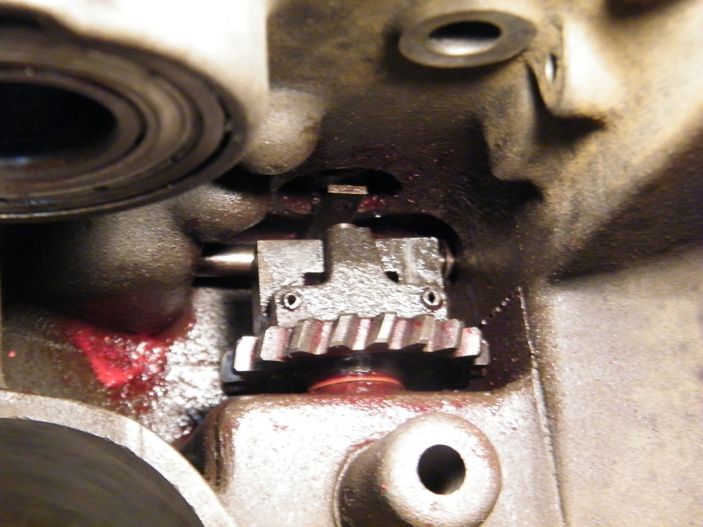

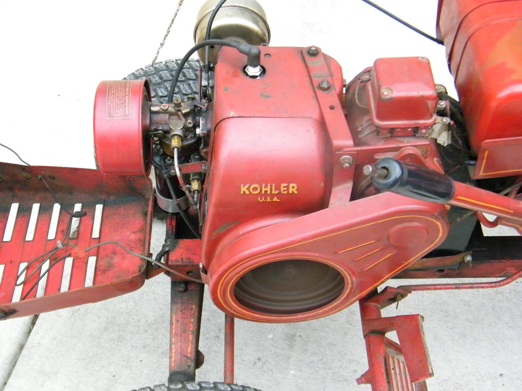

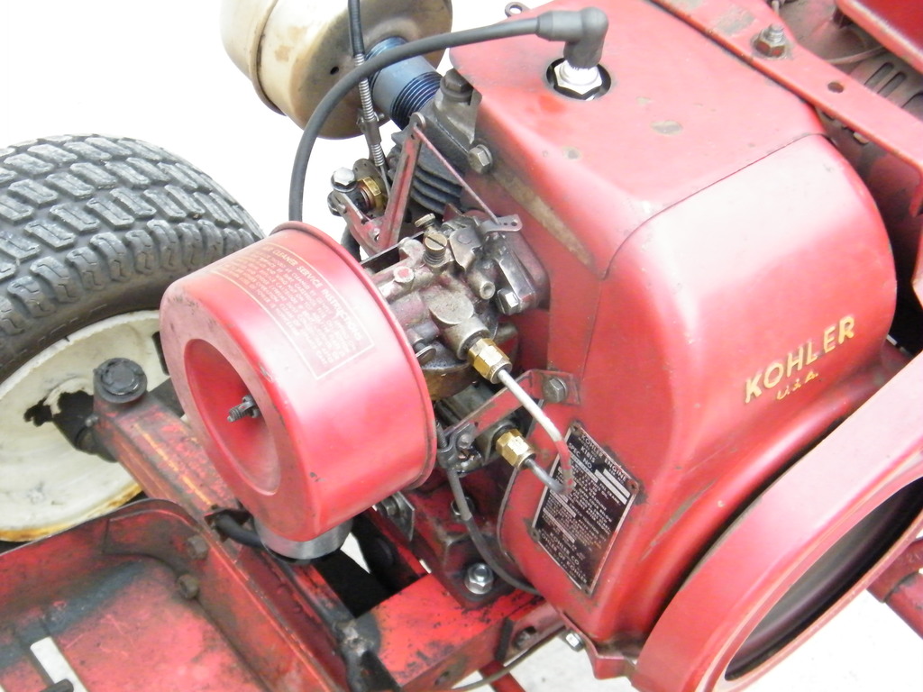

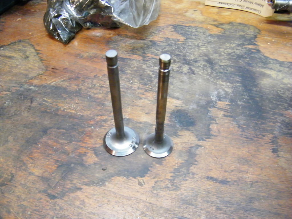

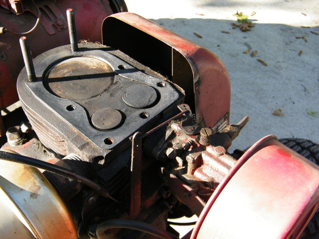

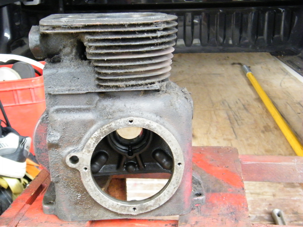

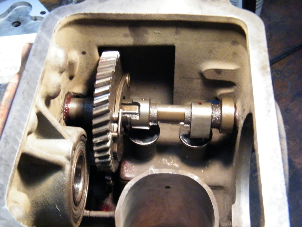

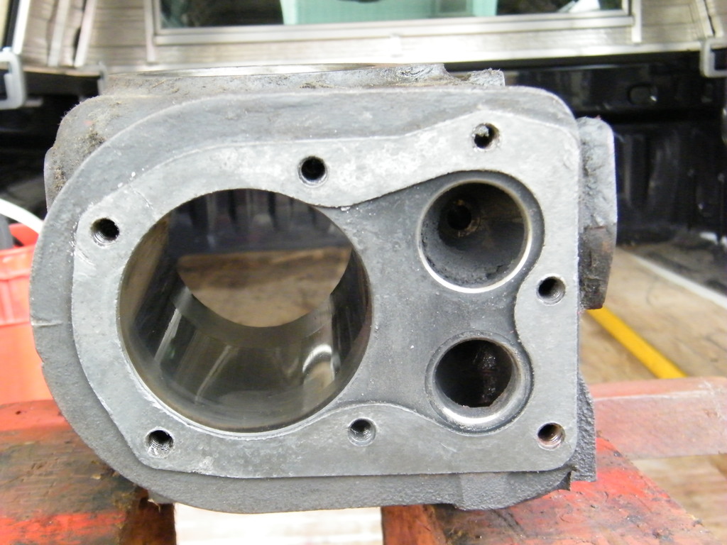

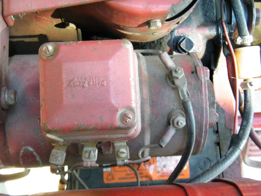

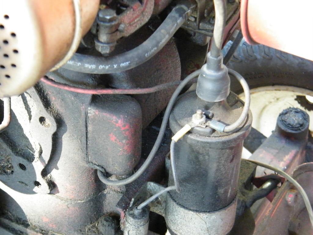

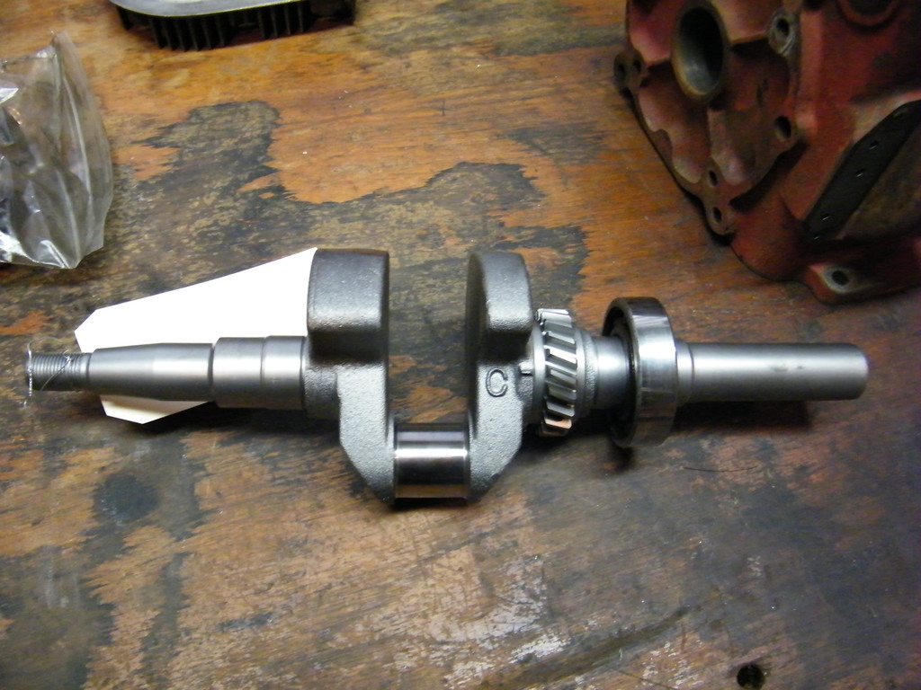

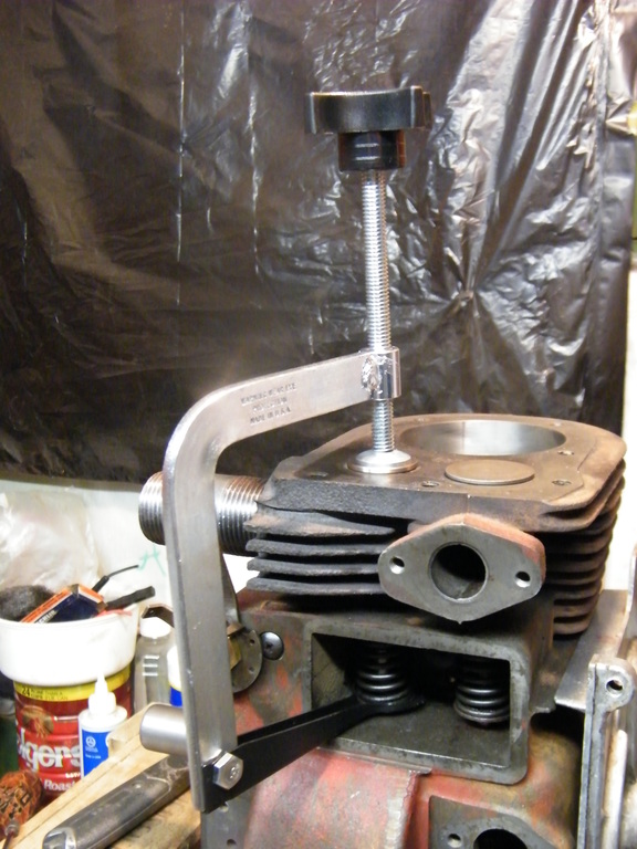

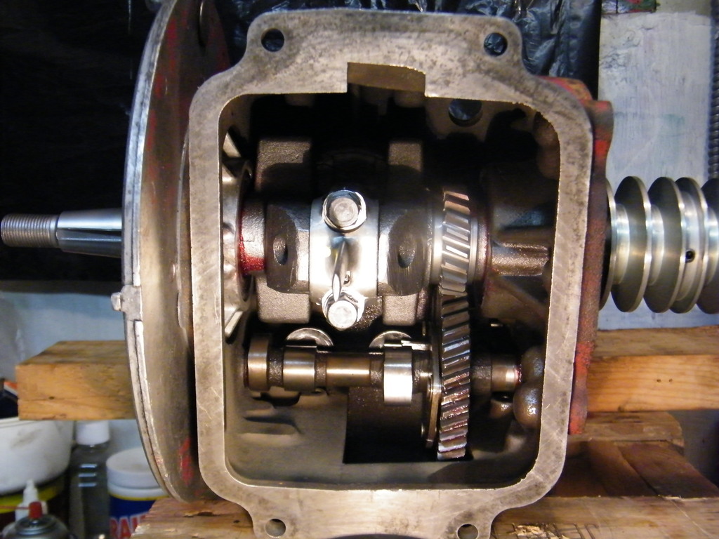

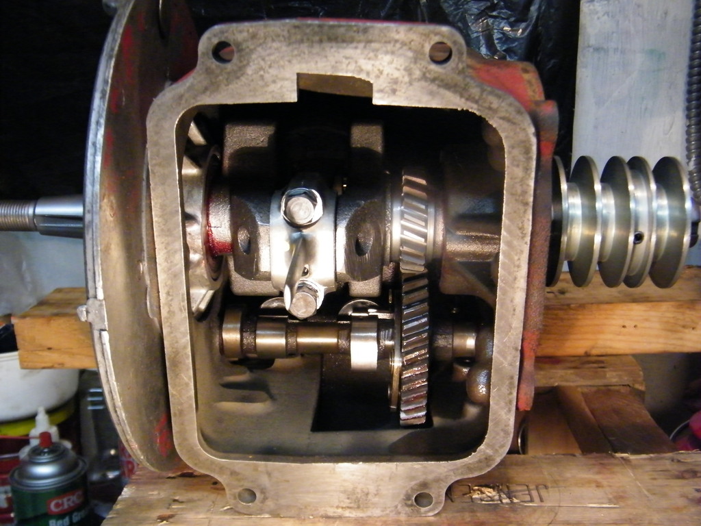

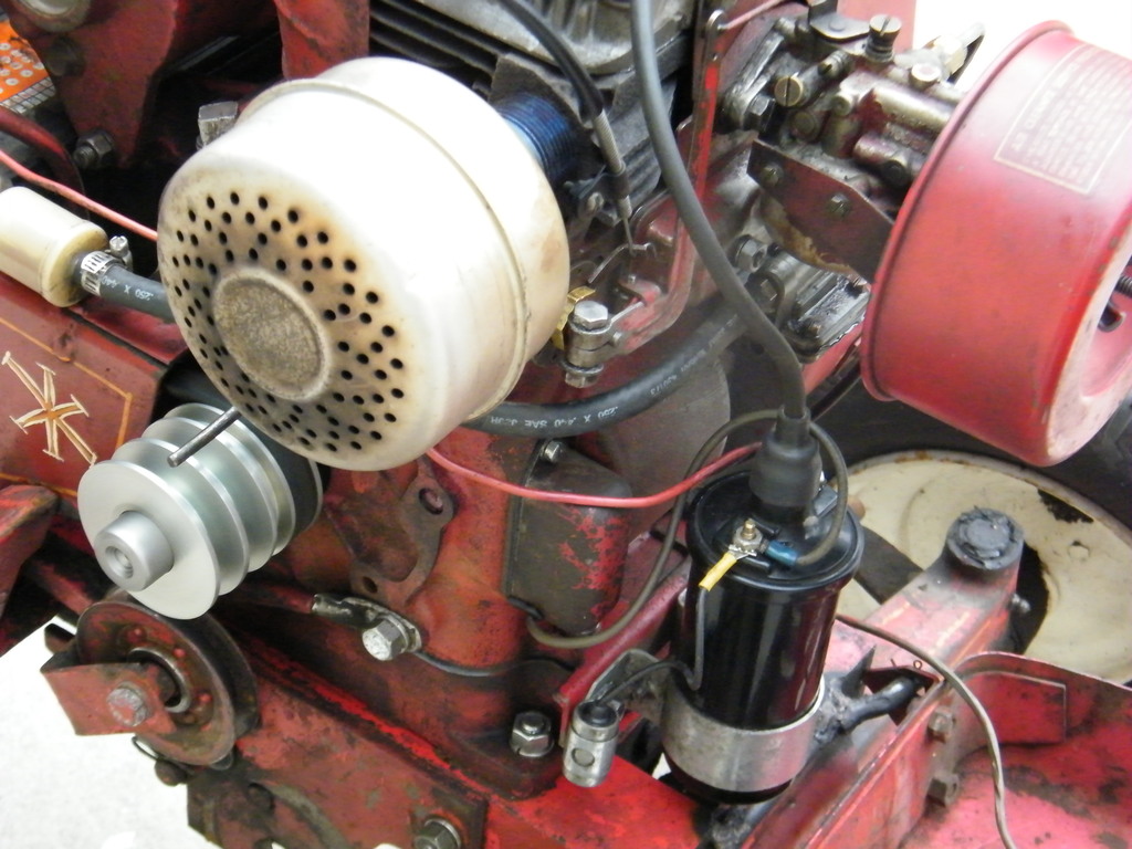

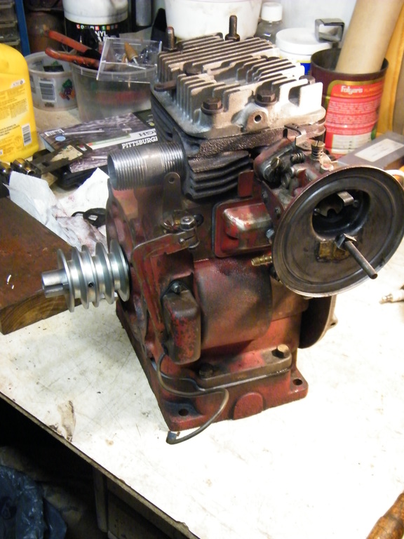

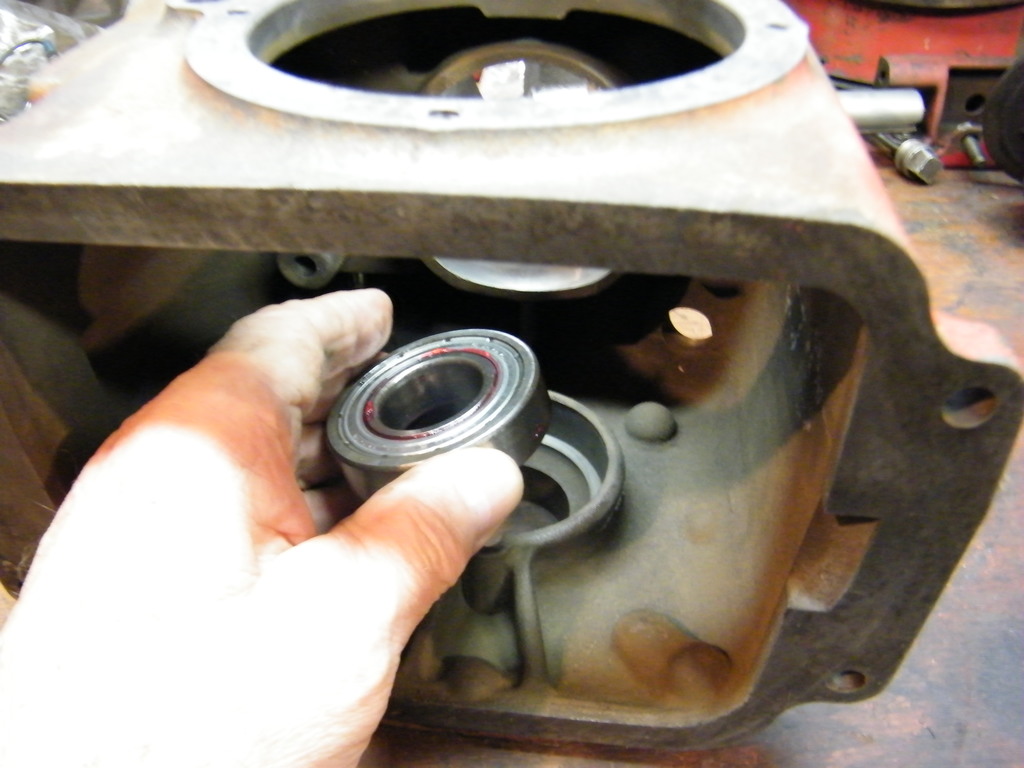

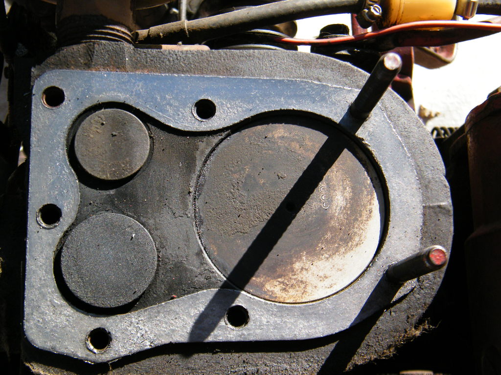

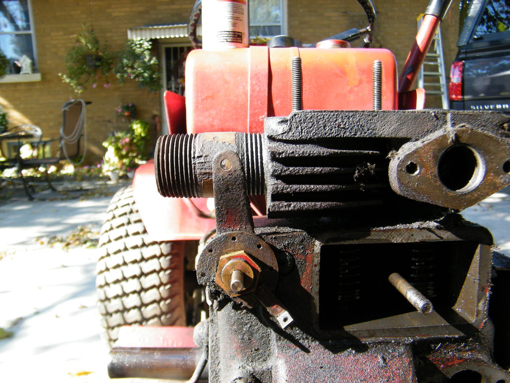

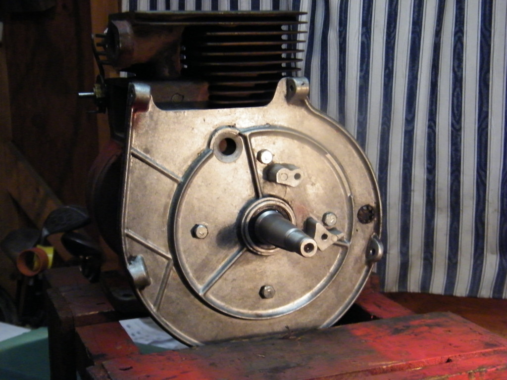

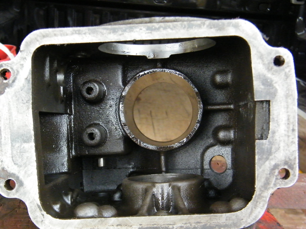

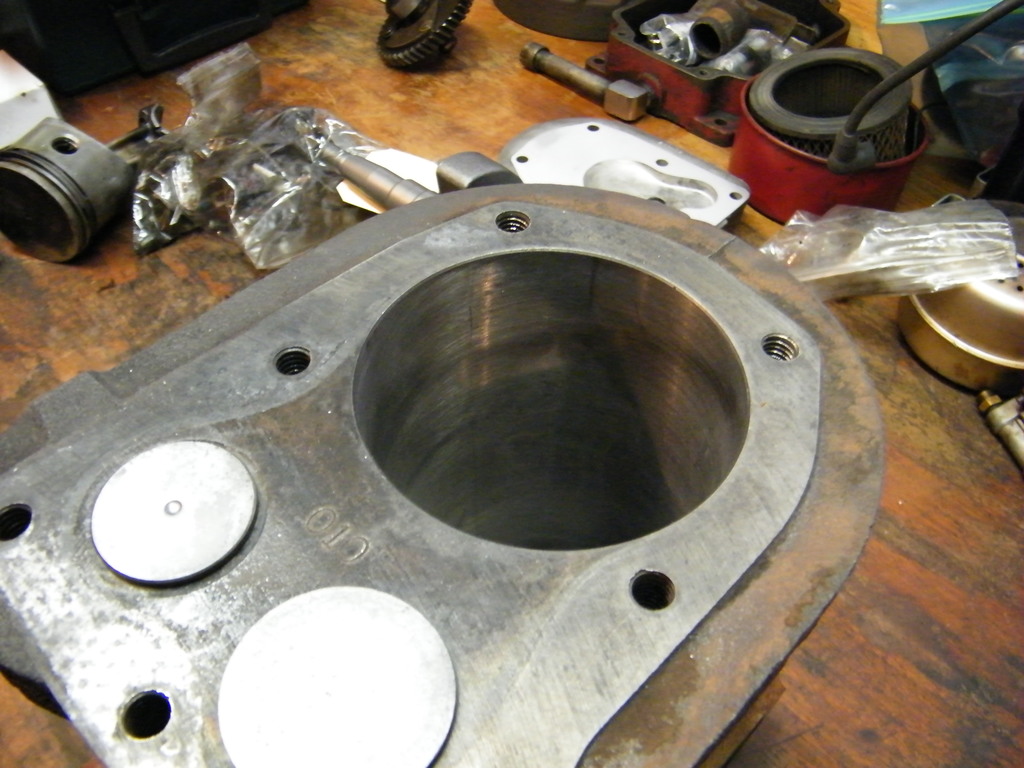

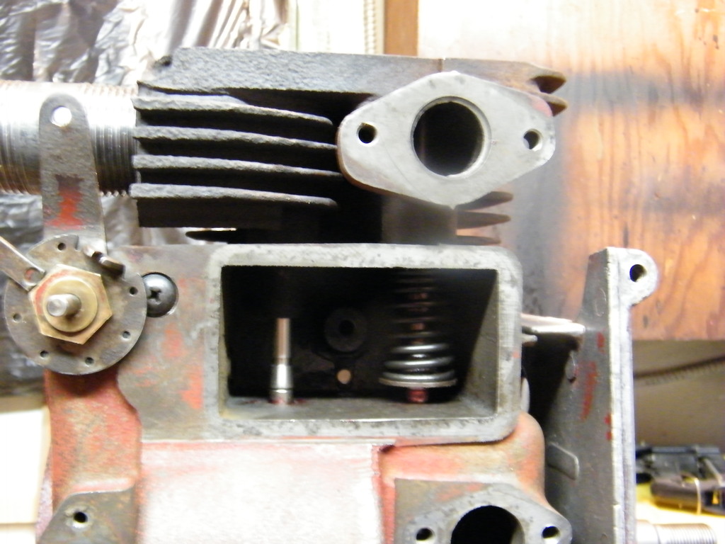

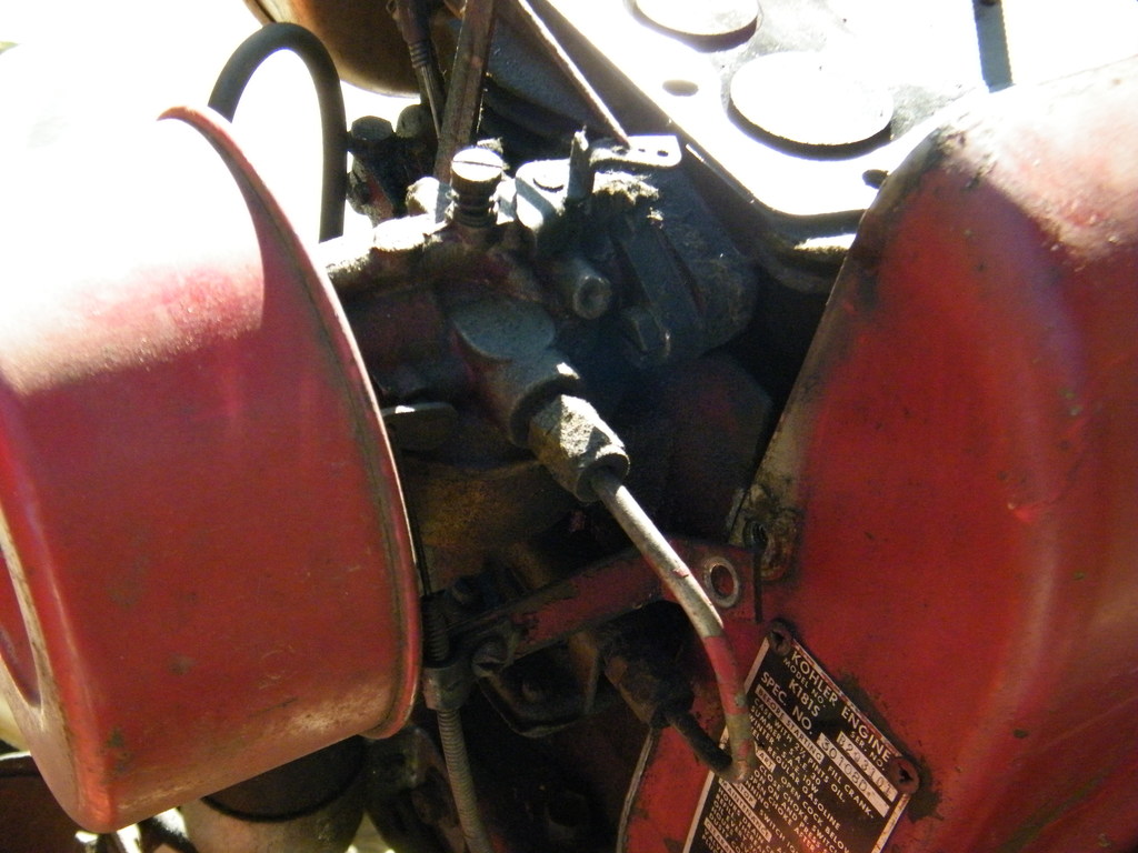

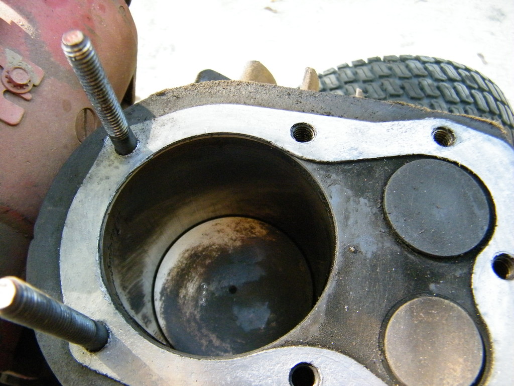

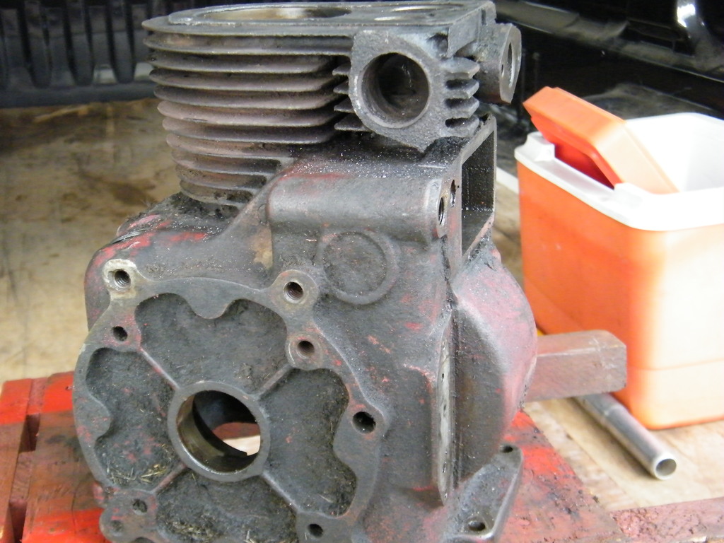

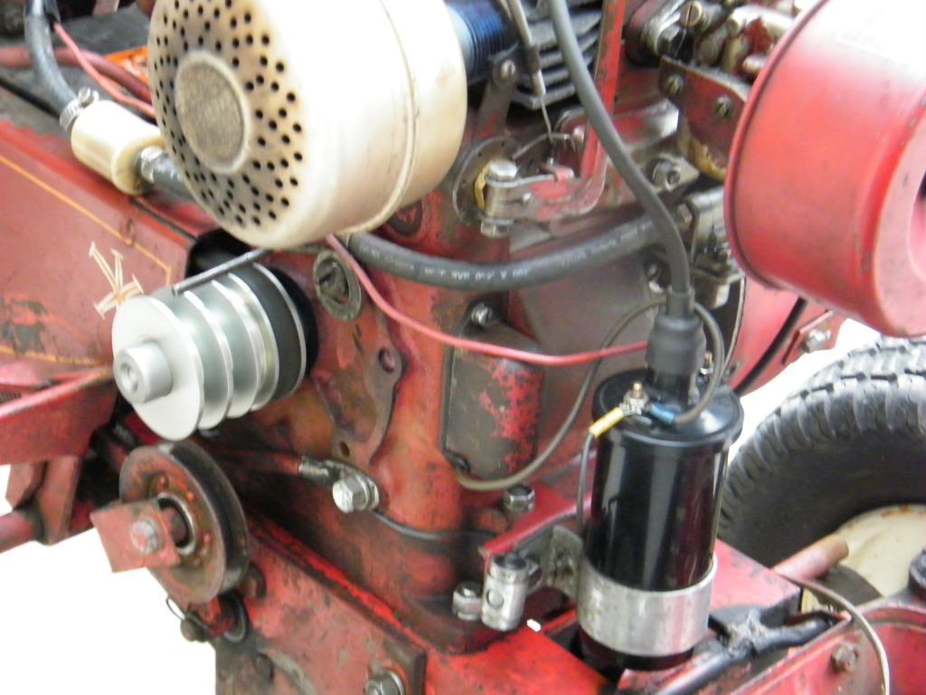

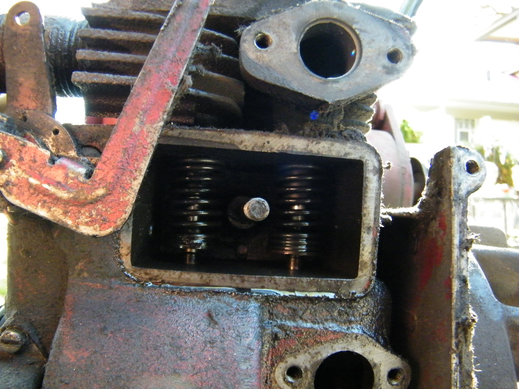

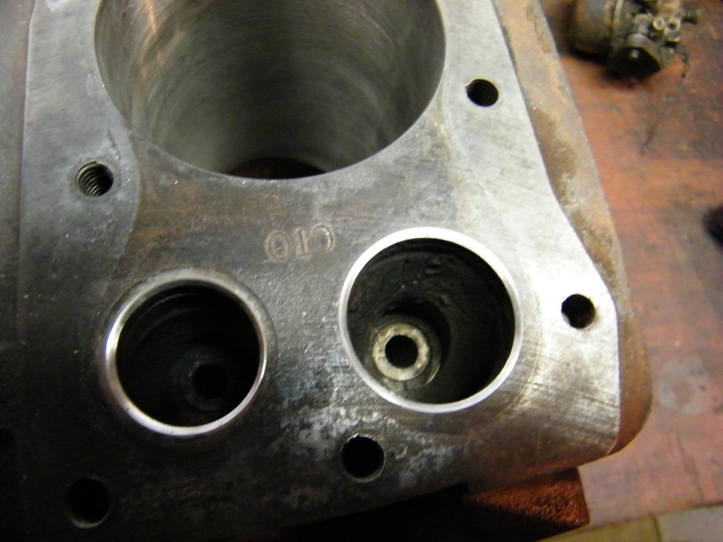

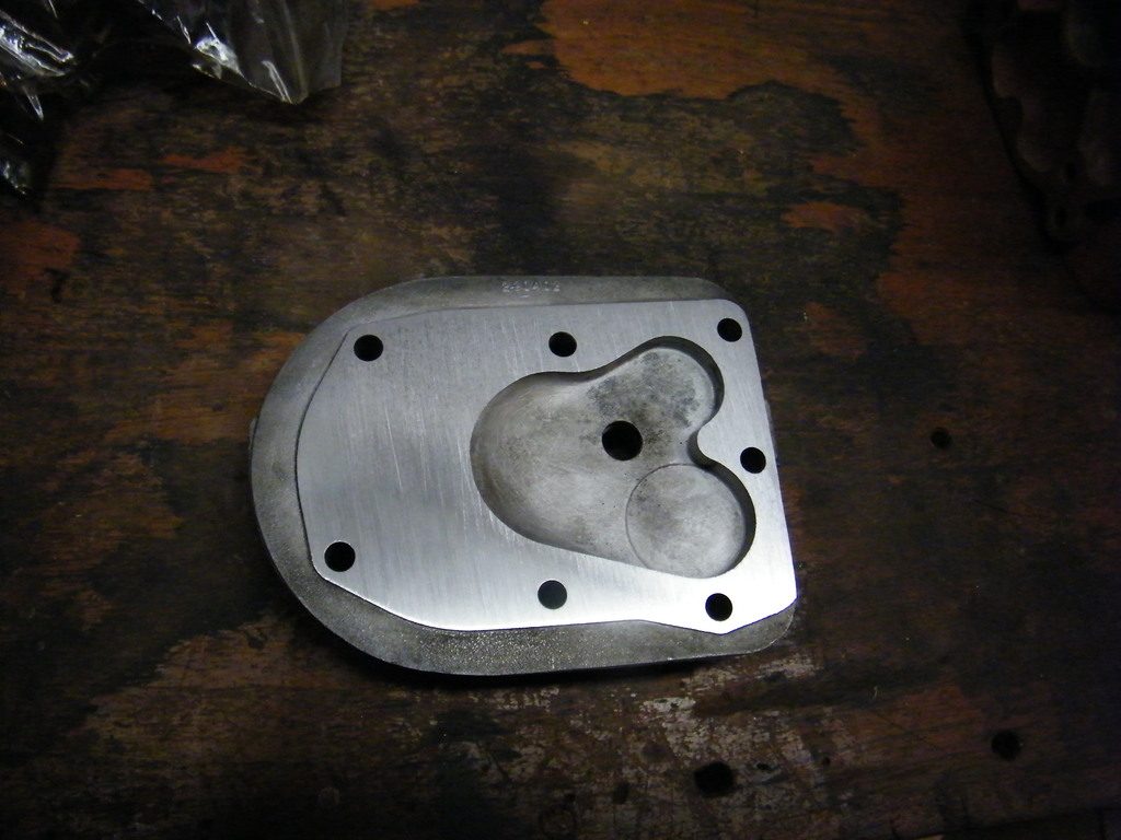

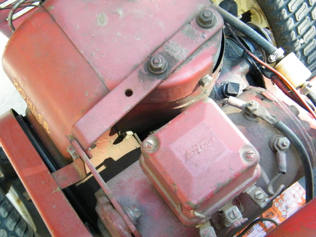

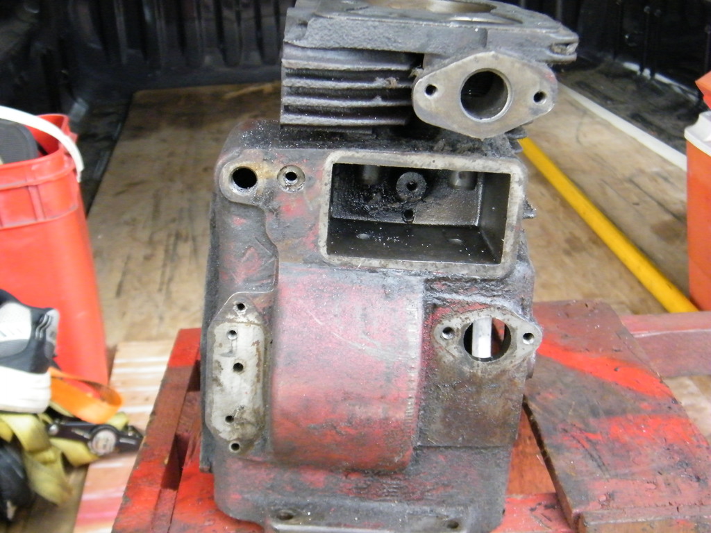

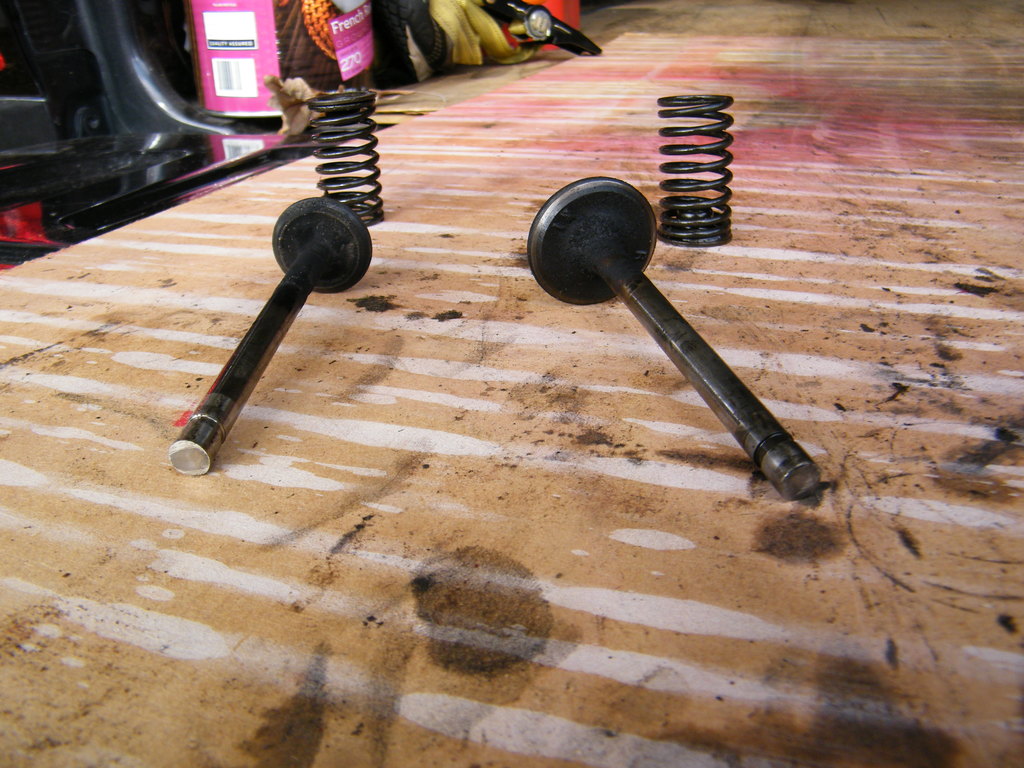

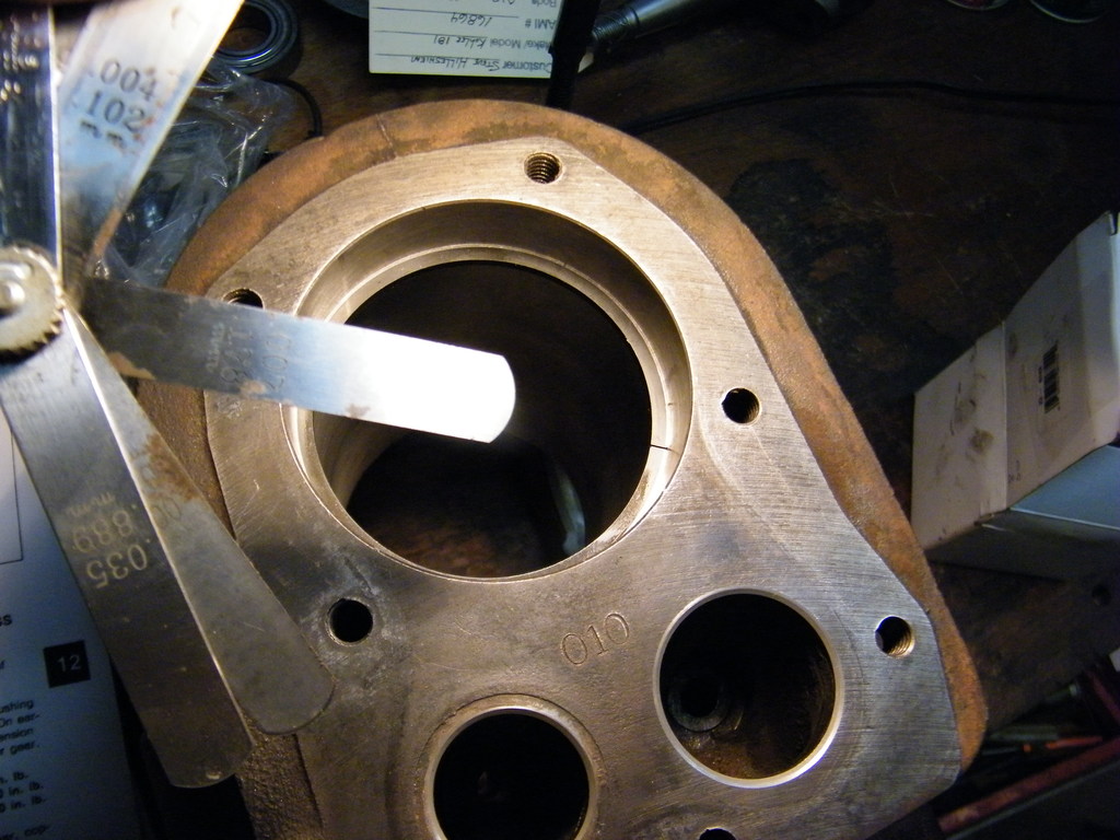

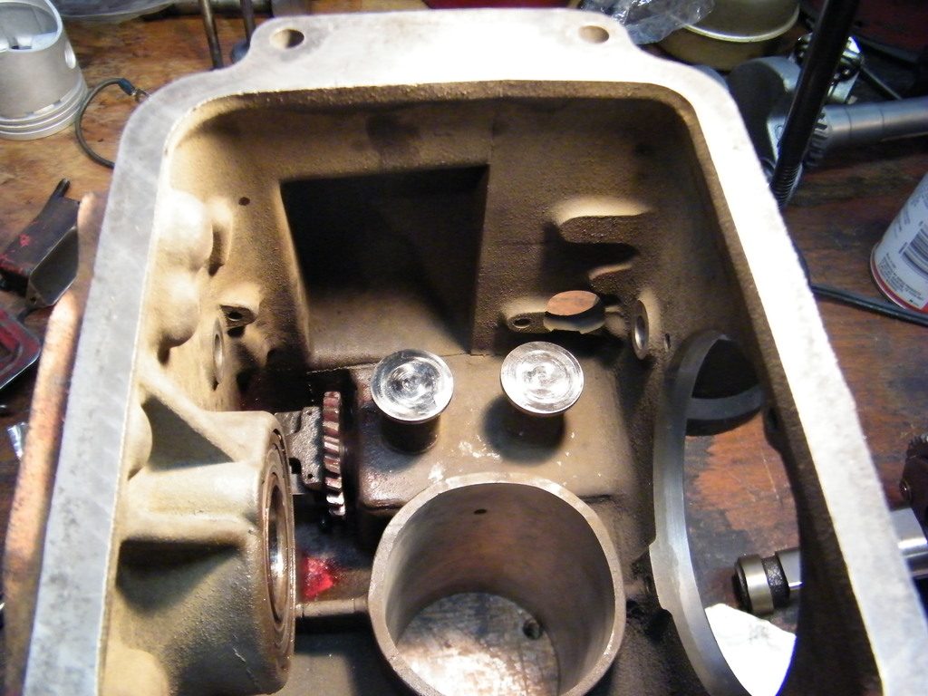

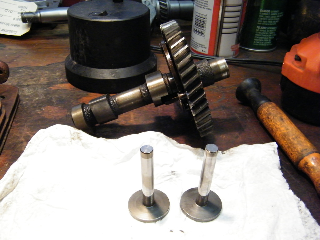

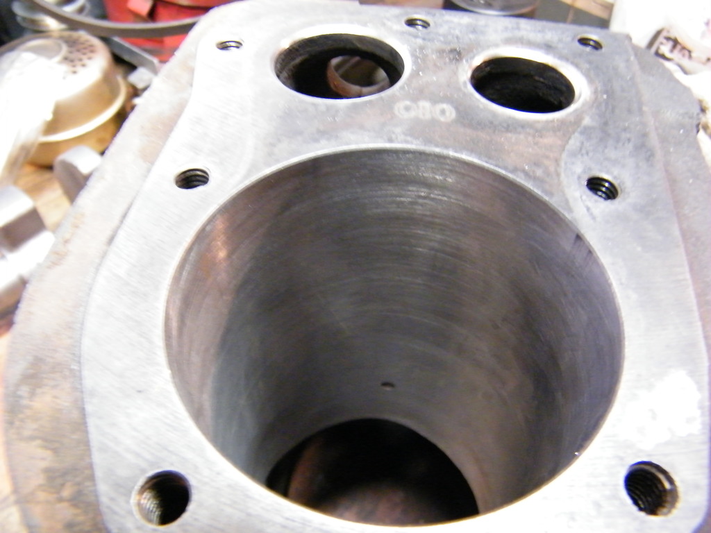

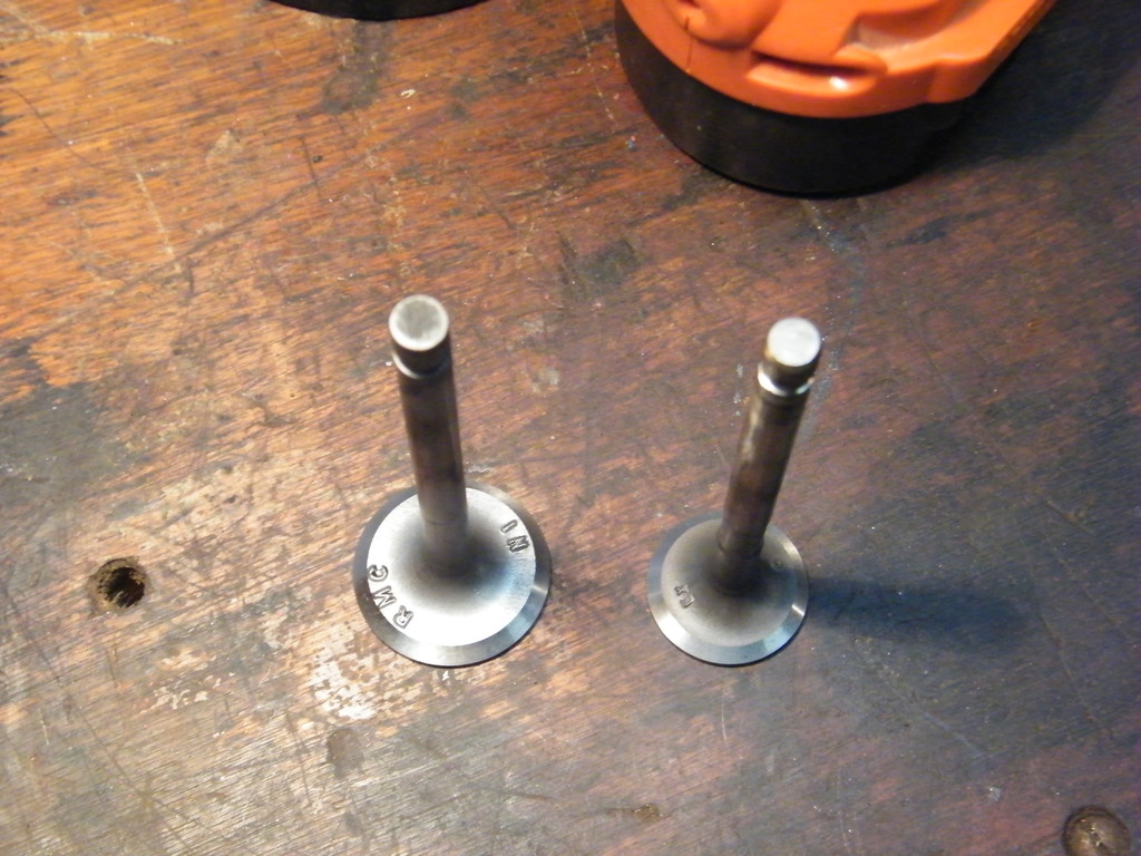

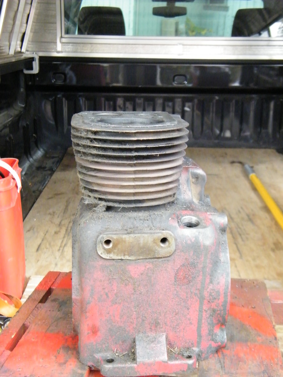

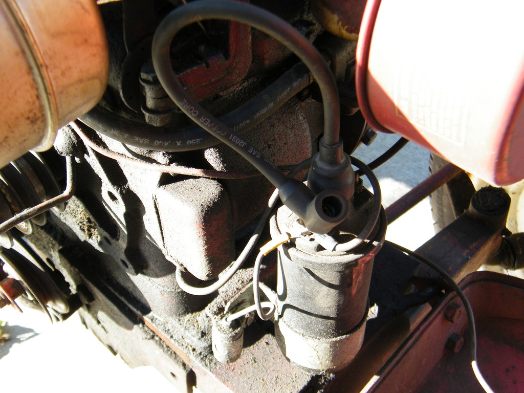

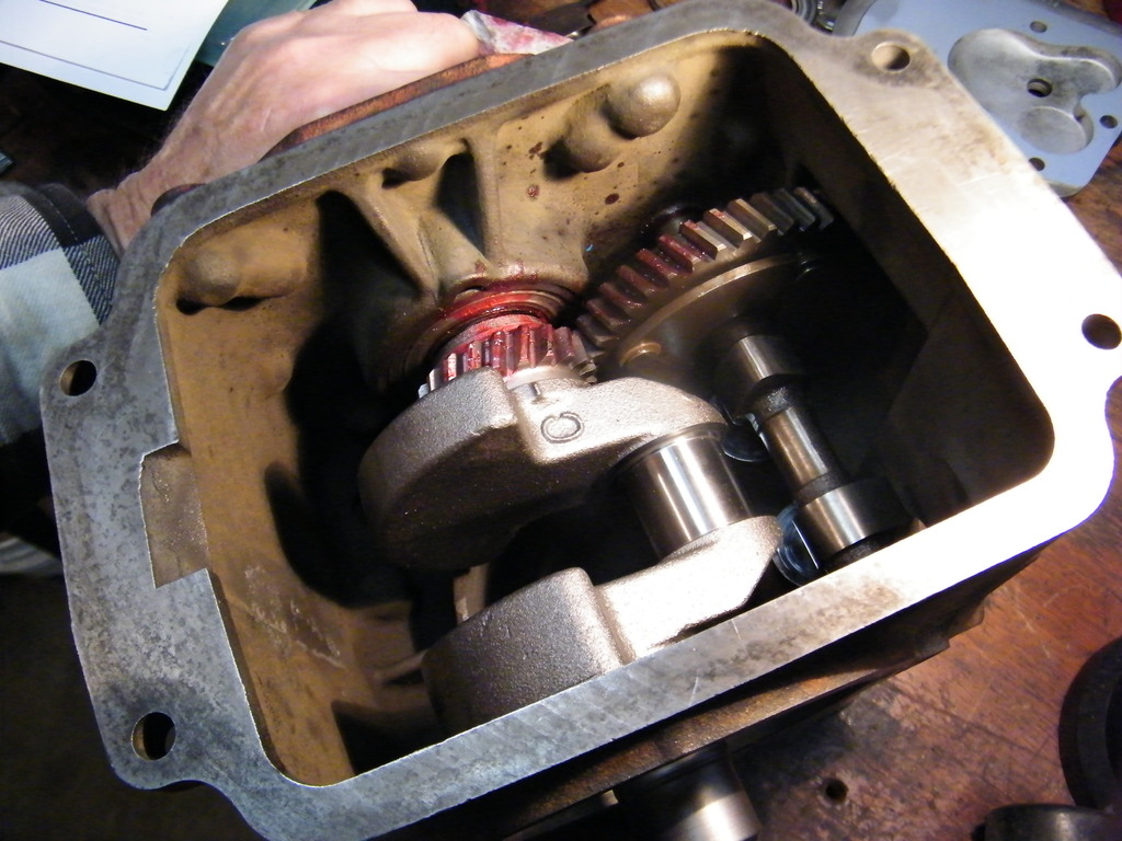

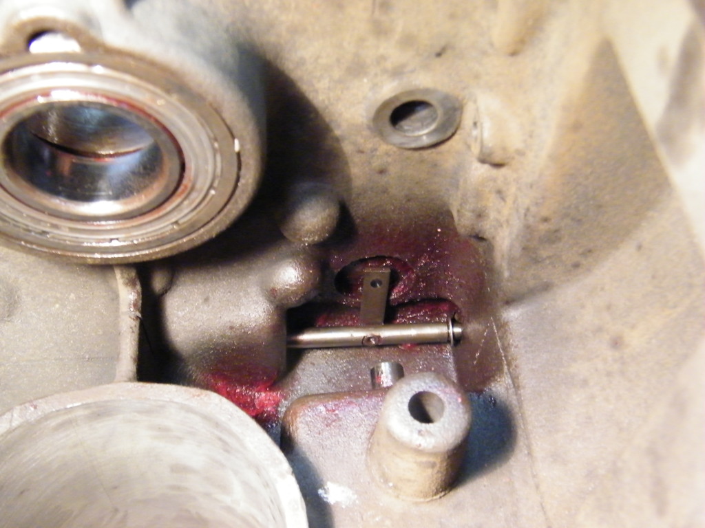

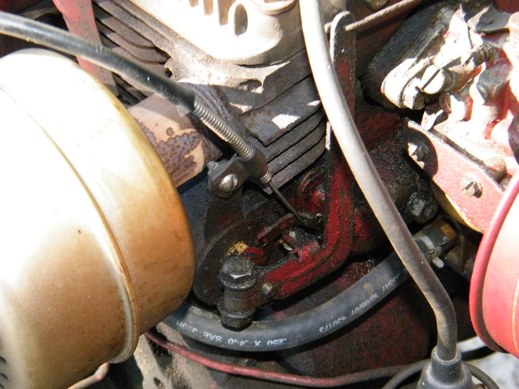

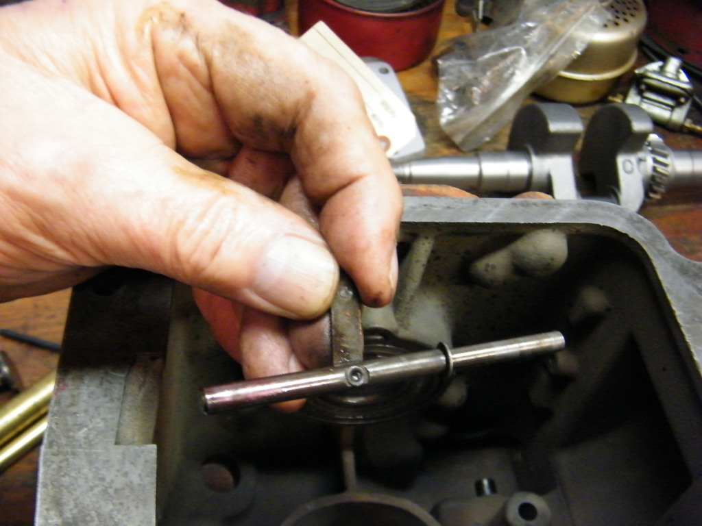

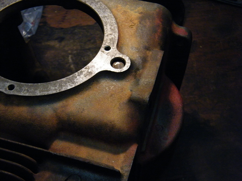

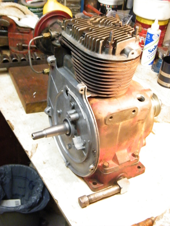

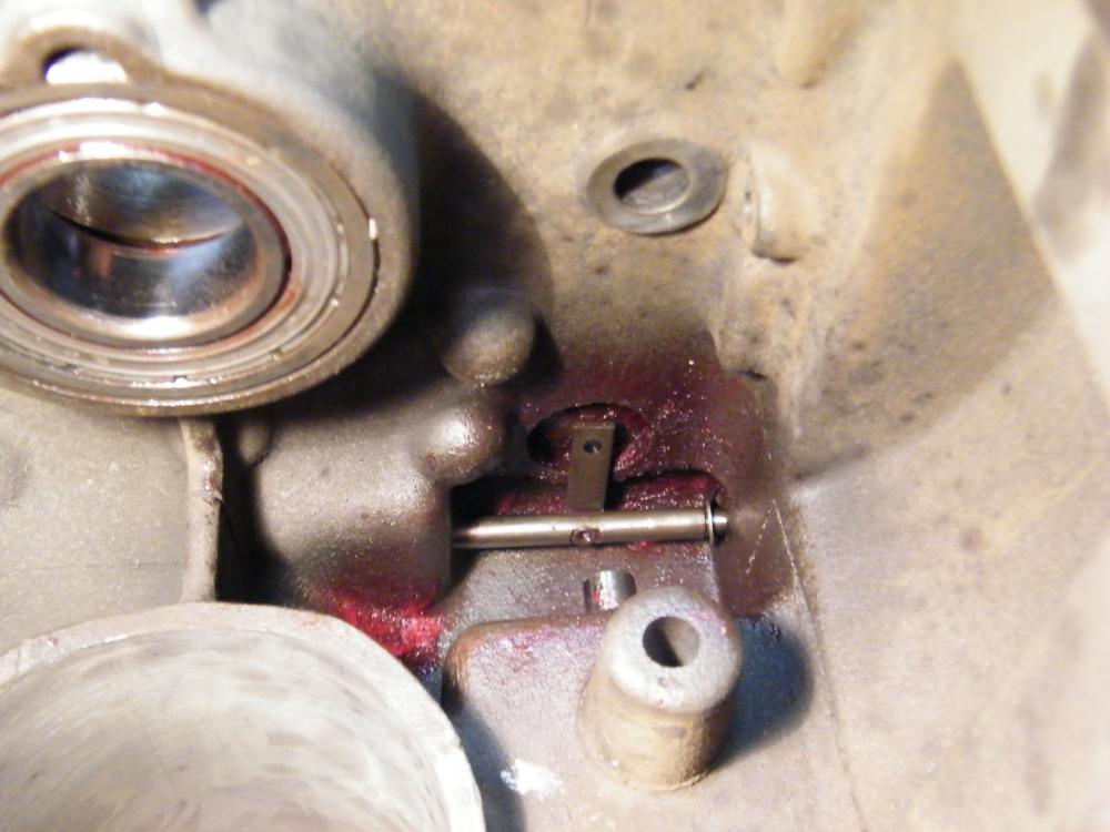

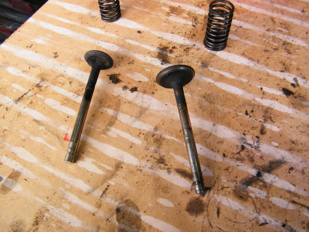

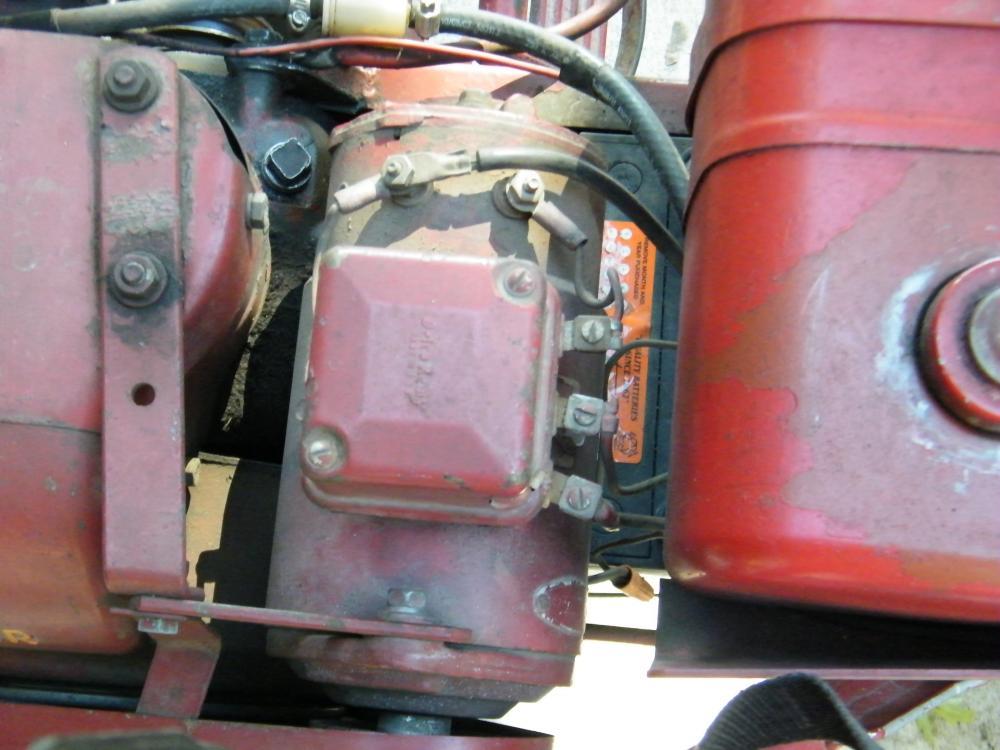

stevasaurus 23,567 #1 Posted January 9, 2017 (edited) I thought I would just post the pictures of what happened. I did not want to do a whole "How to" thread, as we already have some excellent threads out there. Prondzy's "How to Thread" was my inspiration...along with the Kohler Manual. Here is Mike's link... The manual is in the Manuals section. I am going to number the pictures so it is easier to talk about things...should there be questions or comments. Thanks Took pictures of linkage, gas lines, etc. to be able to put it back together. 1. 2. 3. 4. 5. 6. 7. 8. 9. 10. 11. 12. 13. 14. 15. 16. 17. 18. 19. 20. 21. 22. 23. 24. 25. 26. 27. 28. 29. Now we are looking at the parts cleaned, bored, etc...from the machine shop. 30. 31. 32. 33. 34. 35. 36. 37. 38. 39. 40. 41. 42. 43. 44. 45. 46. 47. 48. 49. 50. 51. 52. 53. 54. 55. 56. 57. 58. 59. 60. 61. 62. 63. 64. a short video of the new Kohler running. Edited January 9, 2017 by stevasaurus 18 Share this post Link to post Share on other sites

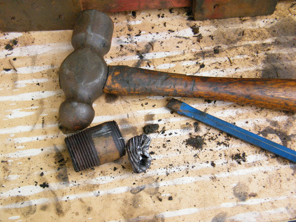

953 nut 63,911 #3 Posted January 9, 2017 Should be good for another 50 years. Did it throw a rod or just have a bad knock? I'm glad to see you needed to use a hammer to get that pesky nipple out; it was too serene up to that point. 3 Share this post Link to post Share on other sites

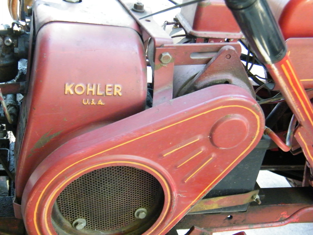

Stormin 9,987 #4 Posted January 9, 2017 Nice job as Chris says. I'd have painted it though before installing it. 1 Share this post Link to post Share on other sites
stevasaurus 23,567 #5 Posted January 9, 2017 (edited) One thing is the paddle broke off the piston rod. It also had a broken spring on the ACR...and the rings were by-passing oil. I don't know when the paddle broke off, but it caused the scoring on the crank shaft journal. Had that turned to .010 under. Norm, I did not paint it because it was my Dad's and he did the pin stripping on it. I wanted to save that and not have it look new and have to do the rest of the horse. I have another K 181 to do on my 876...I am thinking painting that one and a restoration. Edited January 9, 2017 by stevasaurus 8 Share this post Link to post Share on other sites

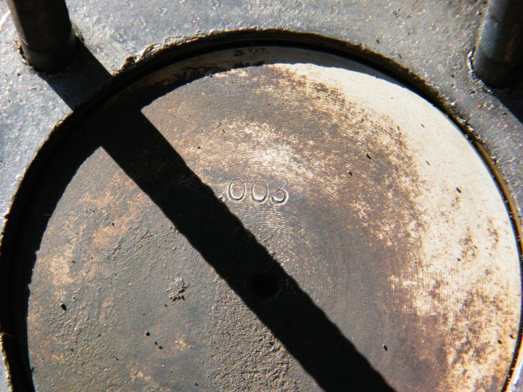

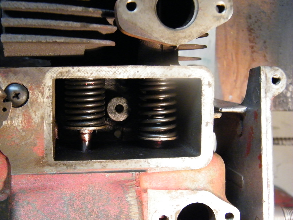

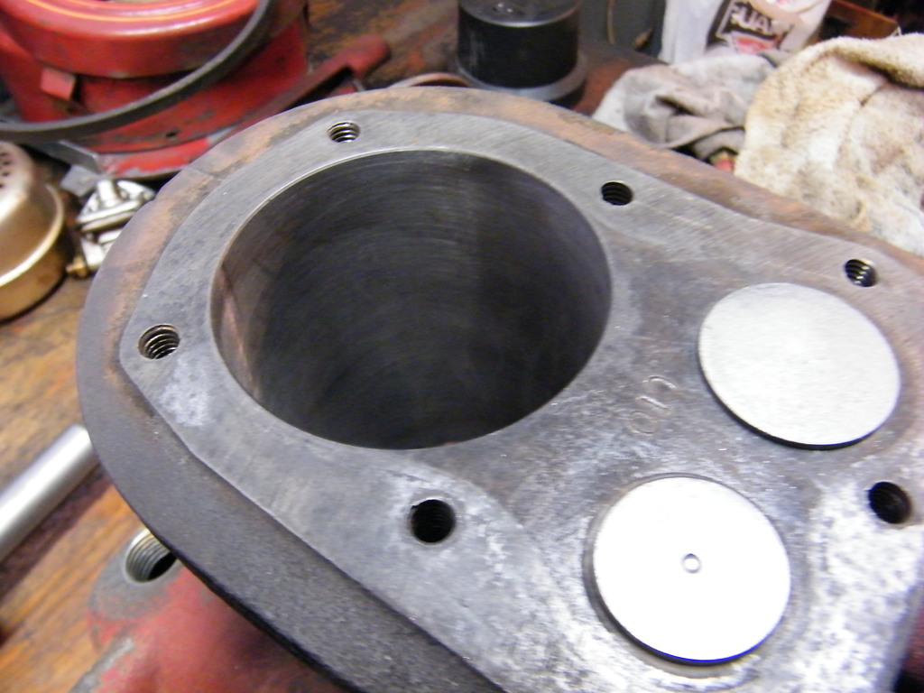

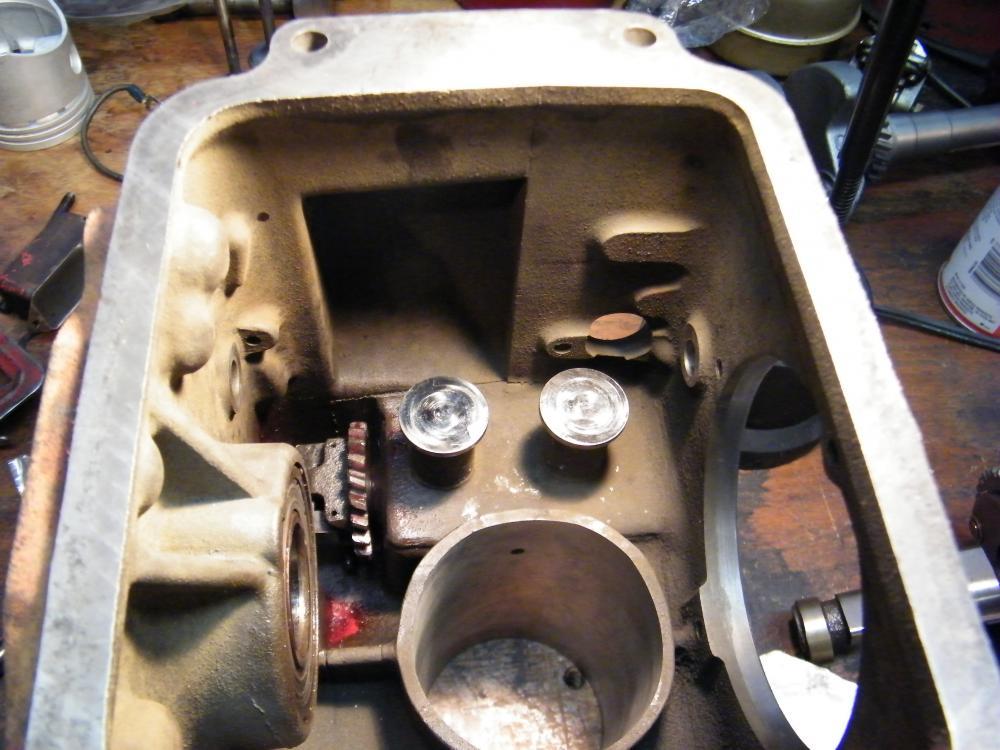

oldredrider 2,553 #9 Posted January 9, 2017 (edited) Good job Dino! Taking lots of pictures is one of the most important things you could have done as a first timer. Have a couple.if questions: Noticed you originally had the .003 piston installed. Did the machine shop stamp .010 on the block deck? Is that what the cylinder was bored to? Noticed tappets weren't marked for location after install. They are different lengths, did you get lucky reinstalling them? One final question: Do you have a final tally on what the rebuild cost considering you did all the labor? Again, great job on the photos and rebuild! Edited January 9, 2017 by oldredrider 6 Share this post Link to post Share on other sites

can whlvr 994 #12 Posted January 10, 2017 nice job steve,i too was curious about the ,010 stamp and the 30 thou piston,did you hone and put a 30 back in,usually the stamp on the block means the crank has been turned,curious minds want know 1 Share this post Link to post Share on other sites

squonk 45,366 #15 Posted January 10, 2017 (edited) I have seen many Kohler rods have hairline cracks at the oil dipper. I have sen a lot of damage from them. looks like you caught it in time. When rebuilding a Kohler, get that rod checked even if it looks good. Edited January 10, 2017 by squonk 7 Share this post Link to post Share on other sites

stevasaurus 23,567 #18 Posted January 10, 2017 Thanks guys. @oldredrider , this block had the .003 piston...the manual talks about that they either came STD or .003 from the factory...might have had something to do with the bore. Anyway, the machine shop bored the cylinder to .010. They also turned the crank journal to .010 under. I bought the piston .010 and the piston rod .010 over on E-Bay. The machine shop stamped the .010 on the block...I'm not sure if that means the cylinder or the journal. The piston did not have a stamp on it...nor did the rod. The machine shop charged me $119.34 their work and they ground the valves also. The parts on E-Bay were like $85. I did buy a few tools, but I don't count that. I did have the tappets marked, but I knew the shorter one was the exhaust. 5 Share this post Link to post Share on other sites
oldredrider 2,553 #19 Posted January 10, 2017 The mark on the deck represents cylinder bore. Now anyone who pulls the head off will know what size piston is in it. 1 Share this post Link to post Share on other sites
