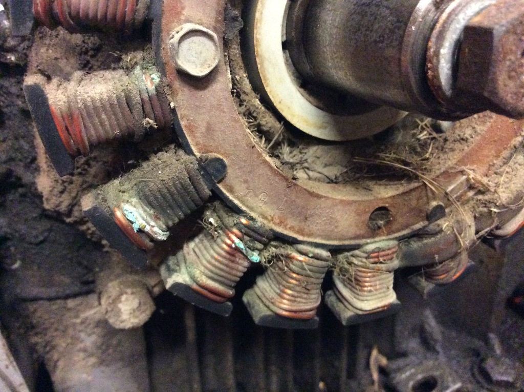

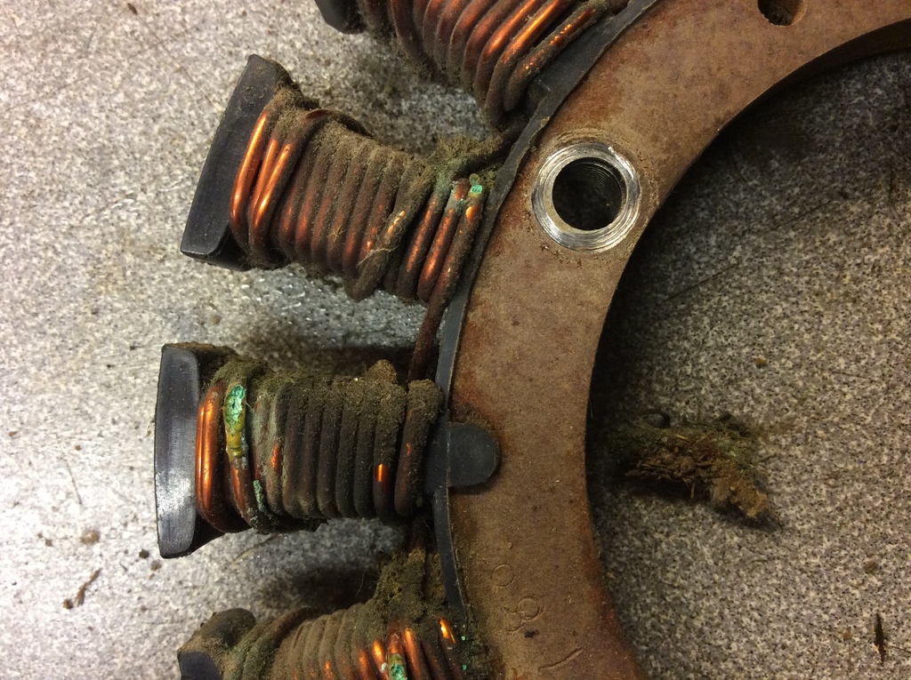

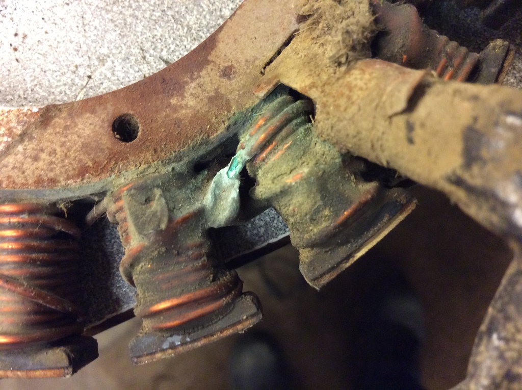

Actonhorse 26 #12 Posted January 4, 2017 So. Stator it is First a pic of the tractor Then some pictures of the bad stator. The copper is supposed to be a continuous winding and this one has several breaks due to corrosion. I'm not sure how that happened but im thinking it is just time. And one of the backside. There are more bad spots but this definately explains the charging problem. Now to fina a new one and a Regulator. So. Stator it is First a pic of the tractor Then some pictures of the bad stator. The copper is supposed to be a continuous winding and this one has several breaks due to corrosion. I'm not sure how that happened but im thinking it is just time. And one of the backside. There are more bad spots but this definately explains the charging problem. Now to fina a new one and a Regulator. 3 Share this post Link to post Share on other sites

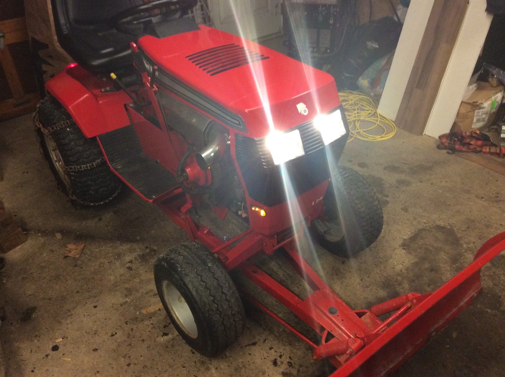

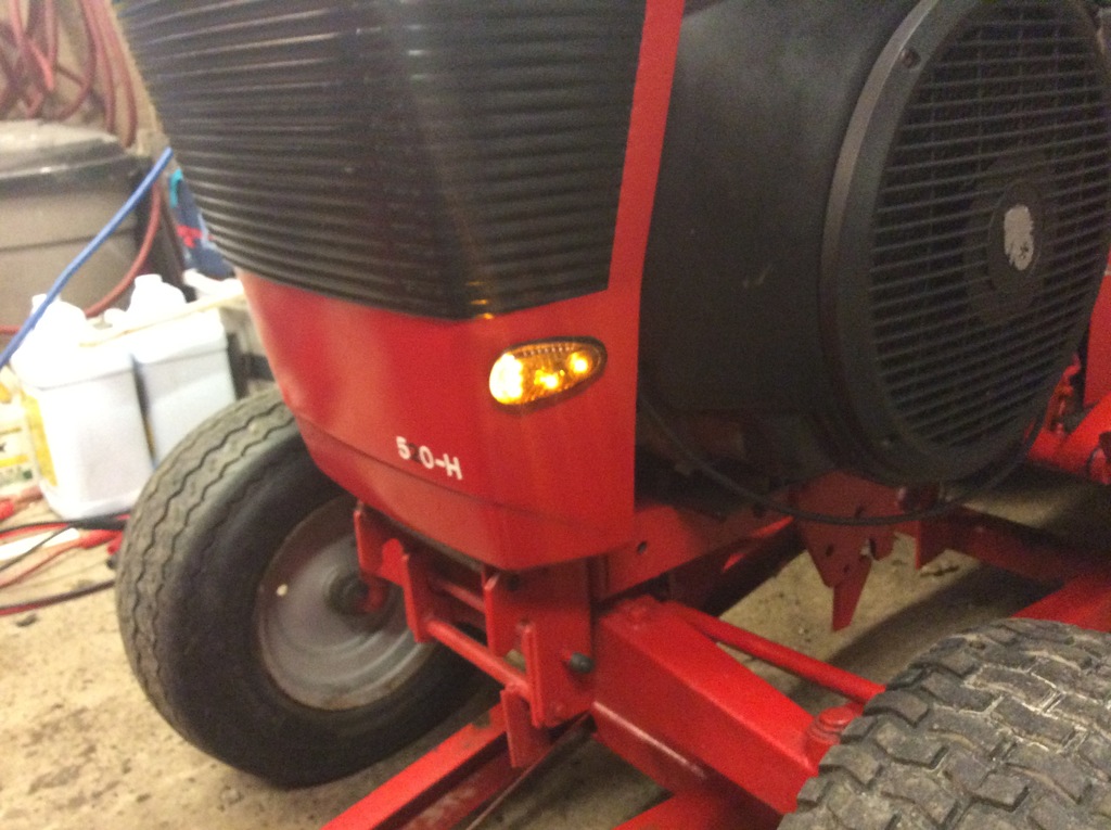

cleat 9,103 #15 Posted January 4, 2017 That is quite an unusual decal set on that tractor. Are those small lights near the bottom of the hood ? Good looking 520 Cleat 1 Share this post Link to post Share on other sites
GlenPettit 1,719 #16 Posted January 4, 2017 ActionHorse: Could you also post photos of the sides and rear of your 520, I would also like to see those side-lights and decals. Very nice looking tractor modifications, and your closeup photos and descriptions (thread subject) is very helpful & timely. Glen Share this post Link to post Share on other sites
Ed Kennell 46,798 #17 Posted January 4, 2017 A lot of posts available on keeping the rear cylinder cool. Oil filter base gasket leaks, oil filter to tin seal, belt guard vents etc. Share this post Link to post Share on other sites
Actonhorse 26 #18 Posted January 4, 2017 I'm always amazed at the detail you guys notice on these tractors! The PO is a body and paint man at a shop I have used over the years. He called me just before Christmas to see if I would be interested in this tractor and of course I said yes! He had given the body a paint job about 10 years ago - not a full off restoration just a refresh and had their shop decal person make him a set of decals that he thought worked. He also installed the tear drop lights along the bottom of each side of the hood. They look very cool at night! If you look close at the side of the hood he also did some custom pin striping. And yes, he did tell me it wasn't keeping the battery charged but didn't know what was wrong - I knew what I was getting into! Glen: I'll post some more pictures of it tonight. 1 Share this post Link to post Share on other sites
Actonhorse 26 #19 Posted January 8, 2017 So, it was a good day. I have the 520 back together and charging. I haven't been able to get a replacement stator so I spent the day degreasing and cleaning the motor. Changed the oil, new plugs etc. I got to the point that I needed the stator so I started looking around my parts pile. I found a stator off of a Koehler single cylinder that came on an engine that had a broken rod and the block is cracked. After examining it it is almost exactly the same as the Oman. 18 poles, same bolt pattern. Just a slightly different winding-probably 15 amp. The leads come off it in a slightly different spot as well but with a slight modification it fit. I got it all together and checked the output and I have about 45 volts ac across the leads! Once I had the rectifier regulator hooked up I am getting 14.7 at the Center terminal! It might not be the correct stator but it looks like it is working. You guys can tell me if I'm doing something that will hurt the tractor. Oh and a bonus is the tach and voltmeter are both working again. Still no hour meter but tomorrow is another day. Here is is a picture of the tear drop lights on the front of the hood. 2 Share this post Link to post Share on other sites
