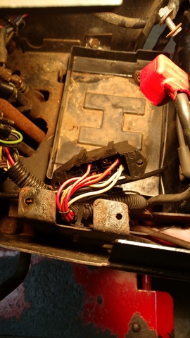

I would like to eliminate the current fuse block in my 1995 520H. I have a wiring diagram. It looks like the wires were tampered with but I'm not sure.  Suggestions about why both white wires are on the 30 amp block. The 25 and 30 amp blocks are connected with a bridge. I'm not sure how to wire these individually. The 30 amp fuse was melted.

I looked at it some more. I may have spoke before I thought about it. I'll post some pictures  of the finished job tomorrow. :wacko:

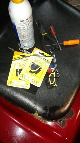

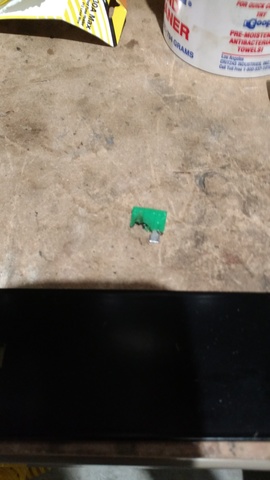

I looked at it some more. I may have spoke before I thought about. I'll post some pictures  of the finished job tomorrow. :wacko: I soldered a new fuse holder to side that was melted. Then I brushed liquid  electrical tape on it. No  problems now!:rolleyes:
