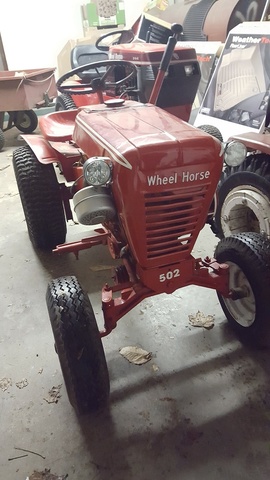

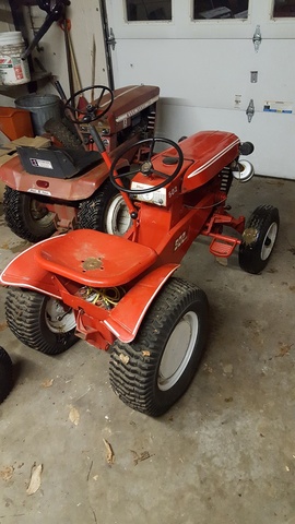

stratostar250 934 #1 Posted December 27, 2016 (edited) So, today I happened to find a 502 on craigslist, that didn't look too bad, so I decided I'd take a peek. The ad said that it hadn't run in a few months, but ran good before that. I had no issues with that, and in person he told me the same story, knowing this, I hadn't paid too much attention to the motor. Tractor had been repainted by the person I got it from, he said he worked at a body shop, looked pretty decent, and he had done some pin striping, which is alright, had some "502" number stickers around the thing which are coming off as soon as I can peel them off, though. Tranny shifted into the gears and rolled fine with no odd noises, so I decided, sure, why not. So I took it. Going over the tractor once I was home, though, I realized that the previous owner must have repainted the tractor, and never finished getting everything back together. The motor has no governor, and theres a zip tie holding the throttle cable in place, around the exhaust which obviously would have melted after the first run, but none the less, I am happy with my purchase and just have a new project. Tractor came with a sorry looking snow plow, a siezed mower deck, home made weights, and an extra "Parts" k141 with no governor parts either , but he did also throw in a pair of like new Vintage Carlisle Turf Saver tires which look like the Firestone Town and Country tires. So, all in all, I'm happy. Just remember, Be observant. Edited December 27, 2016 by stratostar250 16 Share this post Link to post Share on other sites
WHX?? 58,347 #2 Posted December 27, 2016 Nice ...got some character happening but nice! 1 Share this post Link to post Share on other sites
stevebo-(Moderator) 8,743 #3 Posted December 27, 2016 Tom- Glade to see you got that one. I saw it as well and you know me I am an original paint kind of guy... Looks good. I am sure you will get it running just fine. I assume that motor is a 6hp Kohler? Share this post Link to post Share on other sites
stratostar250 934 #4 Posted December 27, 2016 Just now, stevebo said: Tom- Glade to see you got that one. I saw it as well and you know me I am an original paint kind of guy... Looks good. I am sure you will get it running just fine. I assume that motor is a 6hp Kohler? Thanks Steve! PO told me it was a k181, but the painted over tag, after some trying to look thru paint , it says k141. So yes, it is a 6hp. Share this post Link to post Share on other sites
Sparky-(Admin) 26,688 #5 Posted December 27, 2016 Looks like a fun project. What holds the wheel weights in place? Mike..... Share this post Link to post Share on other sites
stratostar250 934 #6 Posted December 27, 2016 3 minutes ago, Sparky said: Looks like a fun project. What holds the wheel weights in place? Mike..... Thanks! I'm looking foreward to it! And it looks like there were short threaded rods cast into the weights as they were made and are held in by bolts, you can see one at the bottom of the rim in the 2nd pic Share this post Link to post Share on other sites
ClassicTractorProfessor 5,455 #7 Posted December 27, 2016 Nice looking round hood, shouldn't take to much to get her up and running again. 1 Share this post Link to post Share on other sites
JERSEYHAWG / Glenn 4,590 #8 Posted December 27, 2016 Looks good to me, best of luck. Glenn 1 Share this post Link to post Share on other sites
Retired Wrencher 7,037 #9 Posted December 27, 2016 Tony Nice find. Should be a good addition to your collection. 1 Share this post Link to post Share on other sites

AMC RULES 37,260 #11 Posted December 27, 2016 502 1962 Lawn & Garden Tractor 502 4-Speed Tecumseh HT55C-3088 5.5 Wheel Horse 5025 Nice score Tom... what are your plans for it? 1 Share this post Link to post Share on other sites
SylvanLakeWH 32,823 #12 Posted December 27, 2016 Love the bug eye headlights! 1 Share this post Link to post Share on other sites
T-Mo-(Moderator) 5,003 #13 Posted December 27, 2016 Nice find. Welcome to the Round Hood Club. Membership cards are in the mail. 1 Share this post Link to post Share on other sites
russellmc301 601 #14 Posted December 27, 2016 good looking horse 1 Share this post Link to post Share on other sites

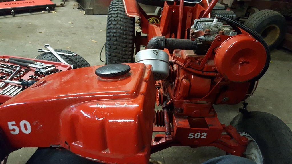

stratostar250 934 #18 Posted December 29, 2016 Update! So, I carefully put the 502 and my ol' trusty work horse 700 together with a belt with a flip in it, and kept the throttle as low as I could get it, and started the 502! Started with no issue! Gave her a few small revvs to see how she sounded, while being observant of the lack of governor on the motor, and she seems to run really well. Kinda seems to have a tick, which is slightly worrysome, but i'll look into it and only time will tell, but, I'm just happy it runs. BUT I did find out that the gas tank leaks more gas than the motor uses, and the transmission didn't move the tractor while in gear. But I watching the belt and I don't think it was engaging properly, belt seemed to not move when I let out the clutch, so it will be something to figure out. At least these tractors are so easy to work on! Share this post Link to post Share on other sites

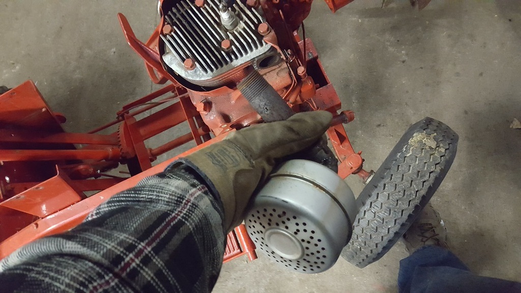

ohiofarmer 3,529 #19 Posted December 29, 2016 So that muffler right against the sheet metal will make that new paint old again . Right up there with that zip tie idea Share this post Link to post Share on other sites
953 nut 70,336 #20 Posted December 29, 2016 6 hours ago, stratostar250 said: Kinda seems to have a tick, which is slightly worrysome, but i'll look into it and only time will tell, Welcome to the round hood club. If the person who rebuilt the engine left out the governor I would hate think what else they didn't do correctly. I would suggest going through the engine just for the piece of mind it will give you. 57 minutes ago, ohiofarmer said: muffler right against the sheet metal First thing you need is a 45 to replace the 90 going to the muffler. 1 Share this post Link to post Share on other sites
WHX?? 58,347 #21 Posted December 29, 2016 2 hours ago, 953 nut said: left out the governor Stupid ? but why would someone do that ...guvs are what make my Kohlers git up & go?? I'm with Dick on taking it apart Tom... just to make sure. 1 Share this post Link to post Share on other sites
stratostar250 934 #22 Posted December 29, 2016 10 hours ago, ohiofarmer said: So that muffler right against the sheet metal will make that new paint old again . Right up there with that zip tie idea yeah, I ran it without the hood, I'll have to change the exhaust. the zip tie melted in the first minute of it running. 9 hours ago, 953 nut said: Welcome to the round hood club. If the person who rebuilt the engine left out the governor I would hate think what else they didn't do correctly. I would suggest going through the engine just for the piece of mind it will give you. First thing you need is a 45 to replace the 90 going to the muffler. Thanks! and yes, I plan on checking into it. Hopefully its something easy, or nothing. and yes, for sure need to adjust the muffler situation. 6 hours ago, WHX9 said: Stupid ? but why would someone do that ...guvs are what make my Kohlers git up & go?? I'm with Dick on taking it apart Tom... just to make sure. Agreed, I have no idea why someone would go thru the trouble of all that, and then leave that off. It's a very important part... Share this post Link to post Share on other sites

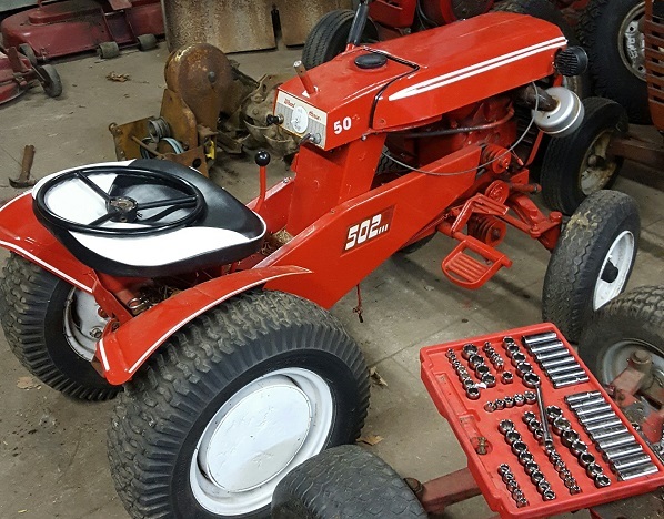

stratostar250 934 #23 Posted January 2, 2017 (edited) So, yesterday, I grabbed an awesome seat cover from @stevebo and while I was working on my 520 (you can see that thread in the resto part of the forum) I took the steering wheel off so I can take off the gas tank and re-seal it, because gas comes out faster than the motor drinks it. Edited January 2, 2017 by stratostar250 3 Share this post Link to post Share on other sites
stevebo-(Moderator) 8,743 #24 Posted January 2, 2017 Seat cover looks great!! Jo (Mrs. Buckrancher) does a great job on her covers. 1 Share this post Link to post Share on other sites

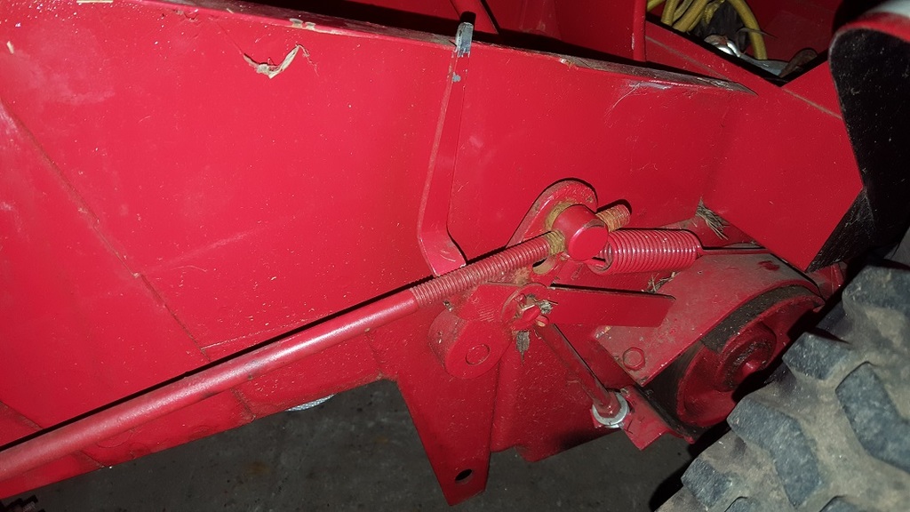

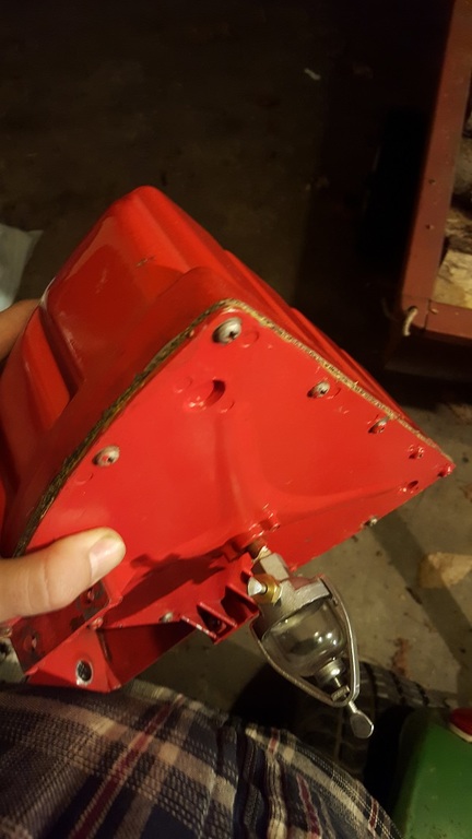

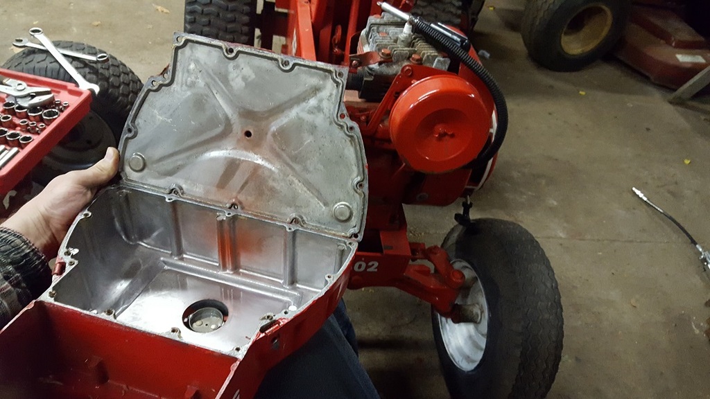

stratostar250 934 #25 Posted January 3, 2017 (edited) More updates!!! So today, I took the tank completely off and opened it. The tank was quite clean! It looked like someone had tried to seal it with some odd plastic epoxy or something. It dried clear, but they did not insert a gasket, hence the leaking. I also took the exhaust off because it is obviously too close to the hood, I'll see If someone at work could bend the main pipe a little bit so it goes downwards, if not, I will see if I can find a new pipe and see what I can come up with. So, one of my local friends heard that I needed the gasket for the gas tank and said that he had an extra one, so I ran up to his house, and we cleaned out the old crud, and put in the new gasket with some sealer, and she doesn't seem to leak a drop!! So excited that the tractor will be less of a fire hazard now. Lastly, I tried to look into the transmission engagement issue I had while it was running. I took off the side panel, and am not sure if these linkages are in the correct positions. Does anyone else have a round hood pic on hand of this area of the tractor which I could reference? I feel like something is off. If it looks to be okay, it is either that spring isn't strong enough, or the belt is stretched beyond its useable state/wrong size, but the pedal acts weird, giving me ideas that some linkage could be wrong. But, all in all, I'm so glad this tractor is progressing the way it is! Can't wait to get her running and driving good! Edited January 3, 2017 by stratostar250 1 Share this post Link to post Share on other sites
