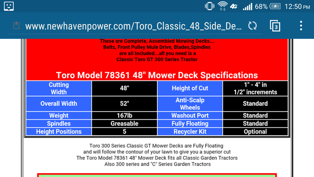

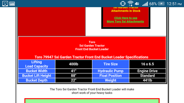

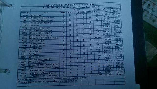

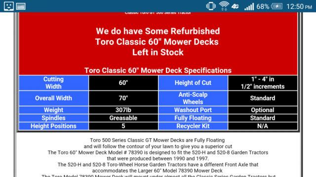

WVHillbilly520H 10,379 #4 Posted December 24, 2016 Here the deck and loader weights and the empty ballast box is 65#... 2 Share this post Link to post Share on other sites
T-Mo-(Moderator) 5,003 #5 Posted December 24, 2016 4 minutes ago, WVHillbilly520H said: Here the deck and loader weights and the empty ballast box is 65#... Good info. What website are those in your first two pictures and can I get a better scan of the bottom picture of that page? Cool stuff. Share this post Link to post Share on other sites

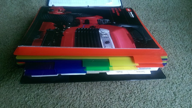

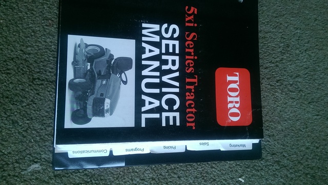

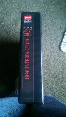

WVHillbilly520H 10,379 #6 Posted December 24, 2016 @T-Mo New Haven power equipment out of CT that still has some NOS TORO WH parts/attachments, and the bottom pic is from a Toro dealer's New for 1998 xi sales/marketing notebook that I acquired after buying the Dxi , sorry it wasn't scanned but a phone pic,Jeff. 2 Share this post Link to post Share on other sites
