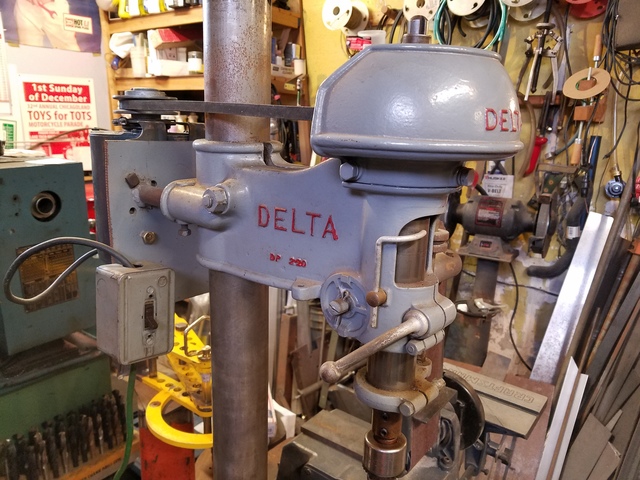

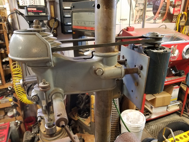

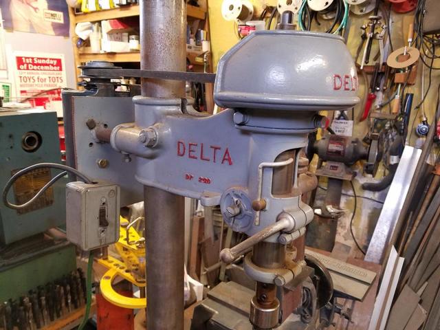

Sarge 3,471 #1 Posted December 21, 2016 I recently found a local CL ad for an old drill press - turns out it was an older Delta DP 220 in great condition except it was missing the clock spring for lifting the quill assembly . Need to figure out what vintage this thing is and get a correct spring for it . Otherwise ,exceptional condition other than a couple of "holes of shame" in the table . Also want to get another step pulley for the motor as it runs far too fast for most metal work and just need this small bench top unit for doing small and lightweight parts . Still hunting a solid Powermatic or similar for a main large machine for heavier stuff . Nice old cast iron equipment , no real play in the quill other than the chuck that's on it and I'll probably upgrade that soon . I believe this one is from the 50's from some quick internet searching , need to look deeper into the machinery forums when I have time . Sarge 6 Share this post Link to post Share on other sites

WHX?? 57,035 #3 Posted December 21, 2016 (edited) Nice...that was made with old school steel. I would maybe call Delta since they are still around and see if they can shed some light on it. That pulley on the motor is the adjustable style and looks to be the 3 3/4" flavor. Might have a 1/2' bore. Looks like you can open it a couple of turns more to go slower and if that don't do it drop to the same thing in the 3" size or look for a step pulley like the driven side. I have never had to vary the speed of my presses once I found that sweet spot speed. Edited December 21, 2016 by WHX9 spell Share this post Link to post Share on other sites

gwest_ca-(File Mod) 12,293 #5 Posted December 21, 2016 Is that a 14" floor model? Garry Share this post Link to post Share on other sites

Sarge 3,471 #7 Posted December 22, 2016 It's an old bench model . A gentleman had it and had been using it for wood working duties for about 20yrs and couldn't even remember where he got it from but it's been passed down and taken care of for years . Yeah - I really need a bigger shop , just passed up a nice old 10" Atlas lathe due to lack of room . It was nice enough I refused to stick it out in a storage unit so I let it go to someone else . In their current form Delta doesn't know squat about these older machines but there are collector machine forums that have some amazing experts just as we do here with our tractors . I'll be hunting a step pulley for sure to get it down in speed ranges , easy enough to do and have seen guys add a middle idler set on top of the column so the original machine isn't altered . I'd like to half keep it as-is and not damage it for further antique quality , lol... The old flat belt units will surprise you - there is far more torque transfer in flat belts than one would expect , more than enough to hurt a person . I need to spend some serious "quality time" on the old Enco lathe - it needs some pretty serious repairs to the head seals , main carriage is running quite loose (pins) as well as the cross feed . It's getting hard to keep the bearings topped up with oil and chase the slop in it which takes too much of my time . Sarge 1 Share this post Link to post Share on other sites

formariz 12,378 #10 Posted December 29, 2016 Great machine. This site may help dating it.http://wiki.vintagemachinery.org/DeltaSerialNumbers.ashx Share this post Link to post Share on other sites
Sarge 3,471 #11 Posted January 3, 2017 No tag - some genius removed it for painting is my guess . Got another drill press , albeit slightly bigger - Clausing 1810 , waiting to be cleaned up , re-wired and put into service when I can figure out how to stuff it in the shop . Sarge Share this post Link to post Share on other sites
