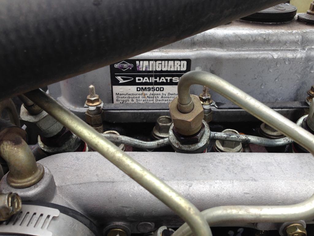

emdmat1981 62 #1 Posted December 17, 2016 (edited) Was wondering if any of the 523Dxi owners or experts have insight into the differences (pros and cons) of the Briggs Vanguard (Daihatsu) 3/LC DM950D and DM850D. I recently acquired a low serial number (around 125) 1998 523Dxi with 350 hrs on the meter and was surprised to see it had the larger 26.5hp DM950D (model # 582447) vs the "standard" 23.6hp DM850D (model # 522447). According to the Toro parts site the DM950D was the only engine used in 1998, while both the DM950D and DM850D were used in 1999, and only the DM850D thereafter. Interestingly enough none of the "glossy" literature or marketing material I have found mentions a 27hp diesel powerplant (either standard or optional) ... even though the Toro parts site confirms its existence). I would be interested if anyone can expand on the differences or knows why the switch in engines by Toro / Wheelhorse. Thanks! Edited December 17, 2016 by emdmat1981 3 Share this post Link to post Share on other sites

emdmat1981 62 #8 Posted December 19, 2016 Thanks to all for their thoughts and perspectives as there is not a whole lot of info out there on the 523 diesel engines. I was really confused about the DM950D engine at first and almost didn't go through with the purchase from the PO since I thought the engine had been replaced. I guess in the end those with an already rare 523Dxi tractor may have an even "rarer" 27hp variety if they have the DM950D (with another 12% more HP and 10% more torque over a DM850D). Perhaps the reason we got the DM950D initially over the DM850D was just due to availability of the engine thru Briggs / Daihatsu. I'm thinking we may never know for sure. Anyway ... a couple more questions: 1) does anyone have estimates or insight into the number of units produced by model number? Would be interested to see the number of Dxi's (and other models in the Xi series) produced. 2) what would you say is the average life expectancy of a Briggs / Daihatsu Diesel? Would have to assume the unit was properly maintained, no overheat conditions, "modified" oil fill process followed, etc 3) any other pain points or things to watch out for with the Diesels? Thanks Again. Share this post Link to post Share on other sites

tbarnhart 240 #12 Posted December 19, 2016 The larger DM950 doesn't necessarily have more horsepower. On a diesel, power is largely a product of the specific fuel rate delivered by the injection pump and can be set wherever the manufacturer wants within limits. The DM850 may not have the volumetric airflow to go to 27hp, but there is no reason that the DM950 could not be set down to a 23hp setting. Those engines came with quite a few hp ratings to suit the different applications that they were installed. I'm guessing that the DM950 was first used because of availability, then was later changed to the DM850 because they only needed the smaller engine to make 23hp. Ratings are often just that. I replaced a similar turbo engine in scag z-turn. Briggs/Diahatsu rated it with several ratings between 34-36 hp, but scag rated it at 31hp. Neither was correct because the fuel pump had been turned up. A 72 in deck was no problem at 7-8 mph. 2 1 Share this post Link to post Share on other sites
