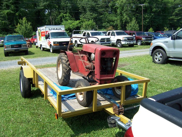

ACman 7,741 #2 Posted December 10, 2016 While going through T-MO's 520H thread I noticed on @WVHillbilly520H trailer he had a manual crank winch mounted on the front . Perfect for or small tractors . No motors or wires to deal with and probably pretty cheap at HF . No if we're talking, let's say a car trailer I'd say 12V winch for your bigger hauls would work great . 6 Share this post Link to post Share on other sites

SylvanLakeWH 32,551 #8 Posted December 10, 2016 (edited) 3 hours ago, ACman said: While going through T-MO's 520H thread I noticed on @WVHillbilly520H trailer he had a manual crank winch mounted on the front . Perfect for or small tractors . No motors or wires to deal with and probably pretty cheap at HF . No if we're talking, let's say a car trailer I'd say 12V winch for your bigger hauls would work great . I have the exact same set up. $10 at HF. Works like a charm and as ACman says - no wires no fuss... Edited December 10, 2016 by SylvanLakeWH 3 Share this post Link to post Share on other sites

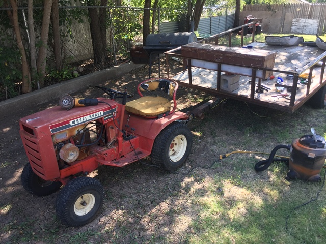

WVHillbilly520H 10,379 #16 Posted December 11, 2016 (edited) 2 hours ago, Professor1990 said: I like the looks of that model...20' of strap would be more than long enough to do what I need to do without having to stop and re-extend it, which is the main problem I'm having now. I also like that ratcheting handle...may be able to mount that under my toolbox and still be able to operate it. Can't mount one on the tongue as some have...wasn't thinking ahead when I built my trailer and put an upright angle brace right in the center of the front, but this may work out great mounted under my box. This is the trailer it will be mounted on If you look at my trailer pic again there's a center upright also, I just run the cable on 1 side or the other, been thinking of fabbing the fairlead rollers (from the HF Badlands 2500# winch "$55 on sale with coupon" I used on my Kioti for snow blade lift) to that upright to help the cable from rubbing, but one real nice thing about the 2500# ATV winch is the "wireless remote control" keep it on you key chain and and no worry of broken wiring there,Jeff. Edited December 11, 2016 by WVHillbilly520H 1 Share this post Link to post Share on other sites
T-Mo-(Moderator) 4,955 #17 Posted December 11, 2016 13 hours ago, Ed Kennell said: I recently saw a picture on another thread where a winch was mounted on the front corner with an idler pulley at the center of the trailer. Maybe something similar would work for you Bryce. That's what I did with my old trailer. Mounted the winch on the driver's side top rail and then mounted a pulley block in the center to redirect the cable straight back. Worked great. You can pick those type of blocks at any hardware store, Rural King, TSC, etc. 1 Share this post Link to post Share on other sites

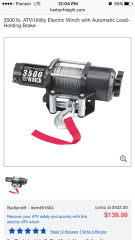

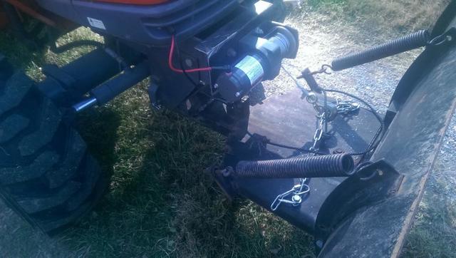

Sarge 3,473 #18 Posted December 11, 2016 If the trailer is going to sit out in the weather I'd pick a steel cable model winch - those straps will rot over time from uv exposure and break , buddy ran himself over with a 445 Deere that had a dead Kawasaki that I fixed later . He ended up with a small atv winch and a L&G battery charged off the truck's 7-wire center supply - works great and he's even had to use a ****** block a few times for heavier loads . Got lucky and scored a nice Warn atv 3500lb unit for $50 - I hated him for that . Need to do something similar on mine soon , I hate that junk come along I have . Sarge Share this post Link to post Share on other sites
ClassicTractorProfessor 5,455 #19 Posted December 11, 2016 54 minutes ago, Sarge said: If the trailer is going to sit out in the weather I'd pick a steel cable model winch - those straps will rot over time from uv exposure and break , buddy ran himself over with a 445 Deere that had a dead Kawasaki that I fixed later . He ended up with a small atv winch and a L&G battery charged off the truck's 7-wire center supply - works great and he's even had to use a ****** block a few times for heavier loads . Got lucky and scored a nice Warn atv 3500lb unit for $50 - I hated him for that . Need to do something similar on mine soon , I hate that junk come along I have . Sarge Good point about the strap type winches in the sun...I hadn't thought of that but glad you pointed it out because yes this trailer is parked outside year round Share this post Link to post Share on other sites
Reel Mower Freak 125 #20 Posted December 11, 2016 I use a 12v winch at times. I just have it mounted to a chain that I can secure to the front of the trailer or in the bed of my truck so it's portable. I use a 12v power pack to run it. Charge it in the garage. Kinda crude but does what I need it to do. 2 Share this post Link to post Share on other sites
SylvanLakeWH 32,551 #21 Posted December 11, 2016 2 hours ago, Sarge said: If the trailer is going to sit out in the weather I'd pick a steel cable model winch - those straps will rot over time from uv exposure and break , buddy ran himself over with a 445 Deere that had a dead Kawasaki that I fixed later . He ended up with a small atv winch and a L&G battery charged off the truck's 7-wire center supply - works great and he's even had to use a ****** block a few times for heavier loads . Got lucky and scored a nice Warn atv 3500lb unit for $50 - I hated him for that . Need to do something similar on mine soon , I hate that junk come along I have . Sarge I keep my boat out all year with a strap winch. It's 20+ years and still going - Secret? - Cheap plastic kids bucket upside down over the top of the whole winch - keeps it dry and in the shade... 5 Share this post Link to post Share on other sites
T-Mo-(Moderator) 4,955 #22 Posted December 12, 2016 21 hours ago, Sarge said: If the trailer is going to sit out in the weather I'd pick a steel cable model winch - those straps will rot over time from uv exposure and break , buddy ran himself over with a 445 Deere that had a dead Kawasaki that I fixed later . He ended up with a small atv winch and a L&G battery charged off the truck's 7-wire center supply - works great and he's even had to use a ****** block a few times for heavier loads . Got lucky and scored a nice Warn atv 3500lb unit for $50 - I hated him for that . Need to do something similar on mine soon , I hate that junk come along I have . Sarge That is why I like the HF model I linked to. It doesn't have to be bolted down and can be removed and store away. It just hooks onto your trailer rail when you need it, and then just take it off when you don't. http://www.harborfreight.com/900-lb-capacity-hand-winch-62471.html Now if your tractor was something like a JD 430 or 400, then the load capacity wouldn't be enough, but for most garden tractors, it will be okay. 2 Share this post Link to post Share on other sites
Sarge 3,473 #23 Posted December 13, 2016 I'm glad you linked that , I usually avoid HF as I hate the Chinese steel used in their junk - seen too many failures like a friends full dressed Harley tipping off their motorcycle lift - $2800 in damage to the bike and destroyed the jack . His total weight was well under it's rated weight capacity - it was 3 welds that broke and were only surface penetrated . I see they have a worm drive hand winch with steel cable cheap enough - I might pick one up since we got a new store nearby . http://www.harborfreight.com/2000-lb-capacity-geared-winch-5798.html Wish I could find a good quality cable winch with 2 speed drum - those aren't cheap and I missed one recently on CL still new in the box...arrgghhh. This model Dutton Lansing - https://www.dutton-lainson.com/proddetail.php?prod=14700 Best bang for the buck , their stuff doesn't ever fail either . I use one similar in single speed to hoist the table up and down on my 30 ton press , table alone weighs 250lbs and with the metal brake I'm building for it should hit around 450lbs total with the heavy 1-1/4" press plates made from forged steel plate I got out of the scrap yard . We couldn't figure out at first why that cut up sheet was so heavy until I ran some weld tests and drilled into it - forged heavy thickness plate is almost impossible to find as it comes from very large stamping forge plants - but you'll never bend the stuff either , lol . 4' x 2.5' wide almost destroyed the rear springs in my Toyota ...and a pair of my steel saw horses . Glad this thread came up , I never can remember to get a stupid winch installed on my trailer until it's too late and end up using that hateful come along . Sarge Share this post Link to post Share on other sites
T-Mo-(Moderator) 4,955 #24 Posted December 13, 2016 1 hour ago, Sarge said: I'm glad you linked that , I usually avoid HF as I hate the Chinese steel used in their junk - seen too many failures like a friends full dressed Harley tipping off their motorcycle lift - $2800 in damage to the bike and destroyed the jack . His total weight was well under it's rated weight capacity - it was 3 welds that broke and were only surface penetrated . I see they have a worm drive hand winch with steel cable cheap enough - I might pick one up since we got a new store nearby . http://www.harborfreight.com/2000-lb-capacity-geared-winch-5798.html Wish I could find a good quality cable winch with 2 speed drum - those aren't cheap and I missed one recently on CL still new in the box...arrgghhh. This model Dutton Lansing - https://www.dutton-lainson.com/proddetail.php?prod=14700 Best bang for the buck , their stuff doesn't ever fail either . I use one similar in single speed to hoist the table up and down on my 30 ton press , table alone weighs 250lbs and with the metal brake I'm building for it should hit around 450lbs total with the heavy 1-1/4" press plates made from forged steel plate I got out of the scrap yard . We couldn't figure out at first why that cut up sheet was so heavy until I ran some weld tests and drilled into it - forged heavy thickness plate is almost impossible to find as it comes from very large stamping forge plants - but you'll never bend the stuff either , lol . 4' x 2.5' wide almost destroyed the rear springs in my Toyota ...and a pair of my steel saw horses . Glad this thread came up , I never can remember to get a stupid winch installed on my trailer until it's too late and end up using that hateful come along . Sarge I saw that top handle winch on HF's website, but it doesn't have a lot of glowing reviews, though some of the reviews aren't a good indication one way or another of a product's quality. If you do get that one, please write a review on it here. 1 Share this post Link to post Share on other sites
