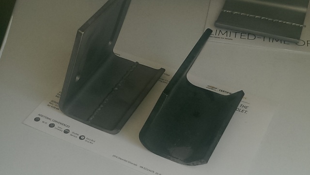

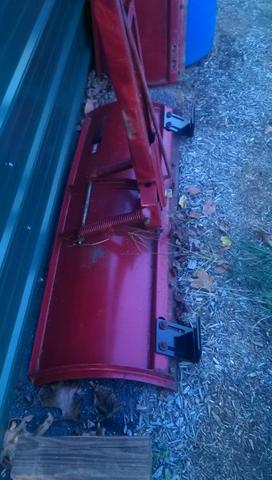

WVHillbilly520H 10,378 #4 Posted December 9, 2016 (edited) The newer blades have them, and I made a set that would set a bit higher,Jeff. Looks like Jeff w those were put on by someone other than factory. Edited December 9, 2016 by WVHillbilly520H Share this post Link to post Share on other sites
jeff w 6 #5 Posted December 9, 2016 WV HillyBilly, thanks for the reply. I already have the two shoes (original), just not the mounts. However, I do like what you have there. Will get back to you if can't find original. Share this post Link to post Share on other sites

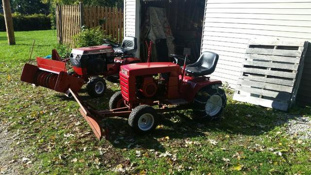

benji756 342 #9 Posted December 10, 2016 Not sure if you can zoom in but heres a picture of my c-81 with the blade mounted, the skids on mine are round and they adjust up or down using a coupla nuts on the treaded rods. 1 Share this post Link to post Share on other sites

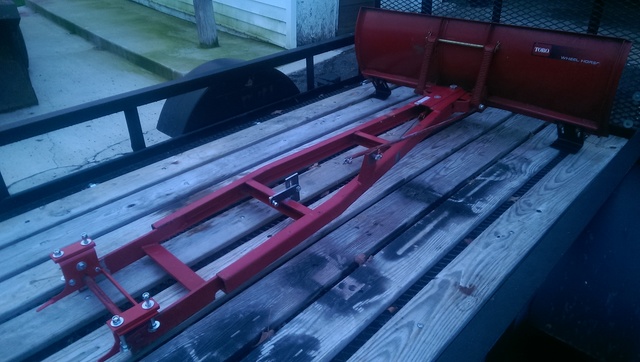

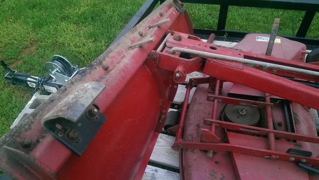

WVHillbilly520H 10,378 #10 Posted December 10, 2016 Ok learn something new everyday I have an older blade but no provisions for skid shoes so I fabbed up a set using the wear edge bolts then I got the 260 and xi plows with the flat skid shoes,Jeff. Share this post Link to post Share on other sites

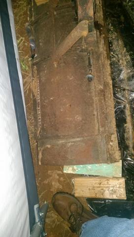

benji756 342 #16 Posted December 10, 2016 Heres pictures of my blade, it looks like a po used 3/4 or 1" x 2" pipe nipples and welded them on. -No Subject-.zip Share this post Link to post Share on other sites
MalMac 1,336 #17 Posted December 11, 2016 Yep, that's it. Carriage bolt heads slip in through there, then skid shoes just bolt on. Share this post Link to post Share on other sites
