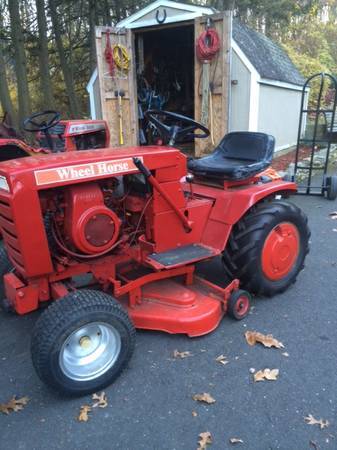

Evening Gentlemen just traded a S/S Snow Blower for a supposed C 81 which had "starting issues". It was
getting dark (PO works till 4:00PM) so first thing I did was hook my jump box to it and attempt to crank
her over.... she did turn, had some compression and coughed weakly but did not start.......  since the
tractor overall condition was good I took the trade.... It has been painted over so there are no readable
tags on the tractor and engine..... it was pitch black when I got her home but I found something right away
that peaked my height of confusion .... the battery was mounted backwards the positive was going to ground
and the negative to the one side of the solenoid...... how the heck did the engine crank???? was it rotating
backwards????   The only thing else I had time to do was jump the solenoid, she cranked no spark jumped
the coil to 12v and the removed plug had good spark...... so to be continued tomorrow with a wiring diagram
Assume the first thing to do is connect the positive side of the battery to the left side of the solenoid and the
negative to a good ground and proceed while running the wiring diagram.... one other thing did the make
C 81 three (3) speeds????  as it does not have a hi > low lever (slot is there)...... Thanks

Okay so status update first I cleaned every thing up including all the grounds..... clean the battery cables and installed the polarity to the right terminals, cleaned the points and set the gap, disconnected the line from the pump to the carb and turned her over pumping fine but terrible fuel coming out, removed all lines cleaned and blew-out installed a new fuel filter, cleaned the charged the cylinder with a bit of 2 cycle gas.... changed the spark plug wire and boot (original in horrible condition) put it all back together and cranked here over ....  STARTED RIGHT-UP ....
and purred like a kitten... smooth idle a  good power through all speeds..... took her for a spin trans is good but must be a trans plant as it is a three speed but a good one.
Problems remaining first took the paint of the engine shroud and I.D. tag with some acetone... it is a 91-08K801 02521 8166 would like to know what model this is or was Engine is a K181 30538
1. The PTO manual Clutch is fused together and will not separate (assume the PO had the adjustment way to tight) what is the best way to free it up (take it apart)
2. It is NOT charging I chked the wires going into the rectifier there is 12v present on the orange wire with the key on, then there are two yellow wires coming from the stator with the tractor running they read approx. a. 37- 42 VAC and b. 23.5 VAC.   NEED HELP HERE AS TO WHAT TO DO NEXT OR VERIFY IF THE RECTIFIER IS TOAST..... Thanks to all
