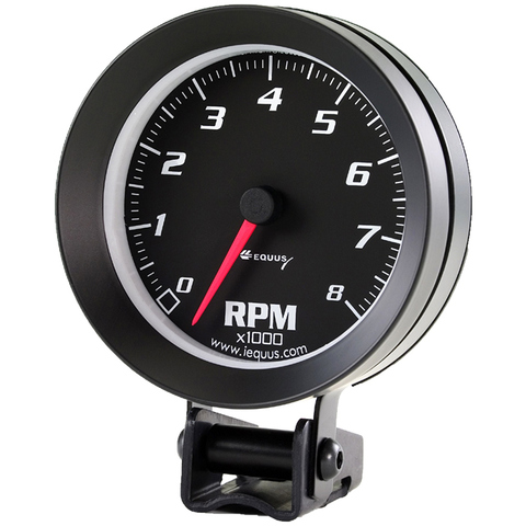

formariz 12,381 #1 Posted November 29, 2016 (edited) Since Bob got my "gadget fever" going again with his post and experience with his tach find, after a little research I found this one that will definitely work on a one cylinder engine with two easy connection options, hardwired, or inductive pickup.Its a little larger at 3-3/8" and has a scale up to 8000RPM but that will not bother me. After all I only use a portion of the scale in the car also anyway.It works with anything from one to five cylinders. I am going to try this one on my black hood and mount it right on the hood. Its a little pricey but its here in the US which will make less risky if anything goes wrong and has to be returned. It also has a one year warranty. Its the Equus 6068 costs $80.00 at Amazon. Here is also a link to Manufacturer page https://equus.com/Product/6068. Instructions link under photo. 93-0012.revE.pdf. Edited November 29, 2016 by formariz 1 Share this post Link to post Share on other sites

formariz 12,381 #9 Posted December 3, 2016 (edited) So Tachometer has arrived. Started having some difficulties with it but then I got smart and really read instructions so here are the results so far: 1-- Battery ignition with alternator inside flywheel--Works fine both hardwired to coil or using induction connection. 2--Battery ignition with starter generator----Also works fine with both connections 3-- Kohler breaker less ignition on Electro12 (trigger system)--Could not make it work! Can only use induction connection on this one due to different coil. Tach responds very little to it in any setting. On this system may have to resort to a tach such as Bob used, but I don't know if I would want to fool with any wires from stator on the Electro. Nearly impossible to find and well over $250.00 when found. 4-- Tecumseh H60 under flywheel stator and points on 653.---Could not make it work.No response from tack whatsoever. Researching the possibility of using a magneto signal converter. Comparing tach to Tiny Tack's that I have and to laser tach readings it is extremely accurate and responsive. Seems to be ideal for any battery ignition system real easy to connect without disturbing or tapping into exiting wiring. Since there is some response on the breaker less ignition there may be a way to make it work, however due to the scarcity and price of those components I just don't want to fool with it at this point but have not given up yet. It is a little on the large size at about 3" but for my purpose it is fine since it does not have to look stock and I want to place it where I can see it readily when in use. Attached are a couple of videos of today's attempts. IMG_1057.MOV IMG_1059.MOV Edited December 4, 2016 by formariz 2 Share this post Link to post Share on other sites
