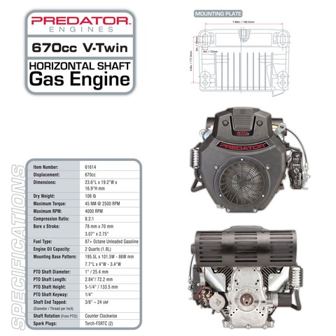

Achto 32,898 #2 Posted November 23, 2016 Here are the dimensions of the Predator engine. Share this post Link to post Share on other sites
Pullstart 71,483 #3 Posted November 23, 2016 I guess I didn't really state my concern... but it looks from the pictures that about any output coupler can be bolted to the PTO side of the Predator engine! I suppose I have all the room in the world to "fit" this onto an open canvas, there is nothing to block it. I'm looking for options to be weighed, pros and cons for either engine. I'd imagine power output may or may not be noticed, when all it does is drive a hydraulic pump. But would a "22 hp" new engine have virtually the same as an old cast iron "18 hp" rating? More or less? Share this post Link to post Share on other sites
Achto 32,898 #4 Posted November 23, 2016 I believe you would only gain with the 22hp engine. Plus it will be a faster fix if you are on a time line. I can cross cut 3 to 4" pieces with my 6.5hp splitter. There can't be anything that stops your machine. 1 Share this post Link to post Share on other sites

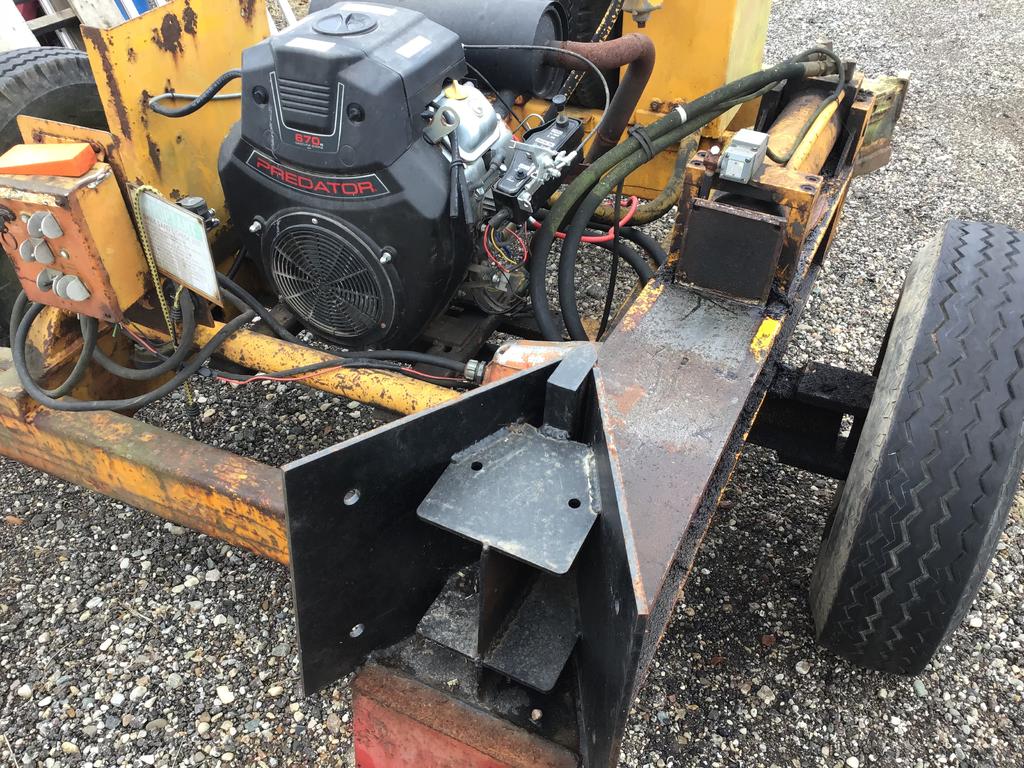

Pullstart 71,483 #5 Posted November 23, 2016 I can't say it owes me much either, you might hate me for this, but I got it free a couple years back. The cylinder leaks and the guy who built it hated to see it go to waste since he couldn't burn wood for health reasons. I'd love to have a longer stroke and I have a cylinder in the garage that's twice as long. I have a 6.5 predator on my old tiller that I thought about using, but the foot pedal operation wouldn't work and I'd have to get a different valve, etc. Here's some pictures of the beast. I don't operate it without tins, I was looking for the source of the oil leak last night... 1 1 Share this post Link to post Share on other sites

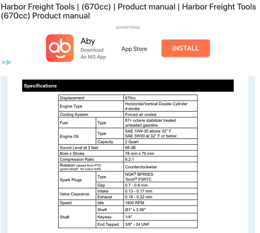

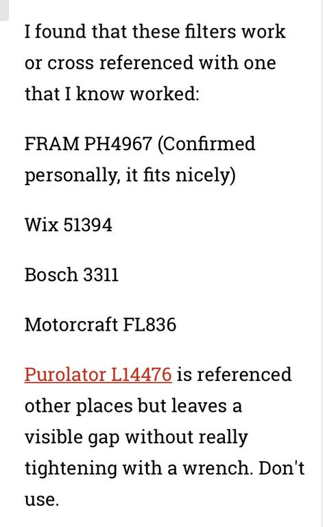

Pullstart 71,483 #10 Posted February 5, 2019 Short update... the carb float must need adjusting, as the crankcase filled with fuel. I drained the oil and noticed I’ll need a filter for an oil change, so I went searching. Here are a couple snapshots I pulled from other sites, I thought it would be good reference here. When I pick up the Wix filter, I’ll grab a 1/4” fuel shutoff too. Share this post Link to post Share on other sites

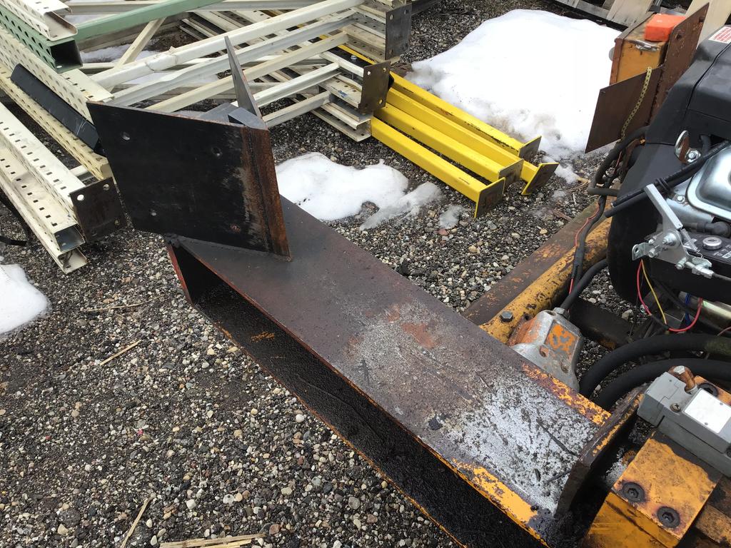

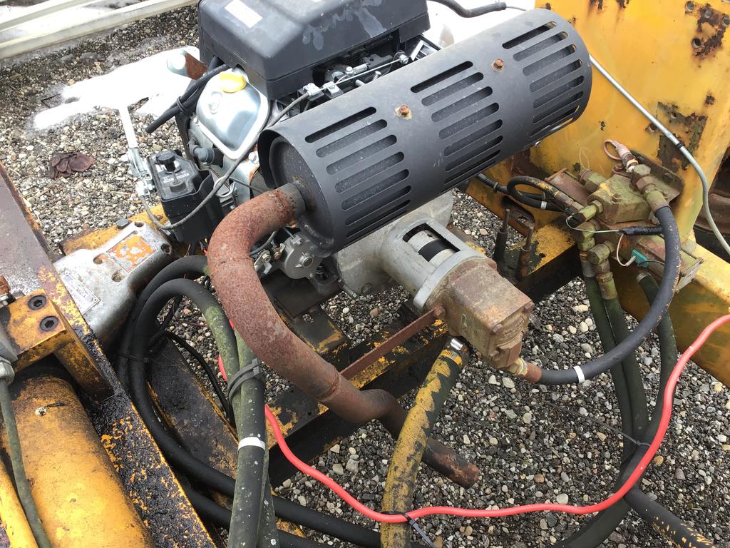

Pullstart 71,483 #11 Posted February 5, 2019 I also noticed that I need to update pictures of the ram and wedge, you can see that the foot was bent a bit in the pictures, it eventually snapped off. I built a big wedge on the beam and cut the wedge off the ram. It splits so much nicer now! Finally, the exhaust was right in my face while working, so a couple drops from an old set of SBC headers helped to divert the spent gases away from me. Occasionally the pedal freezes up, so I put it on the ground under the pipe for a couple minutes and we’re back in business! 2 1 Share this post Link to post Share on other sites
Tractorhead 9,218 #12 Posted February 5, 2019 (edited) Hey Kevin, it is a Cool looking splitter. May you can cut the Exhaust pipe and weld it in other direction, so you're out of the gasses. Maybe sideway's, I think that's the easiest way, or you weld it upright and spend her an exhaust flap like Putt Putt. So the Gasses are over your head and won't hurt you. The new Engine looks pretty nice. Edited February 5, 2019 by Tractorhead 1 Share this post Link to post Share on other sites
