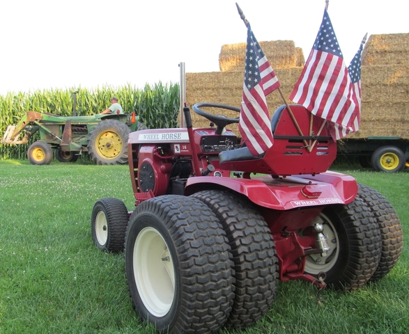

I paid $150 for a running C-160 auto a few years back.  I eventually had to replace the Sundstrand Hydro though.

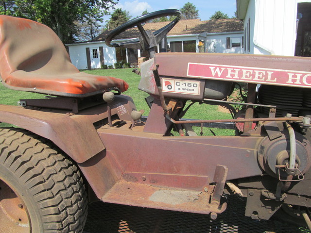

   Just bought a non-running C-160 8 speed for $100 and had it running in an hour, but it smokes bad.

The $150 auto after the redo.

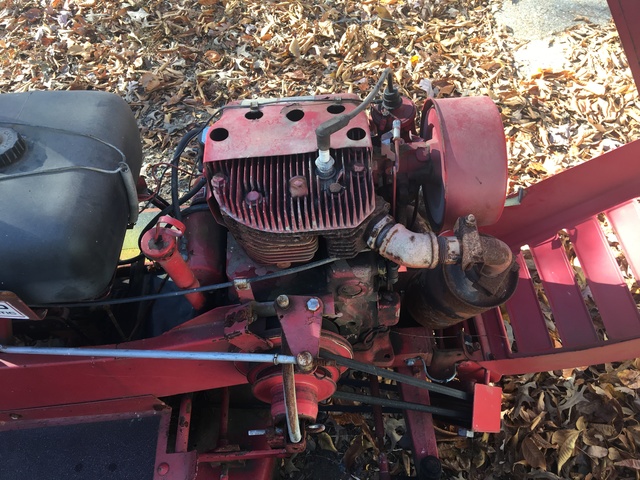

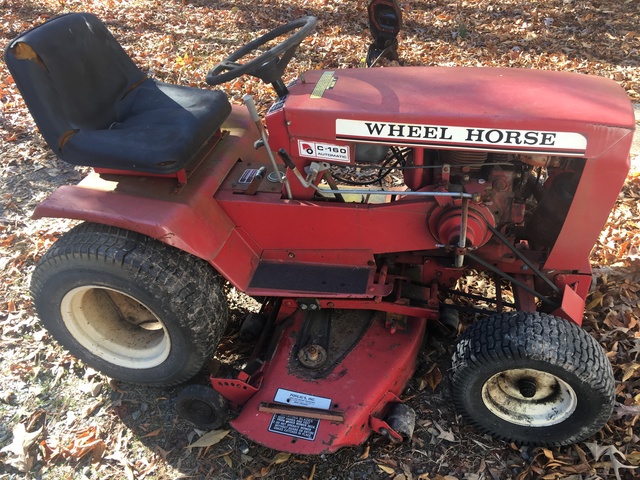

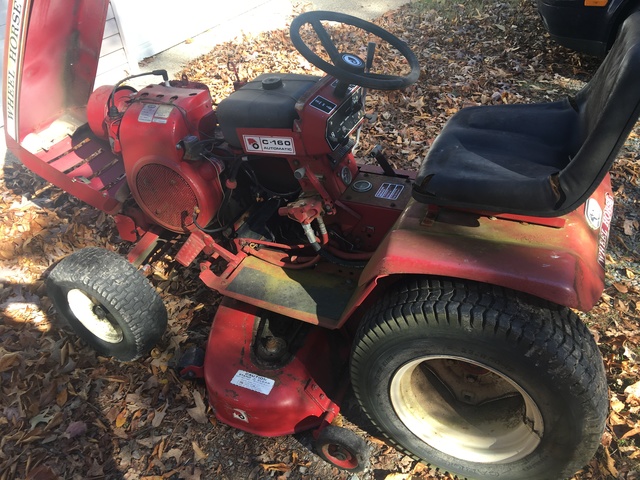

Ok, it's mine. Cleaning fuel tank and replacing lines. Removed and took carb apart. Looks like carb would be better off replaced with a new one. Will check fuel pump tomorrow. Throttle shaft is worn, is real loose. Chinese carbs on eBay ok? Thanks.

You got a jewel there....she looks great.    Good straight tin, good patina, and decals.   Clean her up as is.
Ebay carbs work., but the carters carbs can be rebuilt. There are many posts on here on installing a bushing to tighten the throttle shaft.

Yep!:text-yeahthat:  Clean it!  Paint nothing.  Find an appropriate seat.

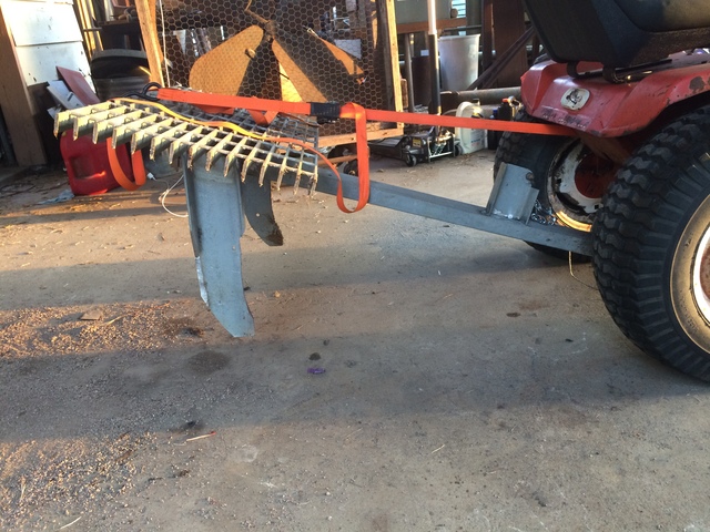

Cosmetically, yours looks much nicer than mine. I just built a ripper plow to bust the hard ground so my tiller could handle it. I was amazed and pleased at the way the c160 handled dragging what is essentially an anchor. It pulls without loading up or bogging down even with the throttle at less than half speed. It's my first Wheel Horse and I'm sold on them now.

Ok guys, completely  rebuilt carb, w/new shaft bushing. Filed points to get spark and cleaned plug. Removed tins and cleaned out, plus found TDC and timing mark. Marked both with white out. Removed cylinder head and cleaned. Adjusted valves, exhaust was way to tight. Check and found ACR out of adjustment. Removed cam gear cover, adjust ACR per manual. Set engine timing. Removed fuel tank and cleaned out gum. Replaced tank bushing and fuel shut off. Replaced fuel lines. Started engine, ran great! Warmed up, shut down, changed oil. Checked and found RPM's over 3800, adjusted maximum to 3570 with tachometer, and idle to 1200. Set carb fuel mixtures. Engine sounds and runs perfect. No smoke. Trans seems to be fine, will change oil and filter. Hydraulics work fine. Need to install permanent battery and take outside of garage for full operational inspection.
