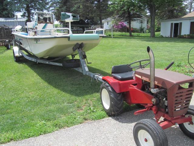

WVHillbilly520H 10,378 #76 Posted December 30, 2016 57 minutes ago, Ed Kennell said: Does this mean I gotta stop moving the 2000lb boat with the Commando 8 ? Ed, I would reckon you're in the clear 1) it's not a dump cart, 2) you're not on a slope at that moment in time......or 3) Toro no longer makes so that was only a liability comment at the time of printing till end of production..., Jeff. 2 Share this post Link to post Share on other sites

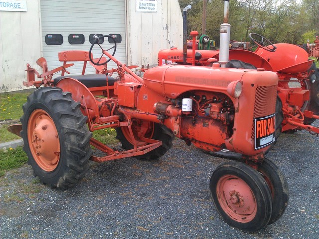

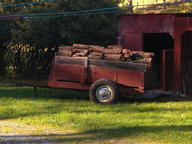

WVHillbilly520H 10,378 #80 Posted December 30, 2016 I understand how important it is to safely operate a tractor and wagon/trailer loaded as I used be "young"(10-12 years old) driver of an Allis Chalmers C with questionable brakes and wood wagon(4' wide 8' long bed with 30" sides) loaded all it could handle in some precarious areas in the woods in WV, but dad would just say put it low gear, 4 notches up on throttle and it'll be okay sure dad I always thought...I was just joking with Ed and I'm sure we all push our limits one way or another with our little tractors,Jeff. 3 Share this post Link to post Share on other sites
Ed Kennell 45,727 #81 Posted December 30, 2016 (edited) Sounds like we learned some of the same lessons in our youth Jeff. I had a close call on my Granddads AC in the mountains of SW Pa. Grandad's rule was use the lowest gear available when pulling a heavy load up a hill or being pushed downhill by a heavy load. Well this 10 year old was moving a load of field stone on a drag sled from a creek bottom to a stone house we were building on the mountain. I was able to drag the stones quickly across the flat bottom pasture in 3rd gear at WOT and partly up the hill till the AC ran out of HP. I probably don't have to tell you what happens when you shift to low gear on a hill and pop the clutch at WOT while attached to a heavy static load. Of course when the AC reared up, I slid back in the seat and could no longer reach the clutch, so the AC ended upside down on top of the sled load of field stone. Some 63 years ago, I was a lot more agile and bailed off with nothing hurt but a mashed steering wheel and hood. Be careful boyz. Stuff happens quick. Sorry for the story Andrew, but I guess it is related. Edited December 30, 2016 by Ed Kennell 5 Share this post Link to post Share on other sites
WVHillbilly520H 10,378 #82 Posted December 30, 2016 Ed, I'm only 45 but I grew up in the "land that time stood still" we used all horse drawn equipment converted over to tow with the AC's (great granddad bought a new B '47 as well my great uncle's) then dad and his brother the C...other than the hydraulic culivators, mold board plow, and belt driven "buzz" cord wood saw, yep just like living in Amish country and we still had draft horses until I was in high school, ok enough off topic but the good ole days for sure,Jeff. 5 Share this post Link to post Share on other sites

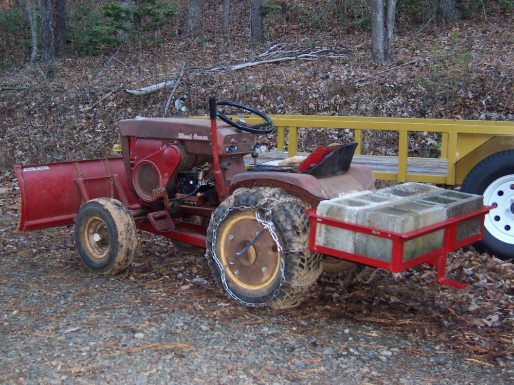

953 nut 65,183 #92 Posted January 7, 2017 Had my first opportunity to see how well the added rear weight works, 6" of wet heavy snow and my driveway is quite steep. Now I can plow going uphill and down, without it I was only able to plow going down and struggled to go up with the plow raised (removing some traction from the rear wheels). 4 Share this post Link to post Share on other sites
Ed Kennell 45,727 #93 Posted January 8, 2017 That should hold her down Richard. What are those blocks...about 50lb each? 1 Share this post Link to post Share on other sites
953 nut 65,183 #94 Posted January 8, 2017 1 hour ago, Ed Kennell said: What are those blocks...about 50lb each? That sounds right, if it was any heavier it wouldn't steer well; 1 Share this post Link to post Share on other sites
