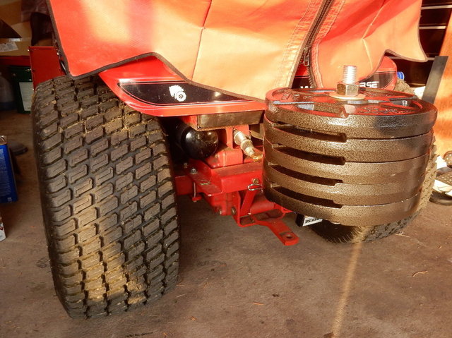

Kurt-NEPA 756 #2 Posted November 18, 2016 I need some ballast weight to counter a two stage blower on my 520H. I have 2X70lbs wheel weights, but that was not enough. So I welded up a hitch with 2" sq. receiver. Inserted a hitch upside down. Added a piece of 1" all-thread. Then stacked up some Wally World cheapie 25 lb. barbell weights. Now I have over 125 lbs hanging out back. I'm not sure this is what you had in mind, but its what I've done. 6 Share this post Link to post Share on other sites

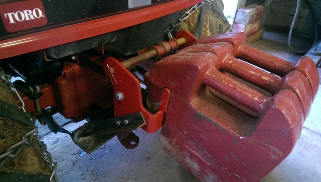

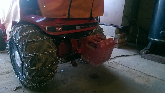

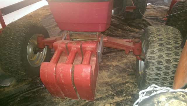

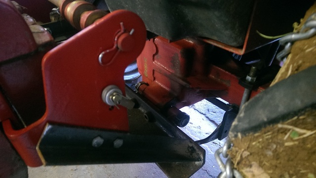

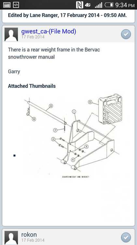

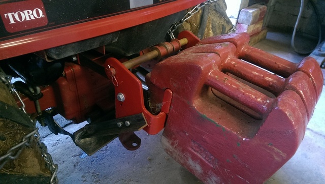

WVHillbilly520H 10,378 #9 Posted November 19, 2016 I did this with mine 3 42# suitcase weights,it's based on the Bercomac factory rear weight hitch for the Wheel Horse, and I also made a bracket for the weights to hang off the front for use with the tiller or other clevis hitch attachments,Jeff. 6 Share this post Link to post Share on other sites

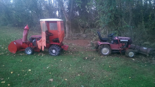

wallfish 20,214 #17 Posted November 19, 2016 Hanging 200 lbs should not a problem at all but it must be secured and braced properly. And even if it is a problem, IMO it's still better to not get stuck or slide around in the snow wasting time while freezing my nuts off. Fix it in warm weather and do it all over again. This tractor pictured carries more weight than others are attaching to theirs. Built in '08, trans swap in '09 because of a snapped axle when running 10.5 dualies but so far so good since then. Not sure of the total weight but guaranteed it's more than 200. Same philosophy applies with this one too. I'd rather dig a trench in 2 hours instead of using a shovel for 12 hours and not worry about a trans which can be swapped in less than 10 hours, if necessary. So if the tractor does it's job, let's say 10 different times, which equals 100 hours of hard labor saved to sacrifice a trans bearing, so be it. No brainer IMO. BUT, I enjoy working on the tractors too so that certainly plays a roll and realize this way of thinking might not fit everyone's situation. 10 Share this post Link to post Share on other sites

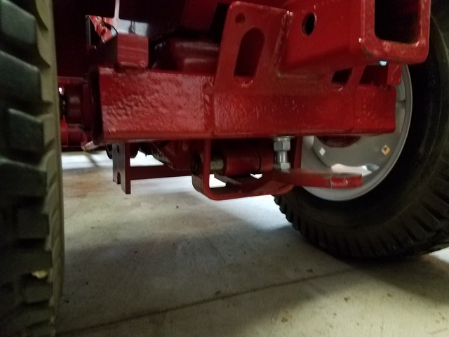

JERSEYHAWG / Glenn 4,578 #19 Posted December 17, 2016 55 minutes ago, Mastiffman said: How much Weight can be applied to the Stock Rear hitch of a 520h? The one with hole in the middle for the eye bolt? Is 100lbs to much? That's a good question, I don't know the answer. Some folks get a 2 inch receiver hitch made by Tom, one of the vendors here. It's pretty robust ,bolts to the rear, and has 2 rear legs for additional support. I had one made for my 520, then sold the 520. He is doing one for my 5xi. I don't have a picture handy. Will be waiting to see the replies you get, curious I am to. Glenn 1 Share this post Link to post Share on other sites

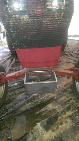

Duramax7man7 506 #21 Posted December 17, 2016 (edited) My Hitch Came in the middle of the night so I will be using fortunately be using that today! BUT I will still like to find out about the max tongue wight for the stock hitch if anyone knows. I'll look for it in my free time as well. Later. EDIT: Photos.... This was right after this mornings workout... Edited December 17, 2016 by Mastiffman 4 Share this post Link to post Share on other sites

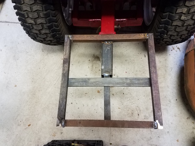

moe1965 774 #23 Posted December 18, 2016 Thought I read that it was rated at 300 lbs. I made this out of scraps laying around. I know the car hitch Is mounted upside down but I wanted to get my hitch hight up off the ground a little. The basket holds a milk crate that I put my weight in. I am itching to plow this year this is my first horse I restored. 5 Share this post Link to post Share on other sites
