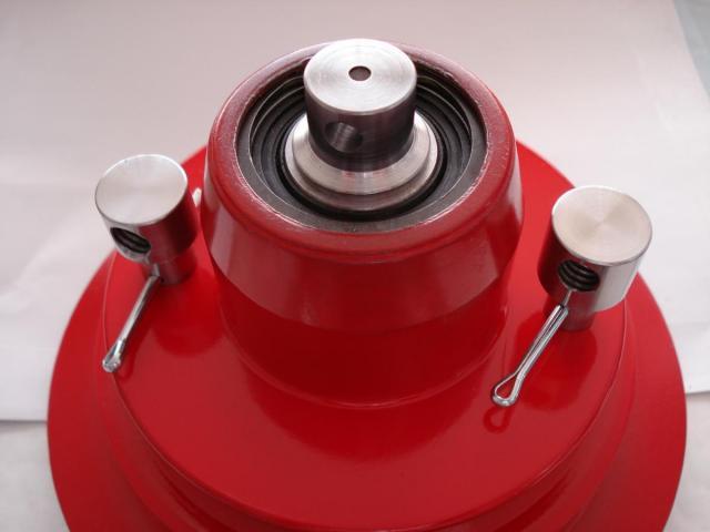

Anglo Traction 761 #22 Posted December 2, 2016 I'm an advocate for refurbishing the old (adjustable) Kohler Carbs. Being an amateur Shedman, I am able to make all my own parts including all Shaft Bushings, Shafts, Butterfly Plates and Screws. All back to new condition. Aftermarket Carbs are available here fairly cheap, but they are not serviceable and have to be junked when they fail. So I'm stuck in the mindset of the age where things were repairable I suppose. Considered Electric Pumps, but prefer to try and keep original Spec. If it keeps your machine running to do a job, then it's down to personal choice and option(s) to choose from. 3 Share this post Link to post Share on other sites
Searcher60 209 #23 Posted December 2, 2016 Are you saying that you have the equipment to manufacture these small parts in your garage? Share this post Link to post Share on other sites
Anglo Traction 761 #24 Posted December 2, 2016 Hello, sorry for the delay in reply (Dental Appt). 5 hours ago, Searcher60 said: Are you saying that you have the equipment to manufacture these small parts in your garage? Yes, I am able to produce many parts for my WHs and other machines as well. Good parts aren't easy to obtain here, so I set to it and make them if possible. I found my old Thread here on a #26 Carb ---LINK--- No qualifications, taught myself and just enjoy it as a Hobby really. Some Trunnions and a modified PTO Shaft for example. It saves me a wedge of money!. Regards, Richard. 3 Share this post Link to post Share on other sites
Stormin 9,988 #25 Posted December 2, 2016 A handy man is our Richard. Done some very nice work. Pity he's 'tother end of the country to me. Share this post Link to post Share on other sites
