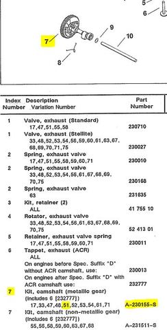

stevasaurus 23,567 #13 Posted November 27, 2016 I opened up Gary's manual link and tried to come up with the cam shaft part number for your K 181 S 30452D. I come up with a cam shaft part # A-230155-S. This was on page 31 of that manual...if I did that right. If that is the right part number, it is also the same part number as the K 181 S 30108D which was used in the states on Wheel Horses from 1964 to 1969 Kohler 8 hp engines. It should not be too hard to find your cam shaft. Let me know if I did that right...please. Share this post Link to post Share on other sites
gwest_ca-(File Mod) 11,975 #14 Posted November 28, 2016 A-230155-S looks correct to me. Garry 1 Share this post Link to post Share on other sites

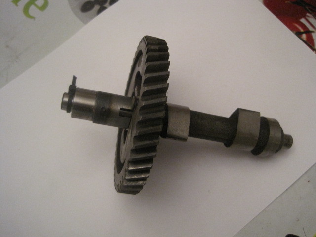

Erby 15 #16 Posted December 6, 2016 I have today received a camshaft from Harvey Baker in Kentucky ,looking at the one inside the engine it is different in that the advance mechanism is on the other side of the gear ,and is recessed into the gear, will this one work with my engine ? Share this post Link to post Share on other sites

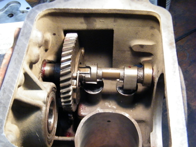

stevasaurus 23,567 #17 Posted December 7, 2016 (edited) Is there any way you can post some pictures?? Do you have a copy of the Kohler Manual? Does the one in your engine look like this one?? Edited December 7, 2016 by stevasaurus 1 Share this post Link to post Share on other sites

stevasaurus 23,567 #19 Posted December 7, 2016 (edited) Erby, can you post a picture of the one you got from Kentucky?? I can't seem to find a cam shaft with the ACR on the other side. The one you got may not work. I happen to have another one like the one in the picture if you need it...but let's see what you got 1st. Does the one from Kentucky look like this?? Edited December 7, 2016 by stevasaurus Share this post Link to post Share on other sites
Erby 15 #20 Posted December 7, 2016 (edited) Yes, the key difference is on the opposite face to the one you are showing - pictures attached of the camshaft we have bought from Kentucky. I've also included a picture of the page from the Kohler engine parts manual that shows (yellow highlights) the part we bought. Its based on variation 51 which is our engine. Edited December 7, 2016 by Erby edited to add photo of purchase details provided Share this post Link to post Share on other sites
stevasaurus 23,567 #21 Posted December 7, 2016 (edited) Erby...check out this thread. This is where I got the 2nd picture. I think it looks like you could use either cam shaft...see what you think. Maybe @prondzy should add in on this. Edited December 7, 2016 by stevasaurus 1 Share this post Link to post Share on other sites

prondzy 3,889 #23 Posted December 8, 2016 Thanks @stevasaurus, remember the 2 peice camshaft i was telling you about that dad found in his 704 motor, your looking at it, see how on the short shaft side of the cam that erby posted, this is the points lobe that is the points lobe that can be put in 180degrees off and the motor wont run. and seeings how it is from a k161 i dont think i would chance it. let me re read this thread and catch up with whats going on and ill chime back in. 1 Share this post Link to post Share on other sites
gwest_ca-(File Mod) 11,975 #24 Posted December 8, 2016 An older service manual low resoulution High resolution - You can download just section 12 Camshaft discussed on page 12.2 One is automatic spark advance and the later automatic compression release? Noticed the exhaust tappet is shorter on the ACR engines with non-adjustable tappets. Garry 1 Share this post Link to post Share on other sites
oldredrider 2,553 #25 Posted December 8, 2016 Garry, good catch on the shorter tappet. I ALMOST changed out cams on a 953 engine to put in the ACR cam, but my gut said "leave it original". I didn't even consider tappet length, although it might have been ok with the adjustable valves on the big block. Or maybe not! Share this post Link to post Share on other sites
