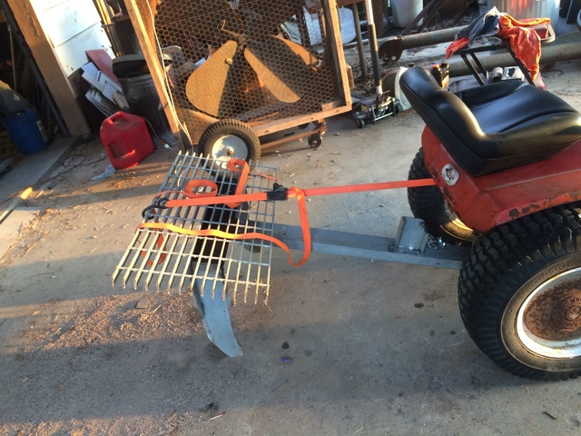

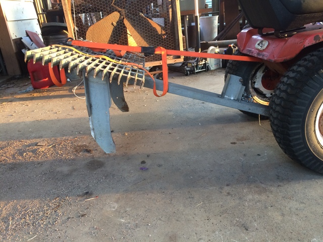

Hacksawhero123
I made use of some scrap metal that had accumulated around the shop today. The ground we have here in coastal Texas is called "black gumbo". Hard as a rock when dry and a sloppy mess when wet. I needed something to rip or break the ground before I could till it. My old Troybilt Horse was getting nowhere trying to bust into it. The ripper worked pretty good until I piled too many concrete blocks on it and broke the cheesy 1/8" lift cable that I spliced onto it. I'll pick up some heavier cable tomorrow. Not a bad day though.
Mark.
