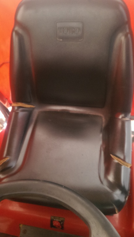

Duramax7man7 506 #1 Posted November 11, 2016 Anyone have any good ideas for repalcement seats for a 520h? Not really liking the old style. Mine is all busted up looking. Would like something may last longer. NorthernTool.com has some nice universal folding high back seats with armrests as well for about $100 Share this post Link to post Share on other sites

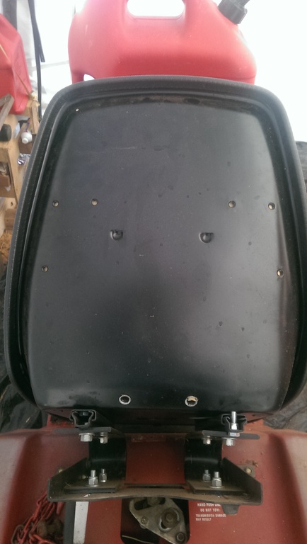

ACman 7,655 #8 Posted January 10, 2017 (edited) I did a thread on this last month I picked the Michigan V-818 but it's not a direct bolt on . @WVHillbilly520H used this seat and said it bolted right up with new slides what slides did you order Jeff ? 17 minutes ago, ohiofarmer said: Pull the fender pan and check underneath to find this potential safety issue and increase your safety. i guess i need to become a supporter to post some pictures... @ohiofarmer there's away around posting pics , but being a supporter sure makes it easier . Edited January 10, 2017 by ACman 1 Share this post Link to post Share on other sites
WVHillbilly520H 10,376 #9 Posted January 10, 2017 @ACman, sorry Jeff I bought the seat slider tracks from Northern same time I ordered the seat because my orginals were rusted out, the Philip's head screws wouldn't budget in the original from where it had sat outside for 10 years, I wasn't thinking about the new sliders as I bolted them up to the seat then the "U" springs, I'd still buy this seat again just for the fact it's the same dimensionally as the '96 newer O.E. Toro 520/xi seats and more comfortable to me,Jeff. 2 Share this post Link to post Share on other sites
ACman 7,655 #10 Posted January 10, 2017 I think I only seen one set of slides and they were made by KM at just under $18.00 . I'll probably have to same as my 520 sat outside too . It does look comfy and the vinyl is a lot softer . 1 Share this post Link to post Share on other sites
WVHillbilly520H 10,376 #11 Posted January 10, 2017 Yes sir those sliders were about $18 kinda soso as to how they work but beats fabbing up and adapter and yes way softer material hopefully it holds up for 15+ years like my '97 did before cracking at the corners... 1 Share this post Link to post Share on other sites
