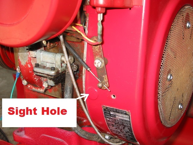

953 nut 69,481 #2 Posted November 2, 2016 Give this a try, timing is set by your points, but this method is a way to be sure it is right. Kohler static_timing.pdf Share this post Link to post Share on other sites

WHX?? 58,196 #5 Posted November 2, 2016 Excuse me for being but what is the s - hole (no pun intended) he is talking about in @953 nut's link?? Share this post Link to post Share on other sites
pfrederi 21,172 #6 Posted November 2, 2016 I assume he is talking abut the hole in the front of the blower shroud you look through to see the timing marks on the flywheel 1 Share this post Link to post Share on other sites
WHX?? 58,196 #7 Posted November 2, 2016 Do all K's have them or just the 321? Share this post Link to post Share on other sites
pfrederi 21,172 #8 Posted November 2, 2016 I have K181, 241 and 301 in the shop right now. all have the hole. One has a snap in plug in the hole the others long since lost I suppose 1 Share this post Link to post Share on other sites

BOBTHEBOPPER 3 #10 Posted November 4, 2016 Thanks guys but am haveing a slight problem, 953 nut responed with good information however there is no slght hole in the bearing plate or in the shroud. What happened and where??? Any way I think Hossenfeffa solved my problem. I will set the points @ .018 and see if the "dreaded kickback" vanishes. I will give it a shot and let you know. Share this post Link to post Share on other sites
953 nut 69,481 #11 Posted November 4, 2016 There could ba a plug covering the hole. Share this post Link to post Share on other sites
