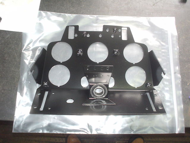

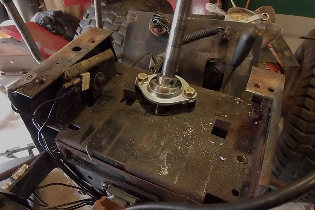

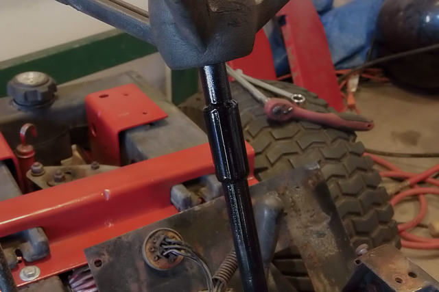

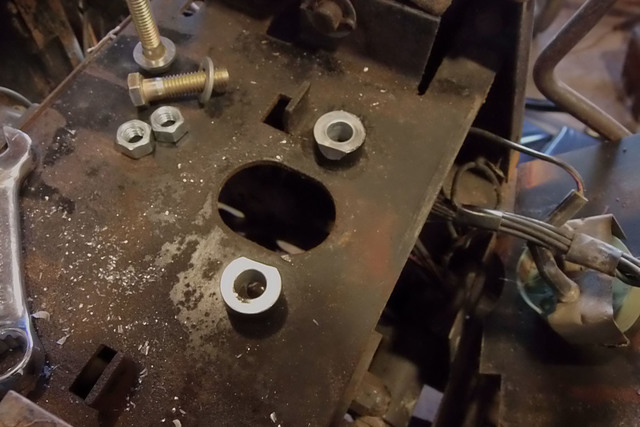

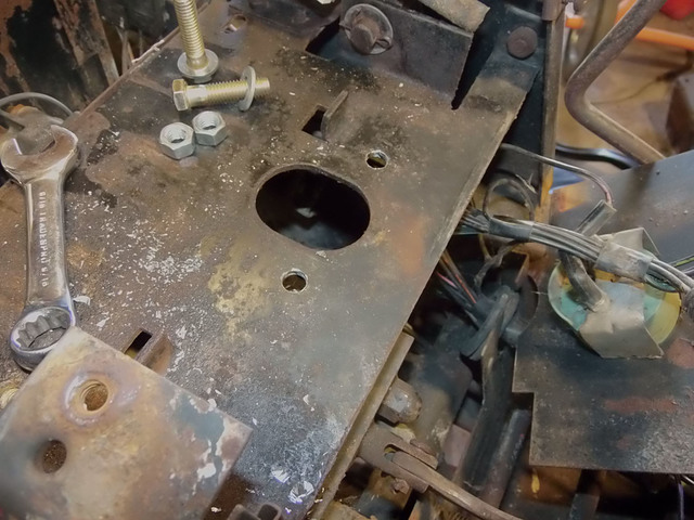

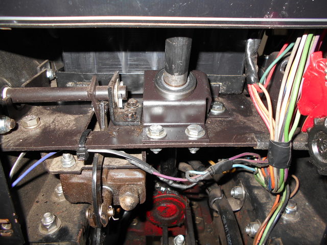

edgro 680 #1 Posted November 1, 2016 Here is what I did to repair the upper steering column bearing on 417A. Was not able to get the steering wheel off, so I cut the shaft, then welded it back together. This did prevent using the plastic cover to the upper column, so I just painted it black. Steering is good and tight now. 14 Share this post Link to post Share on other sites
JC 1965 1,547 #2 Posted November 1, 2016 WOW !! Very nice clean fix. Thanks for sharing. Share this post Link to post Share on other sites
DougC 2,644 #3 Posted November 1, 2016 Looks like a snow thrower shaft bearing and a couple if sandwich flanges. make a couple spacers and voila!!!! Nicely done. Share this post Link to post Share on other sites
cleat 9,296 #4 Posted November 1, 2016 Nothing better than ball bearings on the steering shaft. Will last forever and make steering so much smoother and easier. Share this post Link to post Share on other sites
DennisThornton 4,773 #5 Posted November 1, 2016 Well I'm liking that! OH! I forgot to "like" that... Share this post Link to post Share on other sites

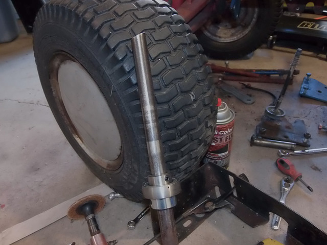

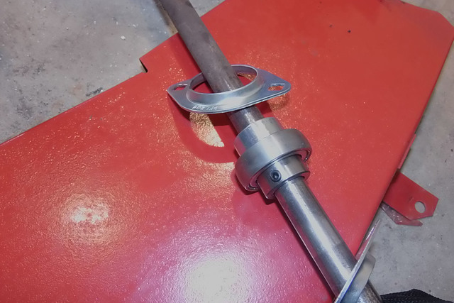

edgro 680 #6 Posted November 2, 2016 Thanks for the comments. the steering is good and tight now. here are pics of my "steering wheel removal" Share this post Link to post Share on other sites
Fun Engineer 863 #7 Posted November 2, 2016 Edgro Where did you buy this? Share this post Link to post Share on other sites
WHX?? 57,932 #8 Posted November 2, 2016 (edited) 1 hour ago, Fun Engineer said: Edgro Where did you buy this? Yes inquiring minds want to know! I was thinking about some type of pillow block bearing?? @cleat didn't you do something like this to your 520's? Edited November 2, 2016 by WHX8 Share this post Link to post Share on other sites

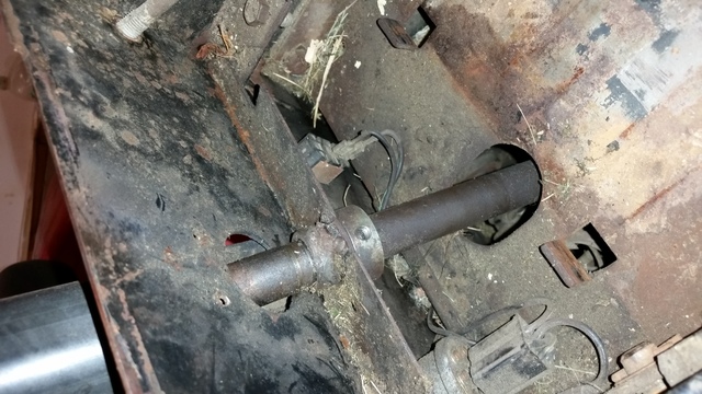

cleat 9,296 #9 Posted November 2, 2016 I got rid of the bushings, drilled the hole bigger, and pressed in wheel bearings. Here are pics of both early and late style 520's that have ben converted. Cleat 2 Share this post Link to post Share on other sites
DennisThornton 4,773 #10 Posted November 2, 2016 3 hours ago, cleat said: I got rid of the bushings, drilled the hole bigger, and pressed in wheel bearings. Here are pics of both early and late style 520's that have ben converted. Cleat I was rapidly scrolling down and saw some pictures and said to myself, "That looks like something Cleat would have done.". Scrolled back up and YEP! He did! Share this post Link to post Share on other sites
benji756 342 #11 Posted November 3, 2016 I used a 2 bolt dodge pillow block bearing on my 520 I'll get some pictures as soon as I can and for my steering wheel removal I cut the shaft and made a clamp using 2 3/4 inch 2 bolt clamps and a piece of steel tubing I'll get some pictures of that also. I was amazed at the difference it made on how easy it steers now. 1 Share this post Link to post Share on other sites
edgro 680 #12 Posted November 3, 2016 I bought most parts on ebay and also some from TSC. I did see that TSC has the bearing and retainers, which I had gotten off ebay 1 Share this post Link to post Share on other sites

USHorse 41 #14 Posted December 12, 2016 (edited) Edgro, does that bearing swivel to compensate for the shaft running down at an angle? Or is that just an illusion? Edited December 13, 2016 by USHorse Missing word Share this post Link to post Share on other sites
edgro 680 #15 Posted December 15, 2016 Yes. The bearing holder is slightly concave, and the bearing is slightly convex. this allows the bearing to be mounted at an angle from the bearing holder Share this post Link to post Share on other sites
