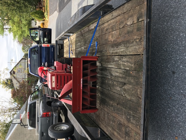

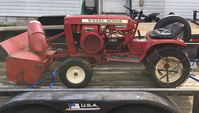

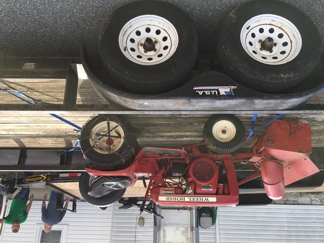

Newbiehorse 15 #1 Posted October 30, 2016 Newb here. This is is my first wheelhorse. Don't know much about it. It has a kholer 10hp in it. And it turns over but doesn't run, yet! I know cubs cubs but not much about this horse. I would like some headlights. Does anyone have any info about this tractor? And I have no idea why they keep uploading like this. I've tried everything 3 Share this post Link to post Share on other sites

wallfish 20,733 #5 Posted October 30, 2016 (edited) Probably just clean those points and carb, change the oil then fire that baby up! You'll find a Wheel Horse is very easy to work on because of it's simplicity in the way it's engineered compared to other manufacturers. If you can verify the actual Model# we can give you the exact year and a manual for it. Seems the Charger 10 was only 1972 and the model# 1-0410 but always best to be sure since a lot can happen between then and now. 1-0410 1972 Lawn & Garden Tractor Charger 10 Automatic Kohler K241S-46636D 10 Sundstrand 90-2046 Edited October 30, 2016 by wallfish 3 Share this post Link to post Share on other sites

pfrederi 21,308 #7 Posted October 30, 2016 You will need a headlight bucket and lens. Frankly the standard head lights are not that great. They use the standard 1156 bulb (2ea) (think back up lights on older cars) You can search here for lots of alternative ideas LEDs etc. Welcome Chargers are great machines and if the limited slip differential is still working they will move some serious snow. When you get a chance jack up the rear end and spin one wheel the other should turn in the same direction. 3 Share this post Link to post Share on other sites
Newbiehorse 15 #8 Posted October 30, 2016 24 minutes ago, pfrederi said: You will need a headlight bucket and lens. Frankly the standard head lights are not that great. They use the standard 1156 bulb (2ea) (think back up lights on older cars) You can search here for lots of alternative ideas LEDs etc. Welcome Chargers are great machines and if the limited slip differential is still working they will move some serious snow. When you get a chance jack up the rear end and spin one wheel the other should turn in the same direction. So it's not frowned upon if I mount after market lights on it some how ? Share this post Link to post Share on other sites

Ed Kennell 47,821 #12 Posted October 31, 2016 Nice tractor. Like stated above clean and set the points and plug, and make sure you have good fire. Then work on the fuel supply. If you have spark and fuel, it will run. Then check the hydro for water. You may need to do a flush and fill after determining if it has ATF (pink) or 30W(amber) . Do not engage the parking brake with the tractor moving. You could break off the pawl inside the hydro. 2 Share this post Link to post Share on other sites
Newbiehorse 15 #13 Posted November 1, 2016 On 10/30/2016 at 3:10 PM, wallfish said: Probably just clean those points and carb, change the oil then fire that baby up! You'll find a Wheel Horse is very easy to work on because of it's simplicity in the way it's engineered compared to other manufacturers. If you can verify the actual Model# we can give you the exact year and a manual for it. Seems the Charger 10 was only 1972 and the model# 1-0410 but always best to be sure since a lot can happen between then and now. 1-0410 1972 Lawn & Garden Tractor Charger 10 Automatic Kohler K241S-46636D 10 Sundstrand 90-2046 Ok it's a 10410 7 Also the guy said it would turn over but not fire.... it it was missing the spark plug and the fuel line was shut off. Put a plug in it, opened the line. Fired right up. Very smooth sounding 4 Share this post Link to post Share on other sites
