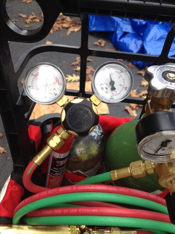

Cadmandu 67 #1 Posted October 18, 2016 Hi All I just bought a torch set from Lowes took the tanks down to get them filled and they took my new one and gave me an old one tha was filled. The threads were banged up and needed dressed with a thread file. The problem is the fuel tank has a 3/16" square valve that you open and close with a tool that came with my kit. I threaded the gauges on the tank and made sure that the regulator valve was backed out and the valves were closed on the torch handle. I then opened the tank valve 1 full turn and the gauge on the right measured 150 psi. After attaching all the gauges and hoses to both tanks I did some brazing when finished I turned off all the tanks backed out both regulator knobs then bleed the hoses. Here is the issue, I read 180 psi on my fuel tank gauge even though the 3/16" valve is closed tight. My regulator knob is backed out and no pressure in the hose. The oxygen tank when turned off both gauged read zero. Is this a problem? Thanks Dan Share this post Link to post Share on other sites
benji756 342 #2 Posted October 18, 2016 sounds like you have pressure trapped between the tank shutoff and the regulator, try opening the regulator and valve on the torch but leave the tank valve closed. 2 Share this post Link to post Share on other sites
Cadmandu 67 #3 Posted October 18, 2016 When you say open the regulator do you mean turn the knob CW so I could read pressure on the left side gauge then open the torch? Share this post Link to post Share on other sites
benji756 342 #4 Posted October 18, 2016 yes that should drain off the pressure. when I shut down torches I always shut off the tank then drain off the pressure then back the regulator out. 3 Share this post Link to post Share on other sites
Cadmandu 67 #5 Posted October 18, 2016 Thanks so much I will go down stairs and do that. When I set the gas and oxy what should each gauge read for brazing or filler rod welding. I did a pretty bad job today. Share this post Link to post Share on other sites
