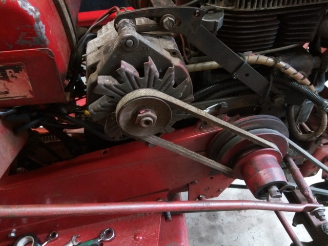

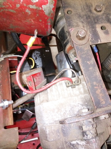

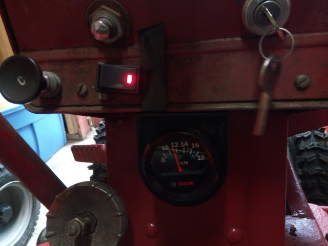

mmmmmdonuts 274 #1 Posted October 8, 2016 Had some time today to do some work and also finish a project I have been wanting to finish for a while. Had three goals to accomplish: 1) Finish installing the external alternator 2) Install a voltmeter 3) Add some new wiring as needed When I first got the tractor there was an alternator sitting on the side of the tractor, but it was never wired up. It was an old si10/si12 three wire alternator which is mounted to the engine with a couple of cross bars that adjust. I know it is overkill for this size tractor and lawn battery but it was already there so I figured I use it. I took a picture of the top and final configuration with a belt. So to wire up the three wire alternator here is what I did. 1) The red wire out of the terminal is the battery sense voltage terminal. Since I don't have long electrical wires I just hooked it up to the stud in the back where the main wire goes to charge the battery. 2) I then used a 6 gauge wire and went to the back of the alternator and to the post on the solenoid where the battery is connected. I fused it with an 80amp fuse which you can see in the picture. 3) The last wire to hook it up is the black wire in the terminal. This wire is for exciting the alternator. You MUST place one of three items in line with this. You place either a 10ohm 10 watt resistor, a lamp, or a diode with this wire. I opted to use a diode. For the smaller SI10 alternators you can use a 1A-3A diode, but for the larger models I believe you need to be 5A or higher diode. I put the diode in with the cathode (the side with the line) facing the alternator along with a 10A fuse in line as well. This wire goes to the ignition switch marked IGN. The only thing thing that is not ideal is that it only runs when the PTO is engaged. Since this is normally how I am using the tractor it is not a problem. The alternator is on an adjustable slide so I can mount it either to the inner or outer pulley. Typically it is mounted to the outer pulley. I can always just remove the PTO belt when not in use if I am carting stuff around the lawn, but since the alternator is so over-sized all I usually need to do is run the PTO for a few minutes and the battery is completely charged. The next project I was trying to accomplish was install a voltmeter. I got this voltmeter on amazon for $20 or so and I mounted it underneath the hood, by drilling two holes from the inside, and just bolted it underneath. I connected the positive terminal to the ACC on the ignition switch (fused with 5A) because I don't want the voltmeter to kill my battery when the tractor is not running. The meter came with a backlight as well and I spliced that into my into headlight switch which you can see on in the picture, so the light only comes on when the headlights are on. The last thing I did for the day was clean up some of my wiring and replace some of the old wires. I went to walmart and bought a couple of 6 gauge wire with lugs already on them and replaced the battery to the solenoid, the ground wire and added the wire to the alternator. The connections were getting poor so by replacing them I hope to have a much easier time starting it this winter with the snowblower. If anyone has any questions I would be glad to help. 5 Share this post Link to post Share on other sites

mmmmmdonuts 274 #5 Posted October 9, 2016 1 hour ago, 953 nut said: As long as you keep an eye on the electrolyte level you should be OK. Have you given any thought to installing a switch in the #6 wire to pick up the lost power while snow blowing? Since it is a 3 wire alternator, I believe I could put a switch to the field wire that excites that alternator to effectively kill the output of the alternator which would greatly reduce the size of the switch / relay necessary since it doesn't carry much current. I was thinking about this last night though and I don't think it is completely necessary because the alternator should only in theory need to run for a few minutes to completely charge the battery. Once the battery is completely charged the alternator load should effectively go to almost nothing other than spinning the cooling fan on the alternator and therefore the amount of HP lost would be negligible. The only load I currently have other than the ignition coil is some LED lights and the voltmeter that draw hardly anything. Eventually I would like to put a winch on the tractor which could significantly change things but I wouldn't be mowing or snowblowing when using it. As far as performance goes. I have a 2.5" pulley on the alternator going to the 3.5" pulley on the PTO (1.4 to 1 ratio) which should be able to put out around 50A or so if needed at 3000rpm (4200 at alternator). At idle speeds around 1200rpm (1680rpm at alternator) it should be able to put out 10A-20A. 1 Share this post Link to post Share on other sites
gwest_ca-(File Mod) 12,321 #6 Posted October 9, 2016 With the field powered by the IGN terminal it should try to charge when starting. Hook it to the ACC terminal so it is powered only in the RUN postion. Garry 2 Share this post Link to post Share on other sites
mmmmmdonuts 274 #7 Posted October 9, 2016 Thanks Garry. I made that modification today. I can see how that's a problem when trying to start. Don't want any additional load especially since it is controlled by the PTO anyway. Took it out mowing today and it seemed to work well. Voltage according to the voltmeter was somewhere between 13V-14V. Mower didn't bog down at all. Share this post Link to post Share on other sites

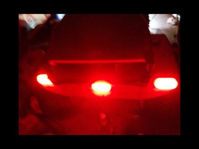

mmmmmdonuts 274 #8 Posted October 26, 2016 Did two upgrades over the weekend. 1) Got the Kirk engines Transgender II electronic ignition and replace the coil with a nice Bosch coil, spark plug and wires and new points. Almost couldn't believe how much nicer it starts and sounds. I really didn't want to have any winter starting/running blues. 2) Got some new LED clearance lights off of Amazon and put them on the rear end. Looks very nice and bright. https://www.amazon.com/gp/aw/d/B00VT85Q0G/ref=pd_aw_sim_263_3?ie=UTF8&psc=1&refRID=8KC4EP5H48BPGV0NTGDH 3 Share this post Link to post Share on other sites
