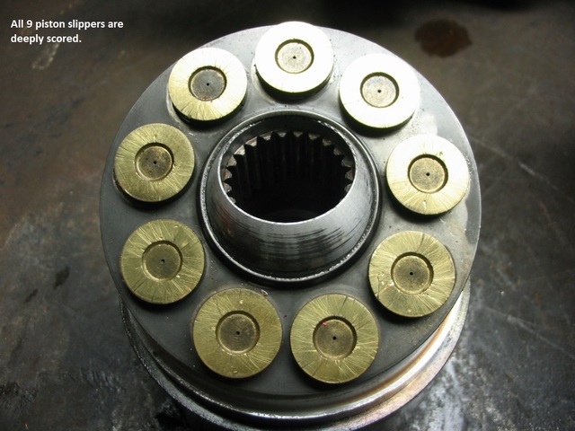

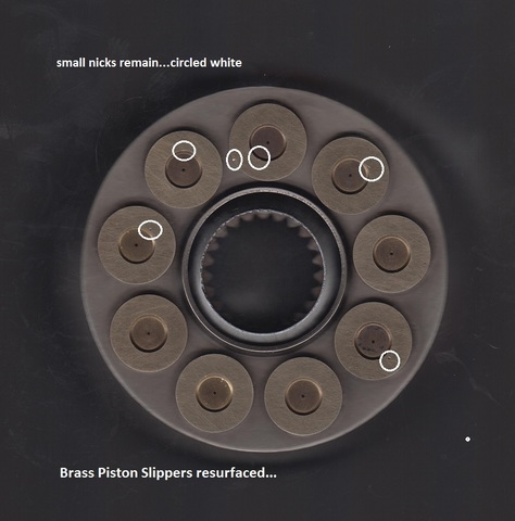

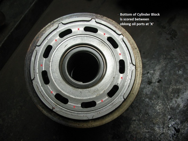

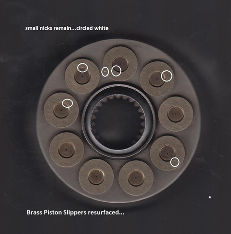

daveoman1966 3,884 #8 Posted October 2, 2016 The GT-14 has the Sundstrand Hydro Gear model 90-2062 (if original). The symptoms you described are typical of a worn-out hydro pump. It works great until it reaches operating temp, then fades....correct? The only solution is to rebuild the hyd pump and I have done such a number of times...successfully. This not so daunting a task. I am a retired bean-counter and if I can do it...successfully....most anyone who knows what a box-end wrench is, can do the same. I can provide TONS of pics of the rebuild process, and refer you to a source for some parts, though not all parts are available anymore. There are 9 pistons in a cylinder block that have brass surface SLIPPERS and these get scarred or scratched, allowing hot oil to bypass thru those imperfections, resulting in loss of pressure. There are a few other components needing service..Charge Pump Housing, Gerotor set, Thrust Plate. These are steel and MAY require a machinist's flat grinder. Don't remove too much material from any part....just enough to eliminate the gouges or scratches. Some REALLY DEEP gouges may not come out...get most of them though. You'd be will advised to install 3 new oil seals in the pump housing too... Essentially what needs doin' is to resurface the BRASS components of the pump...meticulously...by hand. Depending on how deep the gouges are, use the infamous "WAX ON....WAX OFF... technique to resurface the parts. Use a machinist's SURFACE PLATE or THICK SHEET OF GLASS. I start with 280 grit, then 400 grit, and finish with 600 grit with a drop of oil on the sand paper. Don't make a mirror finish....just to a buff. Try to keep pistons in their original cylinder bore as the sidewalls have mated over time. NOTE.... here are a couple pics for reference. There MAY ALSO BE other components that have failed...or broken and these my be addressed too. Valves, springs, O-rings and the like...not directly related to the components of the hyd pump. 9 Share this post Link to post Share on other sites
