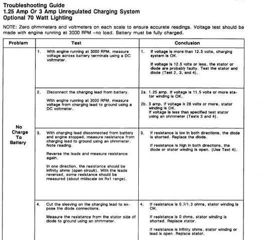

pfrederi 19,199 #5 Posted September 29, 2016 Diagnostics for the unregulated system. You can download the manual from here in the manual section. 2 Share this post Link to post Share on other sites

pfrederi 19,199 #8 Posted September 29, 2016 Interesting they do not show any thing to do about "overcharging". (Tecumseh used fixed charging system years ago but you could pull one diode if it was too much charge whne you ran the engine for a long time. I have a 310-8 with the 3 am system. i am going to fire her up and see what the voltage is Share this post Link to post Share on other sites

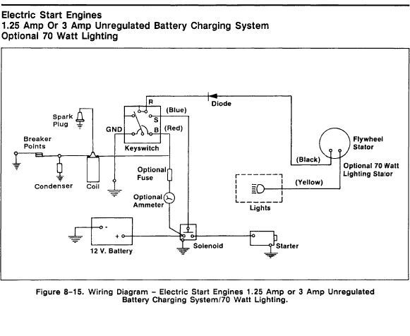

953 nut 62,930 #16 Posted November 22 Here is the electrical for a 3 amp system on the 312-8 Share this post Link to post Share on other sites
