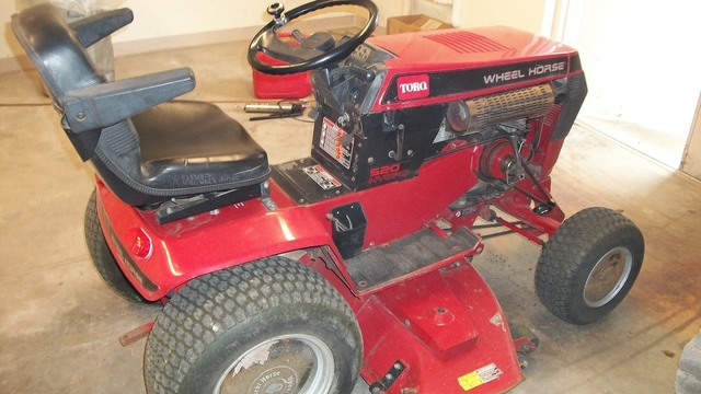

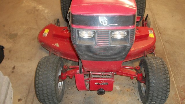

On ‎9‎/‎21‎/‎2016 at 9:36 AM, Red520 said:
I just purchased my first wheel horse tractor. It is a 1995 520H serial #5901574 and I have a few questions to ask. When I received the tractor the idler pulley on the main drive belt was shot so I replaced it. I notice that the drive belt is still doing a lot of jumping and may be stretched. The parts diagram shows the belt but the diagram doesn't seem to be the same as my model. It lists the drive belt as 5/8" x 83". Can anyone tell me if this is correct?  Also the hydro transmission seems to be slightly engaged when in neutral and it will move forward when parked. If I put the brake on it sounds like the transmission is trying to move. Any adjustment for this? I am using this to mow about 3 acres of grass that has a lot of obstacles and I am wonder if the hydro tranny will take a lot of forward and reverse motion? I did tighten the bolt a little on the tranny shift linkage to stop the shift lever from dropping down when it was in motion.

I got the cam plate and the cam and I have installed them it works great going into reverse but forward is stiff. I loosened the nut on the cam plate to free it a little more. The edges of the cam plate are newly cut so I imagine it will take a while to wear in. When I pull the hydro lever back it comes to an abrupt halt and about throws me over the hood. I hope it wears in soon.
