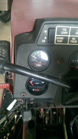

Red520
The gauges that do not work on my 520H are the alternator, fuel and hours. I haven't done anything with them yet but I hope to get some time soon to check them out. I will send some photos later today. Again I appreciate all the help from everyone. It makes it so much easier to do something when you have insight before hand.

WVHillbilly520H
If the voltage regulator is bad the hour won't work, and as for the voltage gauge a cheap aftermarket one from Advance Auto($17),AutoZone,Napa ect will fit/work I did one of my 520s back in the spring, just had to trim the plastic dash opening to fit the gauge bezel,Jeff.

Red520
Hello Again,
I replaced my drive belt and got the lights and all of my gauges working. I tried to adjust the drift in the hydro tranny by turning the cam and I was able to get it to neutral but shortly after it started to drift again. I removed the bolt from the cam adjuster because it did not feel right. The cam has flat spots worn on it and needs replaced. Would it be a good idea to also replace the shift plate that it fits into. Where would be the best place to order the parts?

If the tach works that is the most expensive one to replace.
Thanks for your help Cleat it was just a blown fuse. My tractor has 2 fuses in it a 20 amp and a 30 amp. I saw in the manual that it should have 3 fuses. Is that correct?
