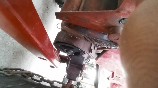

Hi guys! Still new here and not too good at navigsting through the site so i apologize if this has been covered before. I got this '75 c100 last winter for plowing the drive and have found a use for it in clearing my woods the last two months, which after its last use of pulling one tree around and haulin my little cart with tools out there, it seems to be leakin purdy good on the pulley on the left side of the transmission. Always a drip or two here n there, enough to say "yup, its a '75". But i come out today and find an area about a foot in size with oil under her. The case doesnt seem to be craked anywhere where i can see. Seems as though its seeping through the shaft this pulley is on. Is this a common thing? If its fixable, what parts do i need n where do i get them from? Any and all help is much appreciated!

I would check the bearing on the shaft that is leaking. My b-80 started leaking after using it to push some dirt around and it turned out the needle bearings were bad in the axles. But if the bearing is good you should be able to get the seal at napa that's where i get my seals for wheel horses.

What is the easiest way of checking this? Take the pulley off of the shaft or more or less take the trans apart all together?

The best way ive been told was to see if the shaft has up and down movement.

That's the brake drum, not a pulley. I'm betting the bearing will be fine. Remove the drum and you'll see the seal. You can replace it without opening the transmission. Pick it out with a small screwdriver, awl or similar. Here's a guide for the seals.
Make sure the shaft is free of any burrs. Slide the new seal in place and you'll be good to go. I like to use a large washer and a piece of pipe to tap it in. That will assure you that it's flush with the case. :)
If the bearing is bad then you'll have to open the case.

Your seal should cross to SKF 7410...available from Autozone, NAPA, Motion Industries, etc.  Looks like you may have to drop that channel to get the brake drum off.  Take off the spring and those 2 bolts on the brake band and the band will slip out of your way.  You do want to see if there is any up and down and side to side movement with the shaft.  Any and you have a bad bearing.
