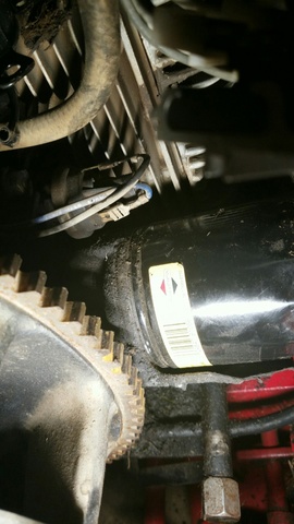

No idea 1 #1 Posted September 23, 2016 I have a wheel horse 520hydro and I'm having a problem with with what I am assuming is the oil pressure switch. The tractor will fire up and run great for a few minutes then suddenly shut off and have no spark, the oil pressure light blinks on the dash but I have checked the pressure and it's fine. Is there anyway to bypass the switch? Because the dealer is telling me the oil pressure switch is on backorder and or discontinued Share this post Link to post Share on other sites
953 nut 69,481 #2 Posted September 23, 2016 You didn't mention the year so I just picked a manual at random. I believe the oil pressure switch goes to ground on a lack of oil pressure which shorts the magneto and kills the ignition. If you remove the wire from the switch it should let the engine run. Chances are there is an automotive pressure switch that will do the job, just a matter of finding a good parts man who cares enough to look it up. 2 Share this post Link to post Share on other sites
No idea 1 #3 Posted September 24, 2016 I wish I knew the year but I'm not really sure I know the part number for the oil pressure switch is NN10273 I want to say it's a mid 90's tractor. I did disconnect the wires from the sensor and the tractor still died maybe I'm looking in the wrong place? Share this post Link to post Share on other sites
