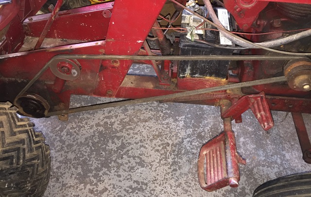

Gasser 24 #1 Posted September 18, 2016 Hey everyone I just picked up a Wheelhorse 702 tractor..got it running today and had the side belt cover off and looks like it may be missing a pulley does anybody have a picture they could post of what it looks like under the cover I will try to post some pictures of what I have there now..Thanks Here's a picture of what I have 4 Share this post Link to post Share on other sites
Racinbob 13,286 #2 Posted September 18, 2016 No, you're not missing a pulley. It looks like you have an input shaft seal leaking. I would replace all the seals and service the transmission. You don't need to open the transmission to replace the seals. Make sure you have the belt guard on when you drive it. You need it in order for the belt to stop when you clutch it. 7 Share this post Link to post Share on other sites

Gasser 24 #4 Posted September 18, 2016 Thanks guys..that's good to hear! the belt seemed really loose when I engaged the clutch but I guess that's what the cover is for I didn't know if there was suppose to be another tesioner pulley or something that was supposed to be there.. I'm going to change that seal where would you recommend getting the seal and what weight gear oil should I use?thanks 1 Share this post Link to post Share on other sites

wedge 80 #6 Posted September 18, 2016 My Commando 6 is the exact same. Looks like your belt is stretched some also. 1 Share this post Link to post Share on other sites

953 nut 70,336 #9 Posted September 18, 2016 Your drive belt is 9691 (replaces 1576) and is a 4L-700 or you could use an A-68. Here is a copy of your manual. Share this post Link to post Share on other sites

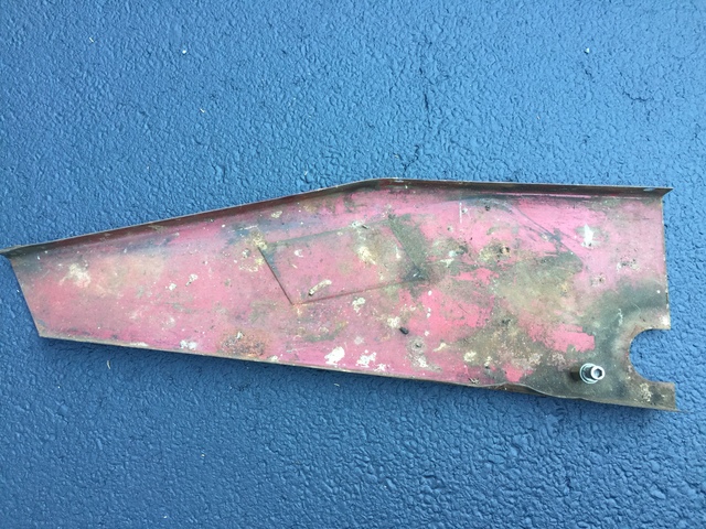

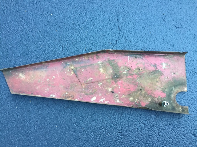

Lane Ranger 12,161 #12 Posted September 19, 2016 Gasser: Does your belt guard have the tab on it to catch the belt when tension is released by clutching? Very important. Sometimes you need an extra wire belt guide on the motor especially with a loose older belt. Share this post Link to post Share on other sites

Gasser 24 #17 Posted September 23, 2016 Sorry @Lane Ranger I just got a chance to look at the belt cover today..here's a picture of it..I think it's missing a mounting tap near the engine 1 Share this post Link to post Share on other sites
Lane Ranger 12,161 #18 Posted September 23, 2016 Yes but you can weld one onit! Share this post Link to post Share on other sites
sorekiwi 761 #19 Posted September 23, 2016 Check out your clutch spring on the other side of the transmission. It puts the tension on the idler. 1 Share this post Link to post Share on other sites
