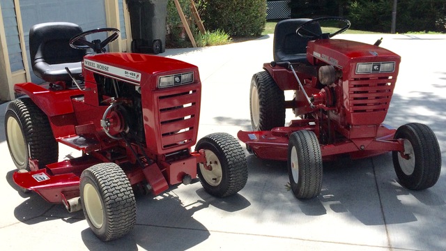

Al C. 1,480 #14 Posted September 22, 2016 I use my 1967 and 1982 Wheel Horses regularly during the summer (every week or two) - subscribing two the old saying, "Use it or lose it." Follow all the maintenance items described above and run them with respect and care. I have not noticed any degradation. From time to time, something will wear out, but this happens with new machines too. It's a good way to get to know your machine inside and out. I've been surprised at how well a well maintained 50 year old Wheel Horse still does work. Honestly, they are as good as a five year old machine. My advice, don't treat it like an antique, or it will become one. 5 Share this post Link to post Share on other sites
