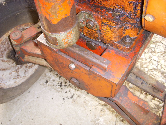

T-Mo-(Moderator) 4,928 #1 Posted September 14, 2016 This is on my 701. It's fastened to the frame through the hole that mounts the hood on the front. It's threaded, and I was thinking it was how the hood gets mounted, but if won't line up when the hood is in place. And I can't find this part on the parts list. It's the piece with the bottom portion sitting inside the frame, and has tabs that sit on the frame side rails on both sides, just below the coil. 2 Share this post Link to post Share on other sites
ol550 878 #2 Posted September 14, 2016 It WAS spot welded to the hood. 4 Share this post Link to post Share on other sites
T-Mo-(Moderator) 4,928 #3 Posted September 14, 2016 Ok, that makes sense since I see where the spot welds are on this piece. Thanks. Share this post Link to post Share on other sites
slammer302 2,157 #4 Posted September 14, 2016 Its very common for those to break off. I've had a couple broken ones. Share this post Link to post Share on other sites
russellmc301 601 #5 Posted September 14, 2016 just retact weld it and it will be like new. Share this post Link to post Share on other sites

T-Mo-(Moderator) 4,928 #8 Posted September 16, 2016 I figured out why things don't line up. Steve replaced the hood with a good one. The previous hood had the tab broken off and it was still fastened to the tractor. The replacement hood had the tab still intact, except the threaded hole wasn't threaded anymore and stripped out. Mystery solved. And here is the dimensions of the hood tab from the broken off one from the original hood. ROUND HOOD TAB.pdf Share this post Link to post Share on other sites
