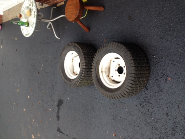

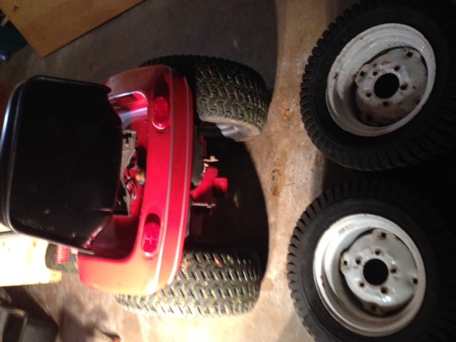

Cadmandu 67 #19 Posted September 15, 2016 Just bought a set of 23 x 10.5 x 12 with rims from a tractor graveyard. It was lots of fun walking among all the possible projects. I think the guy is a hoarder seems like nothing was for sale. I bought them for 60.00 each they leak around the rims but they have been out in the rain deflated. I will pull them apart as soon as HF gets my 44.00 tire changer in. My tires are 22 x 9.00 x 12 and rims were painted silver I am hoping that my new ones are 81/2 and my old ones are 71/2. Can I put jack stands under my axle while changing wheels/ 1 Share this post Link to post Share on other sites
pfrederi 21,274 #20 Posted September 15, 2016 (edited) Yes to the jack stands. It is hard to tell from the picture of the new white wheels but did they come off a Wheel Horse??? If not did you check the backset. Wheel horses do not have much back set and that is especially important if you want to use chains. (too much backset and the chains will hit the frame and gas tank holder). EDIT: To measure backset lay a straight edge across the back of the rim. Then measure the distance from that to the bolt holes. Should be 1-3/8" for a WH. A common wheel back set is 2-3/8" That may cause clearance issues with fat tires and/or chains. Edited September 15, 2016 by pfrederi 1 Share this post Link to post Share on other sites
shallowwatersailor 3,222 #21 Posted September 15, 2016 (edited) The Vredestein V61 actually come in a 15x6.00-6 to fit your current 6" wheels. Having both Tri-Ribs and the V61 tires on different tractors, I prefer the V61. Actually, if the front tires are in decent shape and hold air I would just keep them. Depending on the snow, the blade is going to go where it wants to. But once you get the feel for it you learn to compensate. I agree with Paul. Those look like Cub Cadet wheels. Edited September 15, 2016 by shallowwatersailor 2 Share this post Link to post Share on other sites

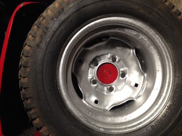

Cadmandu 67 #22 Posted September 15, 2016 You guys are so helpful. That info on tires and rims is great. I just measured my backset on the new white purchased ones it is 2 1/2" and the ones that are on my toy they are the silver ones are measuring 2" so they are probably not WH rims either. The tires on the silver ones is 22 x 9.00 x 12 and i only have 1 1/16" on the right side between the tank support and the tire. So If i put 10.5 on which i would like to do I would be 5/16" away and with rubber chains it would be making sparks. So I need to buy WH rims and new all trails. what a nice forum this is 2 Share this post Link to post Share on other sites
