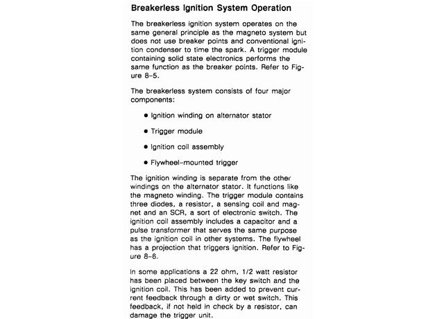

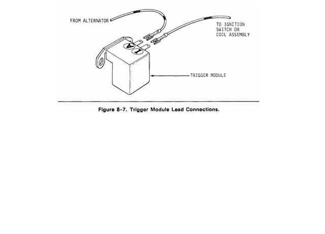

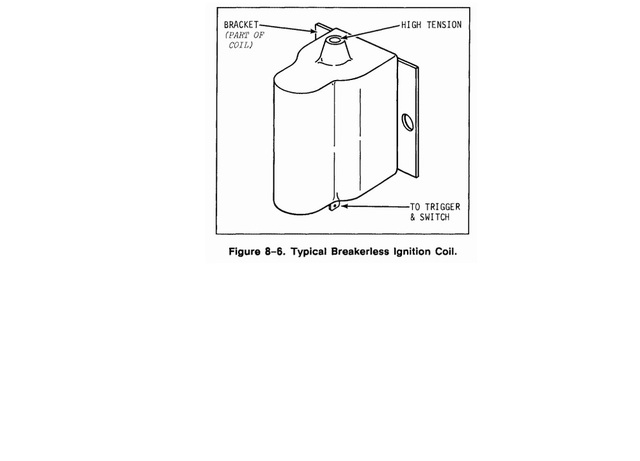

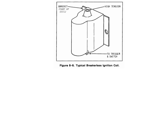

gwest_ca-(File Mod) 12,142 #4 Posted September 9, 2016 Fom the Kohler service manual. The 22 ohm 1/2 watt resistor sounds like a good idea. Would not be so confusing if the "to ignition switch or coil assembly" in the last picture read to ignition switch and/or coil assembly Garry 2 Share this post Link to post Share on other sites
illinilefttackle 399 #5 Posted September 9, 2016 (edited) Great work - I agree on the wording. I have a black wire coming along the frame from the ignition switch under the engine and coming out by the fuel pump. I tested it with a continuity checker- it goes to ground when switch is off, but open all other positions, just like a Magneto system has or the shut off wire to a Briggs Magnetron Coil. I'm assuming this goes to the blade connector on the coil-BUT- does the "I" wire from the trigger module go there also? I will have to think about that for a bit- let me know your opinion please- I;m going to see if I can find a 22 ohm resistor in the circuit somewhere. Thanks for your time- Al Edited September 9, 2016 by illinilefttackle Share this post Link to post Share on other sites
oldredrider 2,553 #6 Posted September 9, 2016 As noted on the drawing, the switch wire and trigger wire connect to the bottom post on the coil. 2 Share this post Link to post Share on other sites
