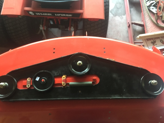

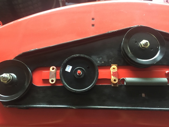

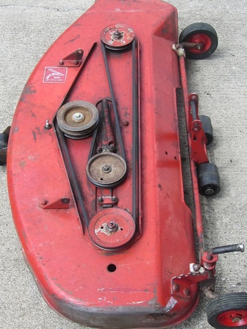

Aldon 4,832 #1 Posted September 2, 2016 Gents, i thought my New Old stock deck shell was duplicate of the one I pulled apart. Now that hat I am starting to re-assemble I'm in a bit of a bind as there are differences. Can anyone provide me of a top view pic with the pulleys viewable and belt cover off? the idler set up is a bit different as the style I have slides and the newer style pivots. I'll have to drill holes in the deck for my hardware to work and I want image to use as a reference so I don't drill holes unnesessarily. here is the top of mine. You may notice I have upgraded to newer style spindles. The slider parts are just places and not installed currently. Share this post Link to post Share on other sites

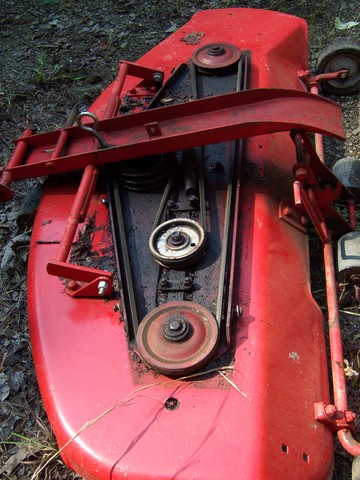

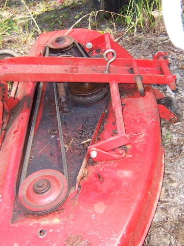

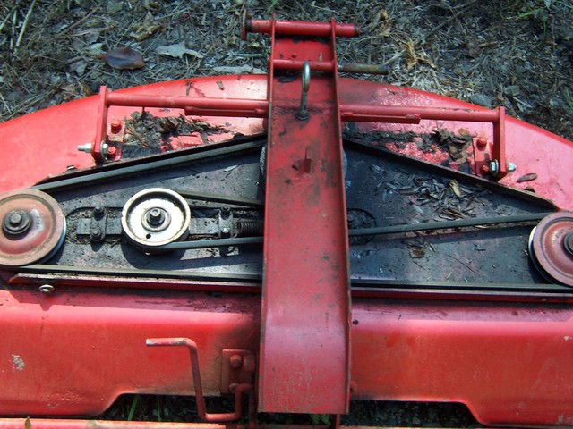

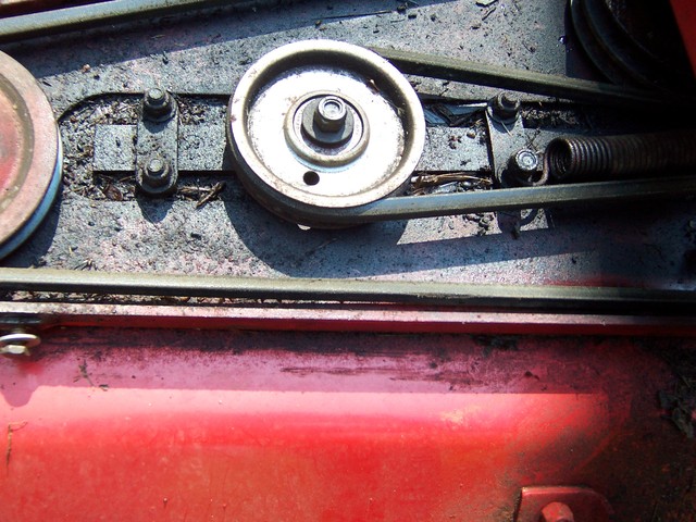

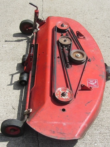

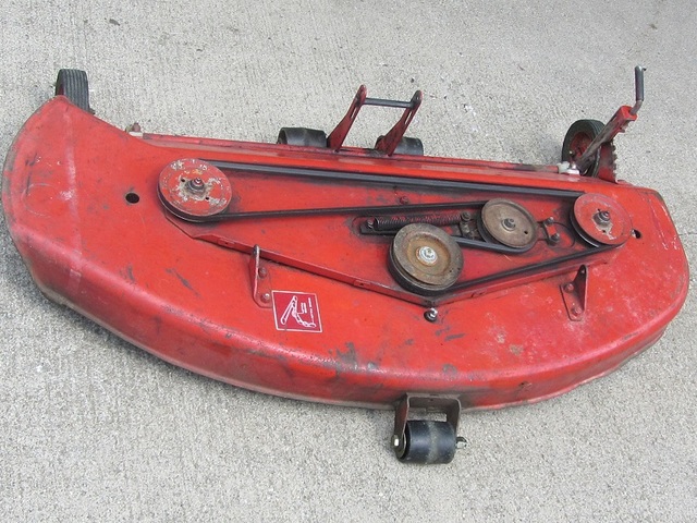

953 nut 68,540 #2 Posted September 3, 2016 Not sure what pictures you want, but here are a few I took. Hope this helps. 1 Share this post Link to post Share on other sites
Aldon 4,832 #3 Posted September 3, 2016 1 hour ago, 953 nut said: Not sure what pictures you want, but here are a few I took. Hope this helps. Thanks Rich. It does help. I should be able to get the deck wrapped up in next couple weeks. l think I will need the Hanger rear brackets for the newer Attachamatic rig. The ones I have are off a 42 inch deck and are not angled properly. Otherwise with these pics I should be able to get it to 95percent 1 Share this post Link to post Share on other sites

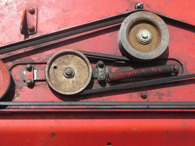

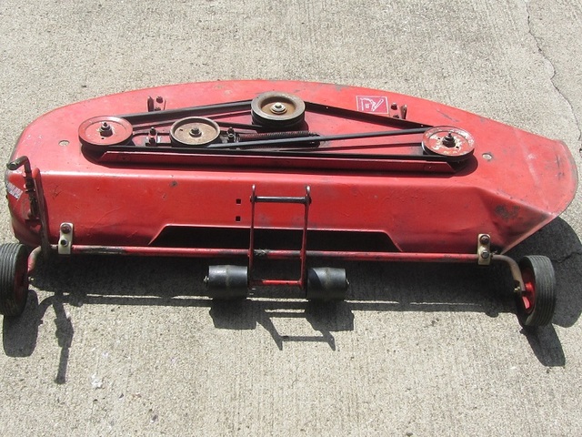

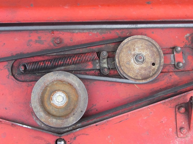

ztnoo 2,302 #4 Posted September 7, 2016 (edited) Aldon, I had the deck off my GT 14 this morning to clean the shell out (scrape, scrape), hose the sucker out, grease the spindles well, and replace the blades. Even though with the mini drought we had here for a couple of months this summer minimized mowing, it was time to change blades as the old ones were dull, and the grass is growing here now like it typically does in May and June, after some abundant rain at the end of August and the beginning of September. The routine is couple of times every week right now. It was a pretty exhausting job given the weather conditions here today: 90°F, 97°F heat index. Uuggghh! Came in dripping wet and soaked clear through. Just your kind of weather, Mr. T! Anyway, I remembered this thread, so I snapped some pics por vous. I have larger resolutions of everything, if you need or want more detail, which I could send you privately. You may already have everything figured out, just thought I'd added a little to the knowledge base for visual reference. btw, can anyone tell me what the two square holes are on the rear of the deck, slightly left of center, next to the roller wheel assembly/carriage? (see No. 4, 5, & 6 pics) Edited September 7, 2016 by ztnoo 1 Share this post Link to post Share on other sites
Aldon 4,832 #5 Posted September 7, 2016 Thanks Steve. I picked up a spare 48 inch deck that ill rendezvous with in October at Stevebo's meet and greet. So I have put this project on back burner as I believe it will have the pivot idler arm as opposed to the slider you have pictured and also @953 nut. For any reading this thread...anyone have experience with both styles? Are they equally robust or are either desirable over the other? Asking now now that it appears I will have luxury or choice. Share this post Link to post Share on other sites
ztnoo 2,302 #6 Posted September 7, 2016 11 minutes ago, Aldon said: the pivot idler arm Mr. T, this kid doesn't have a clue to your reference.............ya gotta remember I've only have 1 tractor and 1 mower deck for 35 years........ Any pics of this variation? Still wondering about the square holes in the back of my deck........... Share this post Link to post Share on other sites
