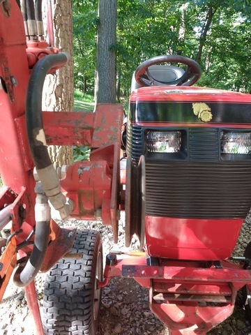

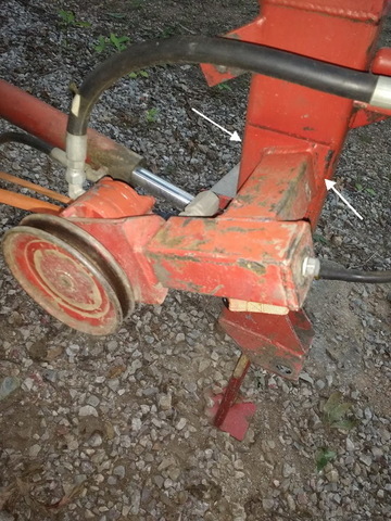

I knew when I bought this loader at the WHCC show that I might have an issue. Today was the first time since I acquired it that I had the time and good weather to start working on it.

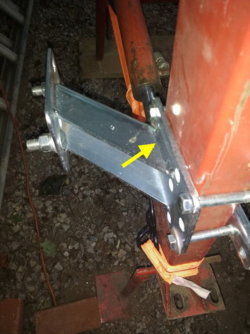

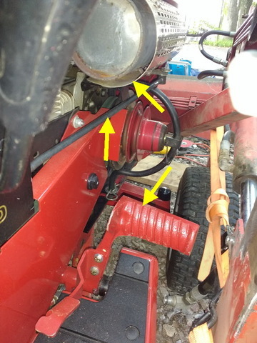

Here is the issue. The tractor is a 1996 416-H. The loader turns out to be a 1971 ARK 508-QM with self-contained pump. The hood on the 416 is wider (16") than the 1971 through 1979 models (12-1/2"), plus the side mounted muffler on the Onan conflicts even more.
The closeup is a little out of perspective, but you get the gist of what my problem is.
So, short of removing the right side upright from the loader and seeing if it will fit without conflicting with the muffler and the "Matt Foot Controls", I am stuck figuring how to install it, and if it will even fit. If I had a hoist, I guess I could lower it onto the tractor so the pump is past the muffler.
Has anyone here done this on their 300/400/520 series horse?

Bob, is there any way you can take the pump off? Would that give you enough clearance?
rmaynard
The pump can be removed, but the welded on bracket would remain. I would only gain about 1", the thickness of the pulley.

The muffler and guard would still stick out.
I'm considering cutting the pump bracket off completely, fashioning a plate that can be bolted back on to the upright after the loader is installed.

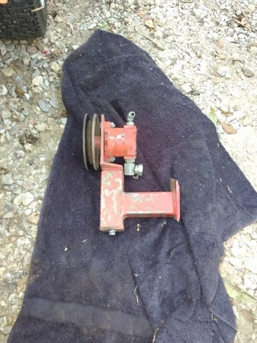

rmaynard

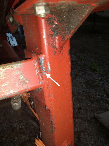

I'm thinking about cutting it off here at the weld with a sawzall.
Then take this spare tire bracket and cut the angled steel off and have someone weld the pump bracket on. This way I can position the pump wherever it needs to be to avoid conflicting with other stuff.
Just a thought.

My :twocents-02cents: , use 4" angel grinder with new wheel . Then chisel and hammer . It's just from past experience . I just foresee to much :angry-cussingblack: when blades start bending and catching .
  • Like 5

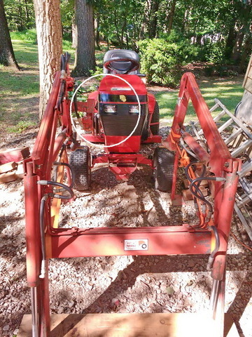

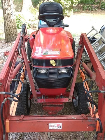

You know the old saying, "The best-laid plans of mice and men often go awry" well here is a classic case.

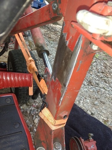

Okay. Wore eye protection, and cut the pump off.
And with that done, the loader went on with no room to spare.
However, the pump cannot be mounted to the upright again without conflict with the foot pedal, muffler, or PTO shaft.
Looks like I am back to square one and will have to find somewhere else to mount the pump.

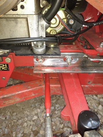

So, here is my conclusion. After spending the entire day trying to figure something out, I have concluded that it won't happen.
First of all, as constructed, the pump and pulley interferes with the muffler, motion control pedal, and PTO lever.
I removed the pump, cut the mounting bracket off, and tried various different mounting scenarios. None work. If mounted in front of the engine, the pump either conflicts with the muffler, angled support strut, hood or right front tire.
And to top it all off, the hood only opens about half way. The bottom, near the hinge, hits the front mounting bracket.

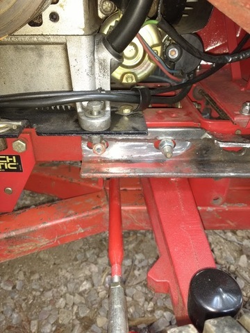

First off --my skills are absolutely no where near the same league as buckrancher is in and very surprised those names are in the same sentence!

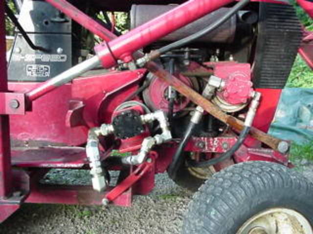

It's gotta be able to fit in there some where, I have two pumps mounted on a 416 but yours is a little different.
Can you take some more pics of that area in front of the engine but backed out out a little bit so we can see the entire area?
Wondering about some modification to the support arm to make a little room. Can that pump can be used bi-directional? (if it has any IN and OUT or flow direction indicators it can't)  The new type can but not to sure about that one.
