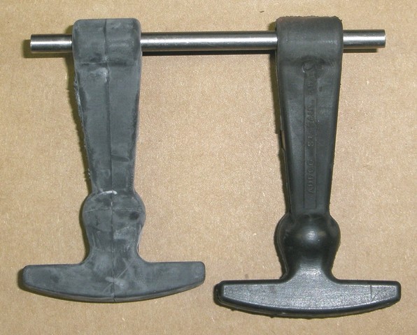

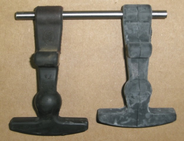

doc724 927 #18 Posted September 17, 2016 I remembered this thread and today when I was poking around my 416H, I noticed a mfg name on the rubber hood latches. Back in 1996 they were made by Addco of St. Paul, MN. Addco was taken over by Actusiinc (which was identified earlier by MalMac). While you can buy on their site, there are no pictures and they spec the rubber latches by length, the smallest being 3 inches. I just measured the overall length on the latches I removed from my C125 (undergoing a resto) and they are 2-7/8. Just because Addco made them in 1996 is no guarantee that they were the supplier back in the early 80's. However, having worked my entire career in a large manufacturing company, the only time we changed suppliers was if they went out of business, jacked up the price, or their quality went down the tubes. Also, St, Paul is pretty close to South Bend and back in those days, you selected suppliers close to you-none of this global sourcing crap was going on back then. I would be interested in hearing an update from jdleach on his success or not. 3 Share this post Link to post Share on other sites
jdleach 525 #19 Posted September 18, 2016 Don, and everyone else, sorry for not following up sooner. The life-thing got in the way. Sent an email to Actusinc some time ago, and got a reply several days later from one of their reps. Quite cordial and helpful, the rep sent a .pdf print of the dimensions, and it appears to be the elusive animal we seek. The proof is in the pudding, so I still need to order one to compare with an original. If I can get to it, I will put in an order for two today. When they come in, will report on how they stack up. The ones I mentioned in an earlier post, with the stainless steel hardware, came in a couple weeks ago, and I am happy to announce that the quality looks good. Unfortunately the length is too short for a one-to-one replacement. If someone were to use these shorter straps, hole placement will have to be shifted a small amount. That of course, will necessitate the filling of at least two holes. Rather a pain. The stainless steel fittings are a definite plus though. 1 Share this post Link to post Share on other sites

lynnmor 8,921 #22 Posted September 22, 2016 On 9/18/2016 at 8:12 PM, doc724 said: Thx for the update JD. I may give sales at Actusinc a call tomorrow and see if they can email a pdf. Price wise, the rubber latches are about $3 (v. $20+ from toro). Shipping is high, but overall if they work cost is still worth the savings. Somewhere, I read where one of the RS Vendors may be selling these. I need to look again-maybe it was just wishful thinking I just received straps from Actus. They are shorter, but then my old straps are stretched a bit. I replaced one and it worked OK, just tighter than before. Share this post Link to post Share on other sites
